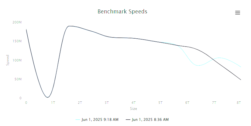

After swapping the cables I am still seeing the same issue.
Additionally I ran a DiskSpeed test before an after the swap and the results are similar (attached). There is a catastrophic drop in speed around the 750GB mark on both the old and new cable.
I assume based on these results I should be replacing the drive ASAP?
I probably should not resume the scheduled parity check until after the swap as well?
Yep
