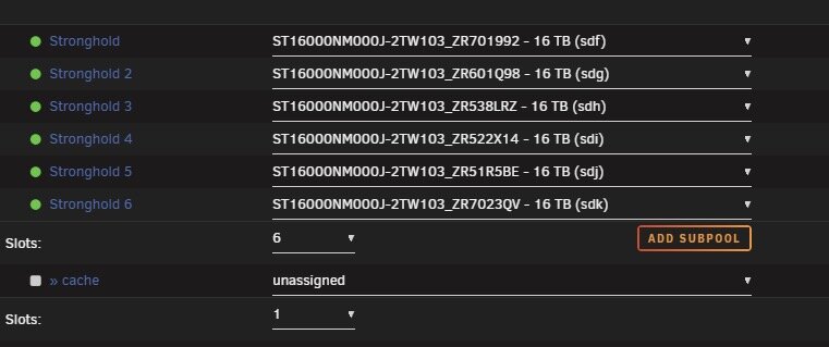

zpool import even showed me all 4 cache drives. I then set the slot to 0, and then I was able to start the array and the mounting was successful.

I recreated the pool without the L2ARC subpool, I started the array but the mounting wouldn't finish.

I waited about an hour, so I had to reboot the server because I don't know of any way to stop the array while its "starting".
After rebooting, I was shown the cache with one slot and no drive assigned in the GUI, which is what the screenshot in my last post shows.

First, I tried setting the slot count to 4, assigning my cache drives, and starting the array, but I got this error:
Wrong Pool State: cache - invalid config.
So I unassigned the cache drives and set the slot count to 0.
I started the array and it was mounted successfully.
