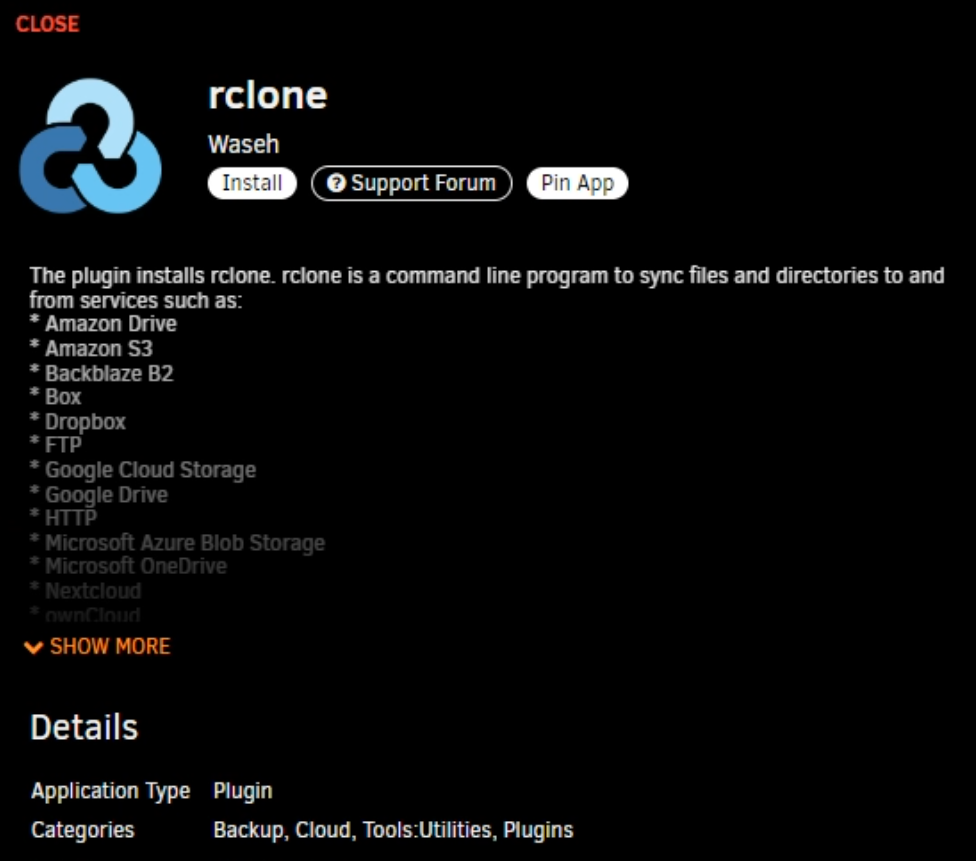

Quite a few plugin and tools.

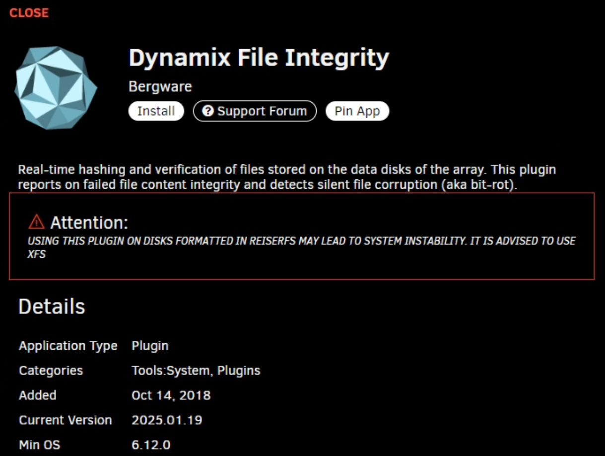

The main one I would recommend to have installed when moving between disk is:

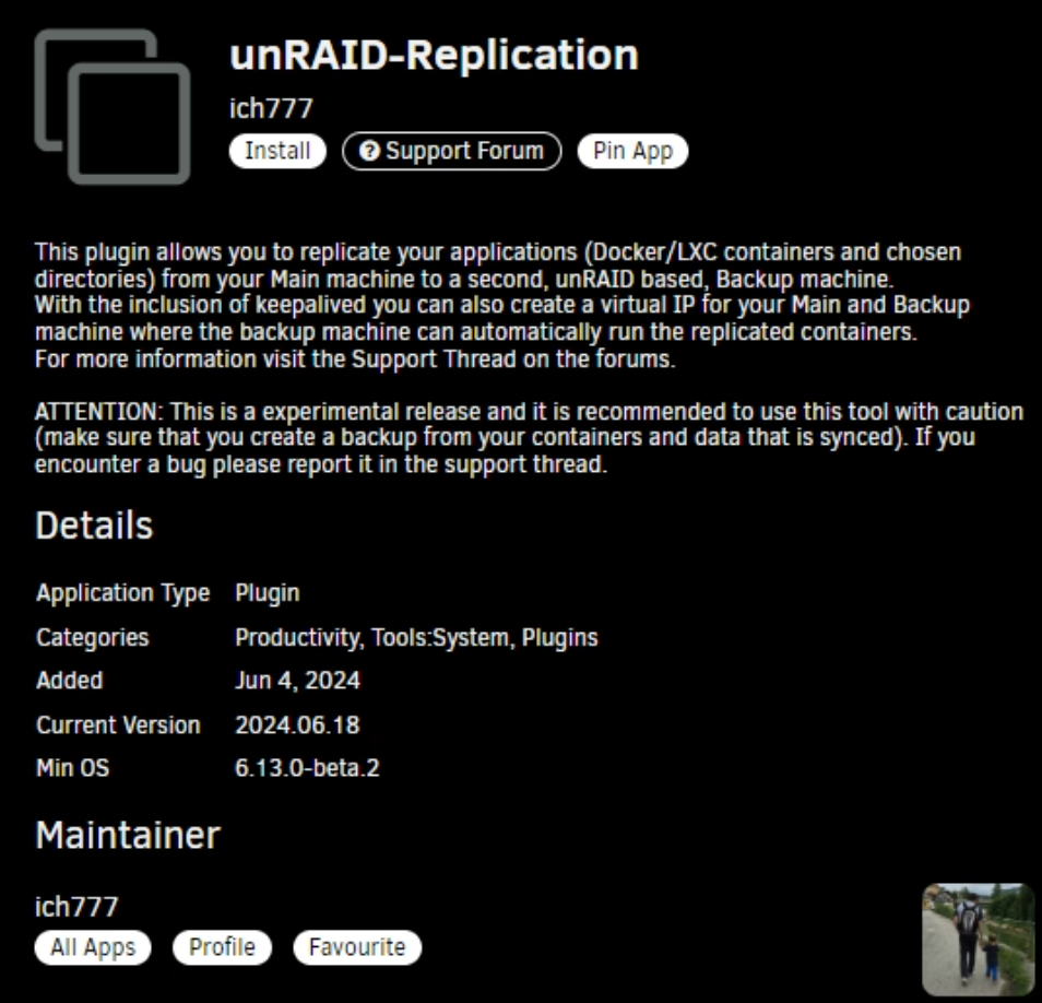

ah, there are a few plugins that can help with this actual. If both are running unraid ICH777 made a unraid duplicator pluging. (Depending on data / file on disk)

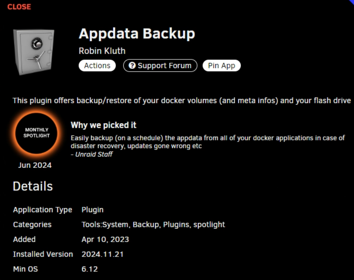

*More Docker and unraid system backup restore.

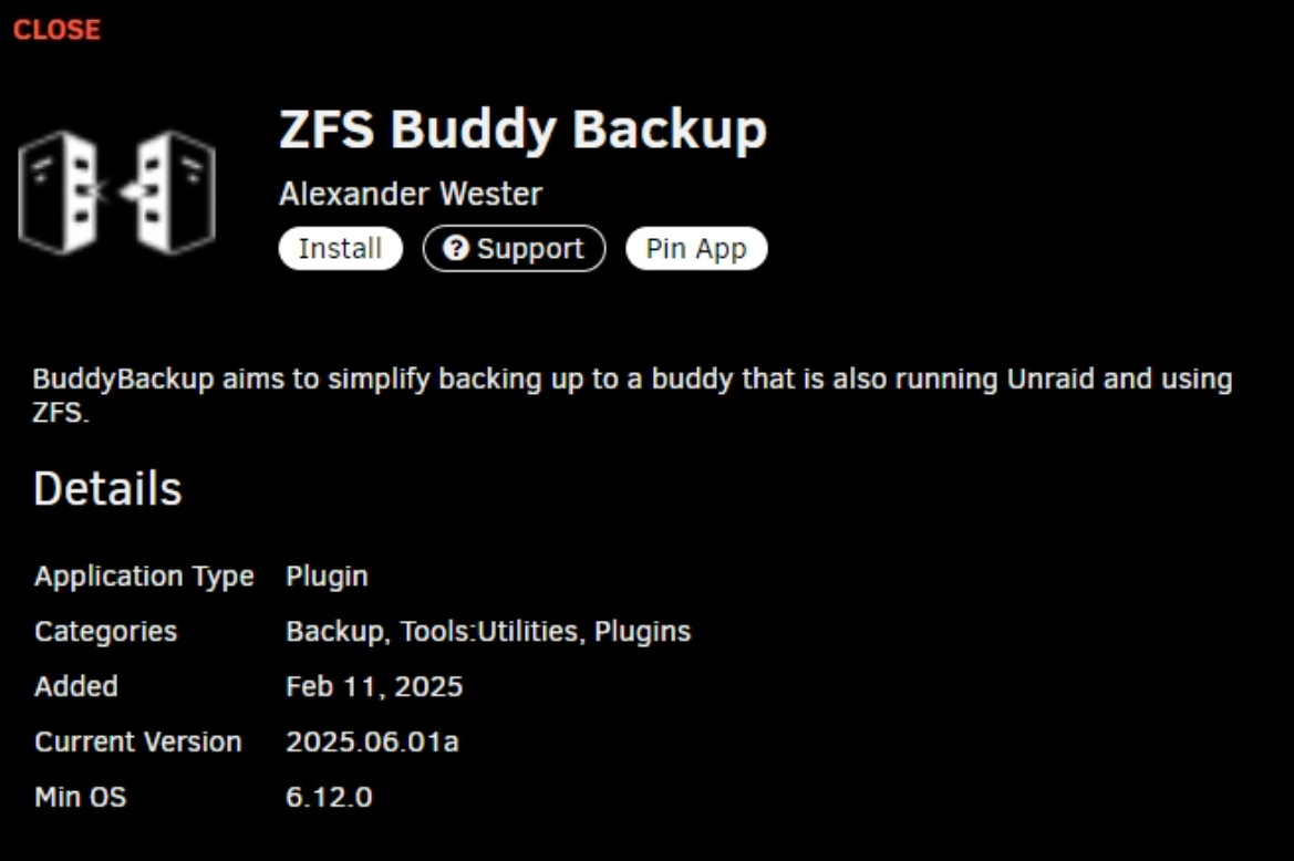

If using zfs / zfs pools with encryption.
One could use zfs send to transfer disk data.

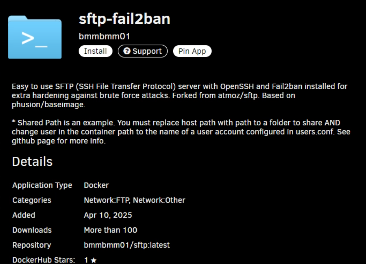

If it helps I alos have a sftp/fail2ban docker that can be used in conjuntcion with the rclone (rsync web application)
comes down to how you want to interact with it and what you want it to do.
