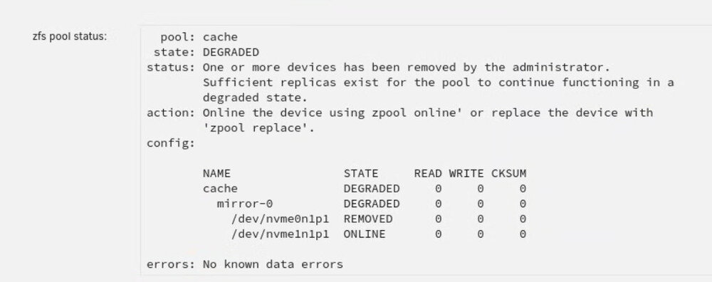

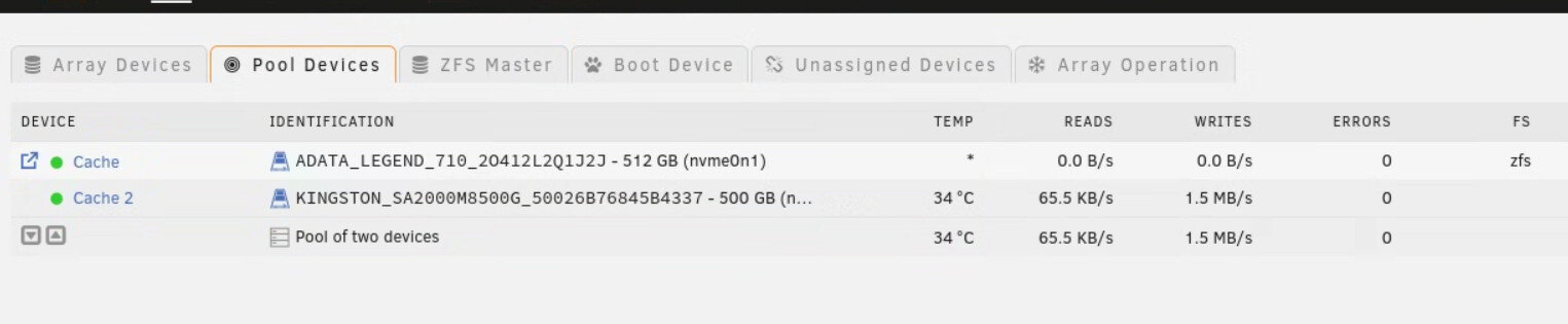

On my system I have 2 x 512 GB nvme sticks acting as pool devices. The filesystem is ZFS.

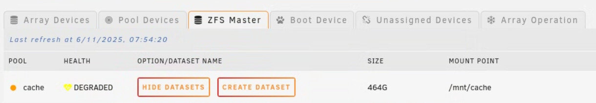

I noticed that one of the 2 nvme sticks is doing nothing. The ZFS master plugin shows that the cache health is "degraded" without any additional information.
Do you have any idea of what is going on here and how to fix it?

Ok more info:
Can I simply issue the command "zpool online" to fix this?
I tried to online the second nvme and then clear errors but it did not help...
Ok after a cold reboot things are back to normal. Not sure what happened here. I have set the "spin down" to never on that nvme to see if it prevents it from disappearing..

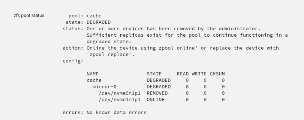

NVMe device dropped offline:
May 23 13:19:14 Nas3 kernel: nvme nvme0: controller is down; will reset: CSTS=0xffffffff, PCI_STATUS=0x10
May 23 13:19:14 Nas3 kernel: nvme nvme0: Does your device have a faulty power saving mode enabled?
May 23 13:19:14 Nas3 kernel: nvme nvme0: Try "nvme_core.default_ps_max_latency_us=0 pcie_aspm=off pcie_port_pm=off" and report a bug
May 23 13:19:14 Nas3 kernel: nvme 0000:01:00.0: enabling device (0000 -> 0002)
May 23 13:19:14 Nas3 kernel: nvme nvme0: Disabling device after reset failure: -19
Try adding those options to syslinux.cfg, also you should scrub the pool now.
