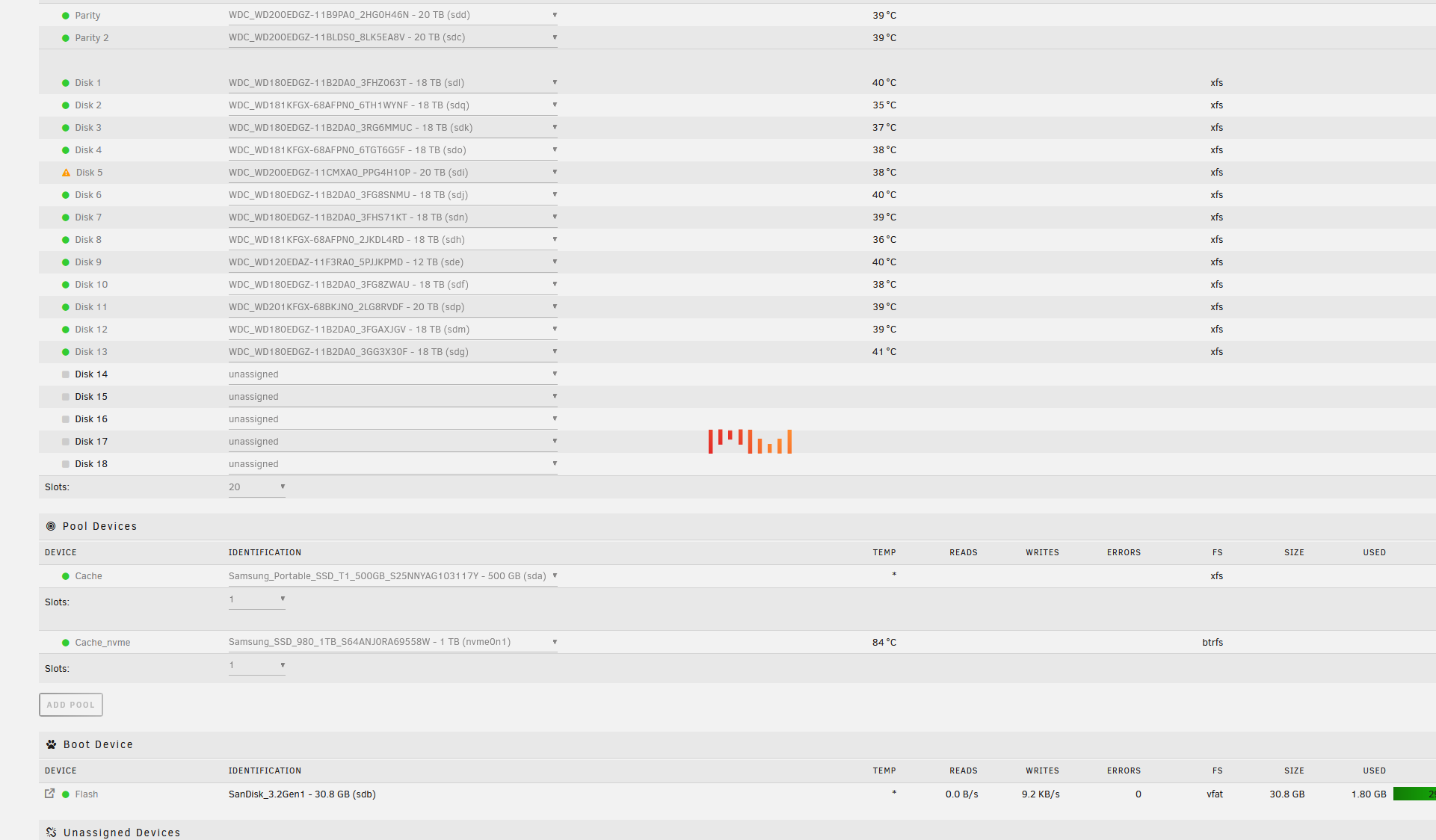

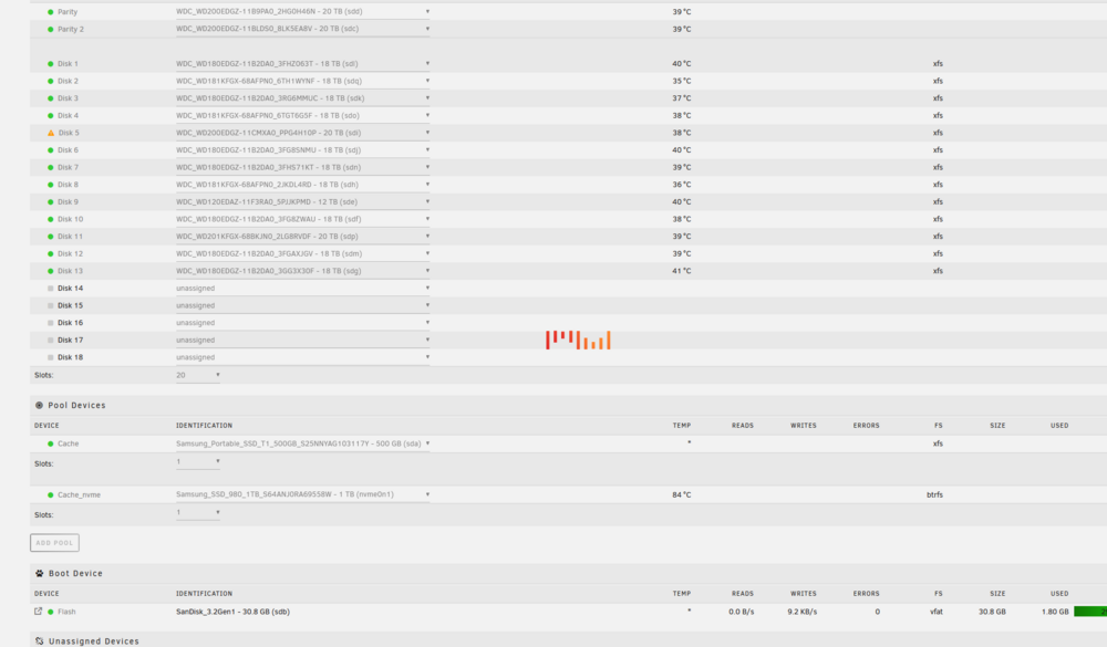

Turned everything back on and now it takes forever to get the array to start if it will start at all. Just get the wavy orange lines. I decided to power off via the PSU. Rechecked the cables and connections. All good. Restarted, got everything up, started a preclear that looked good so I stopped it to see what would happen. Back to the array starting just as in the screen capture. I can't get diagnostics to download while it's doing this but I've attached the diagnostics I ran right before I had the array starting freeze. I've a BAAAAAAD feeling my mobo sata controller is going bad on a channel. Looking for input from the crowd.

tower-diagnostics-20250611-2032.ziptower-diagnostics-20250611-2032.zipScreenshot 2025-06-11 212456.png
