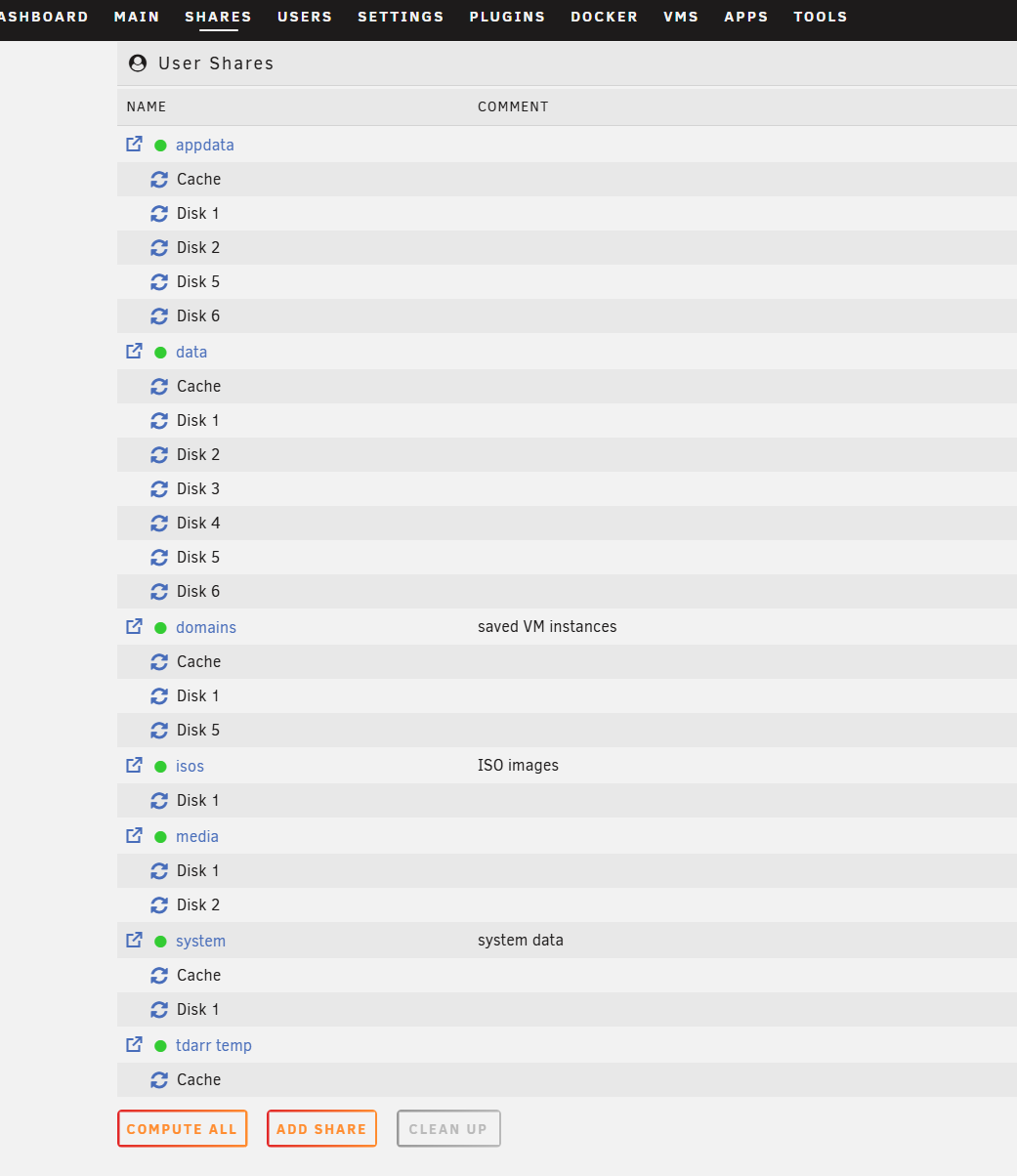

Can you post a few screenshots. One of your Sonarr Docker Template and the "SHARE" tab after clicking on Compute All

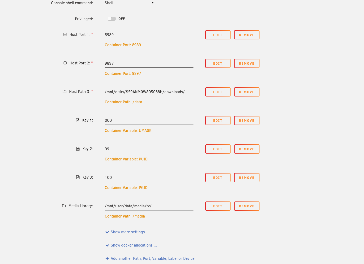

You have a "data" share as well as a "media" share. You have sonarr pointed to /mnt/user/data/media/tv which does not include /mnt/user/media
At any point have to changed these?
also your /data path for sonarr is using what I assume is an unassigned device.
you've got some stuff to look into on your own server. might explain the "missing" files which might just be in the wrong share.

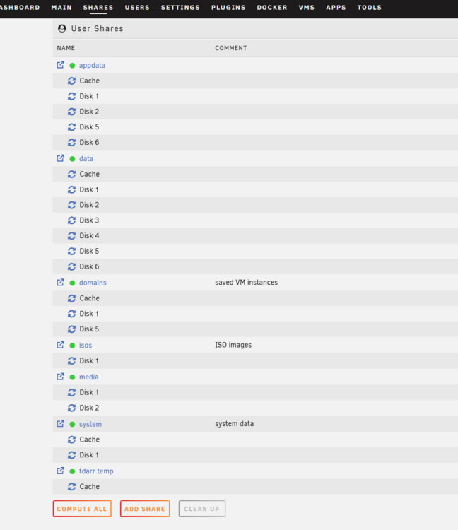

Have you actually verified if the files are actually missing(being deleted) from the server? Or are they just ending up in a different share/folder outside of what sonarr/radarr can see? You have duplicate shares on your server is it possible that some of those files are in that media share and the others in the data share?
