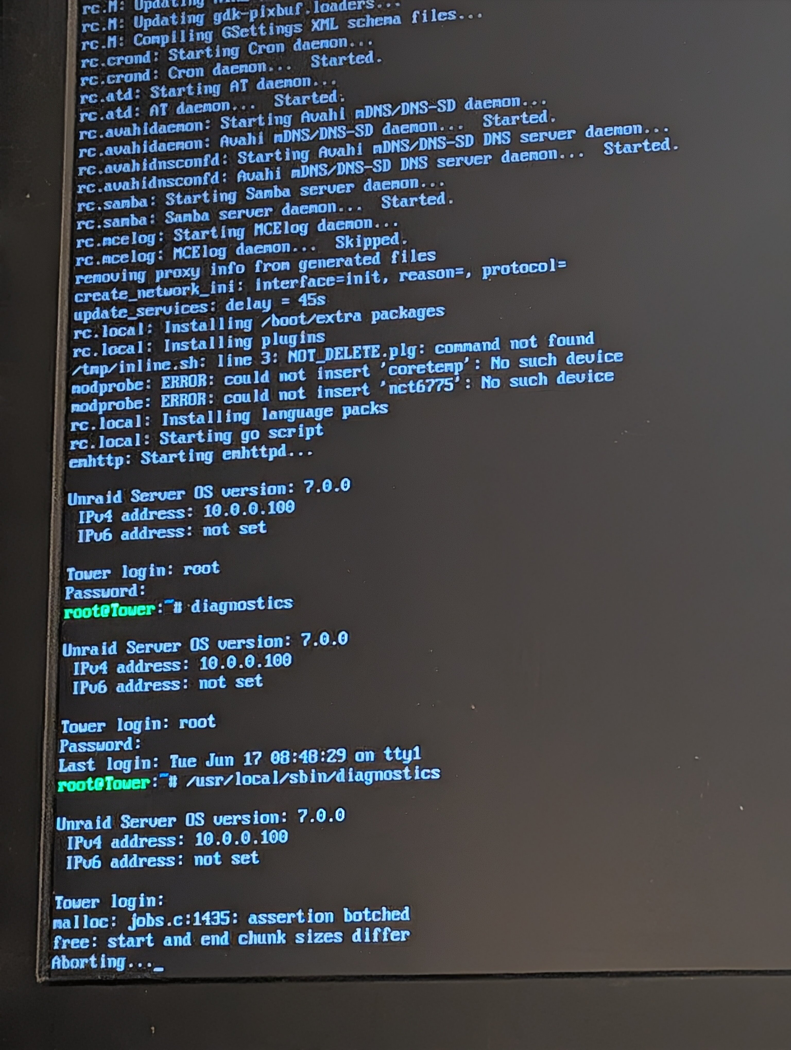

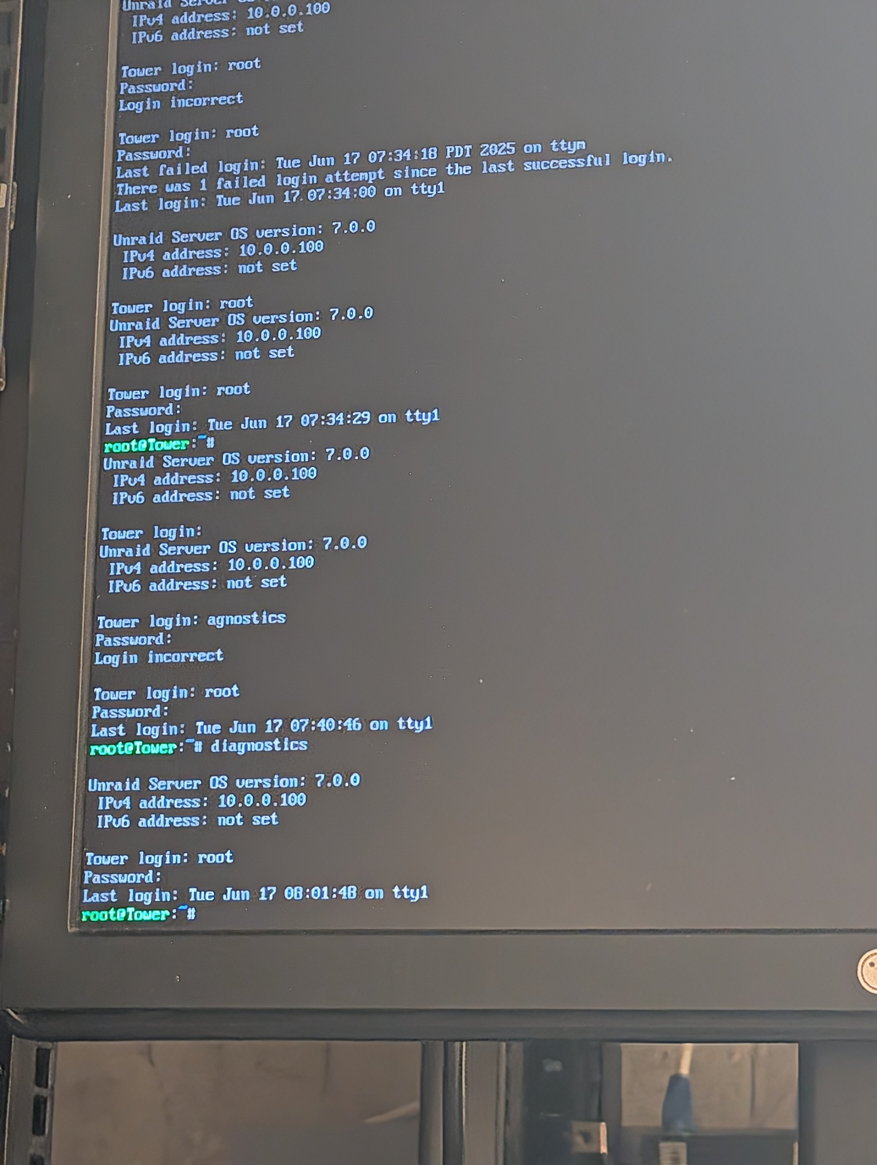

  • Server boots up into the command line but seems to be stuck in a login loop, when I try to run any commands such as "diagnostics" it just asks me to login again
  • Tried to boot into the GUI but it's just a black screen.

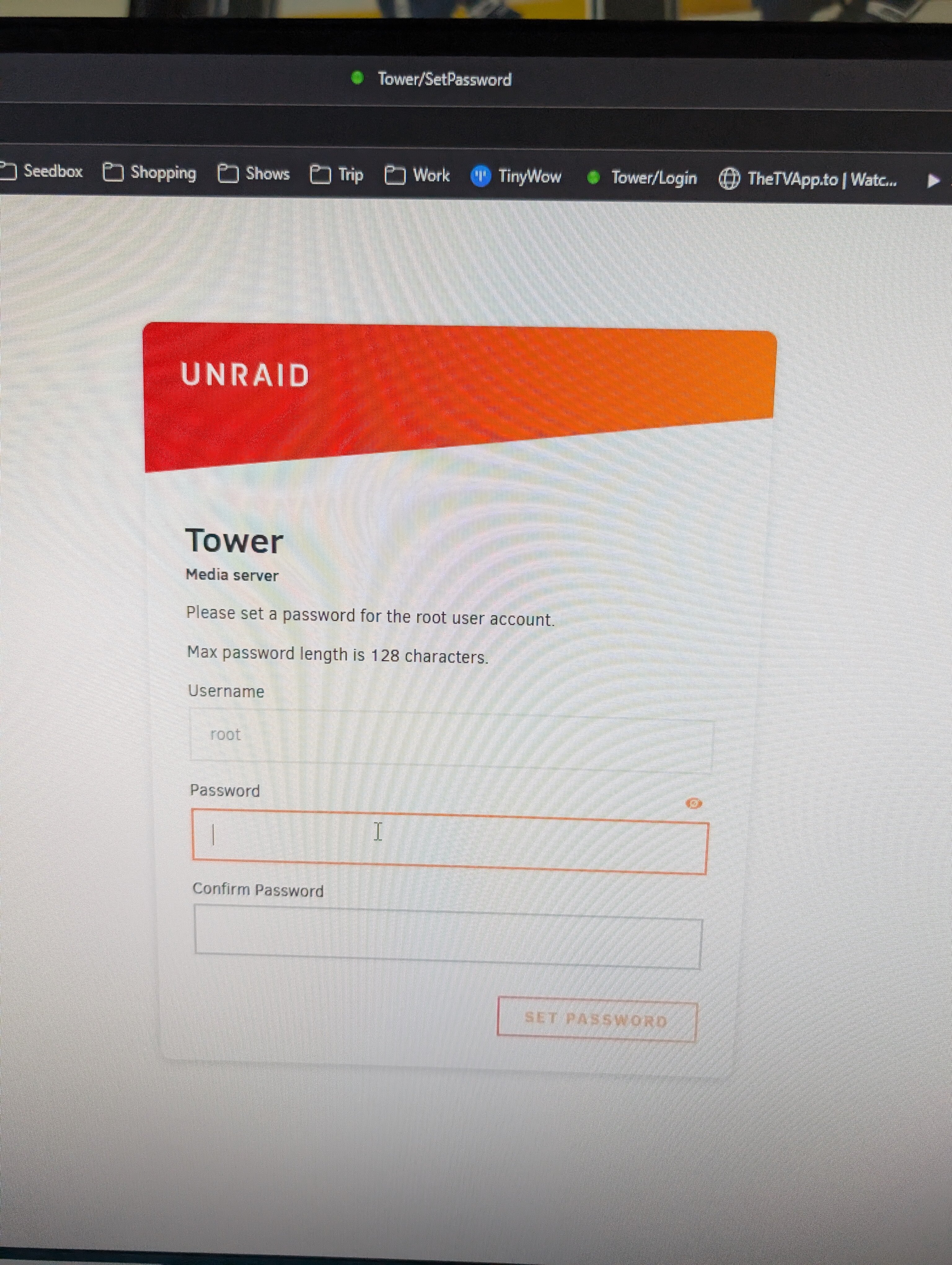

  • When I try to reach the server from another computer to view the web GUI it asks me to create a new password. When I type in the password and click "set password" the webpage hangs.

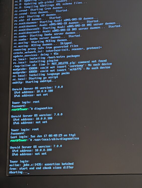

  • Got into the command line and saw this error
    • malloc: jobs.c:1435: assertion botched
      free: start and end chunk sizes differ
      Aborting...
  • It was hung on aborting for about 5 minutes, I CTRL+C and was able to get back to the login line, logged in a few times and was eventually able to run "powerdown" in command line.
