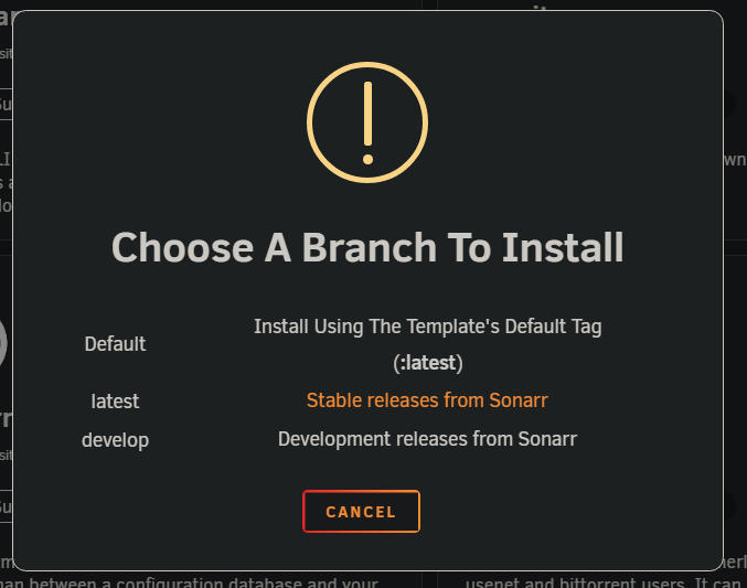

When I go to install docker it says to choose branch. I select latest
Then it starts thinking then takes me to this screen.
cant install anything due to this. my appdata share is still there with the dockers I had installed last night. Docker share shows data in it. When I do click that drop down from the last screen shot there is nothing there.

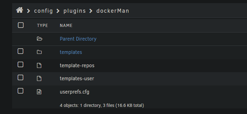

The docker templates needed to work with your existing dockers should be on the flash drive in config/plugins/dockerMan/templates-user.
Do you have those?
2 minutes ago, trurl said:
Do you have those?
the templates folder is empty and there is a templates-user file
I don't understand. There shouldn't be a folder named "templates". There should be a folder named "templates-user" in config/plugins/dockerMan
So removed the templates-user file and renamed the folder to templates-user. It now starts downloading and installing the docker but get this below.

Ok got it fixed. I deleted the templates-user file renamed the templates folder to templates-user. Then deleted everything in the docker folder and now dockers are installing again. And everything I set up last night is still there so not having to reset everything in the dockers.
