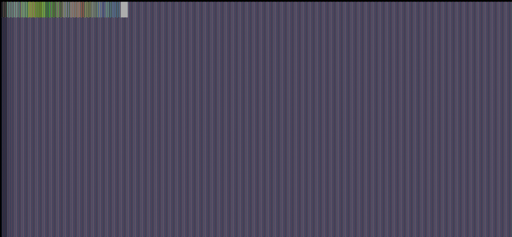

So this past weekend I was advised by a friend that my Overseerrr was not working. I logged into the server and restarted the container and issue resolved. A while later, I was informed again that it was not working. This time, I was not able to log into the server or any container. Without thinking, I hit the reset button on the case to reboot the server and everything was fine after that. The next day, it failed again and I rebooted the system again which is when I noticed that the docker service failed to start and the cache pool had the error Unmountable: wrong file system. I tried finding a resolution to this on but have not been able to. I cannot use the terminal as the display is distorted and I cannot see anything. Nothing on the server has been installed or modified recently so I am unsure what could have caused it other than hardware failure or random software glitch.

This is what the terminal looks like.

For the terminal issue, try using a different browser, then type btrfs rescue zero-log /dev/sde1 restart the array and post new diags.
Thanks for the response. Terminal worked on Edge and the command brought back the docker. However, I have limited time before the server simply stops responding and I have to reboot the system again. It occurred to me to try to backup the docker image and when I made my way to the directory, I noticed the image file size was 32gb and my settings are set to 30gb. Thinking this might be the issue, I raised the limit to 50gb. I went back to the docker image file and noticed it immediately jumped to 53gb.
