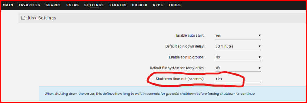

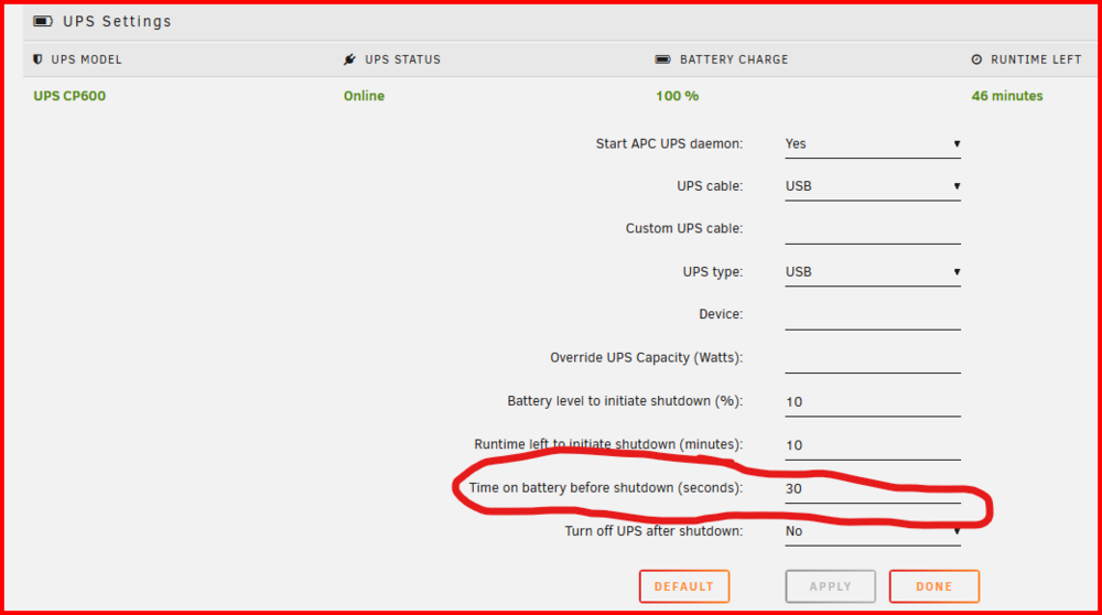

These are my settings:
The circled one is the one that actually does the shutdown. (I have determined that if a power outage last thirty seconds, it will be hours before power is restored.) I have nothing else connected to my server UPS so this provides battery reserves if after power restoration, there is a second outage, there will be enough battery to make a second clean shutdown!
One more setting. Determine the time required to stop the array and set this variable to make sure that the array is stopped before a force shutdown is force by this timer. Sometimes, a Docker container will refuse to release a file lock and the array can not be stopped. If you find one of these you will have to figure out a way to deal with it.

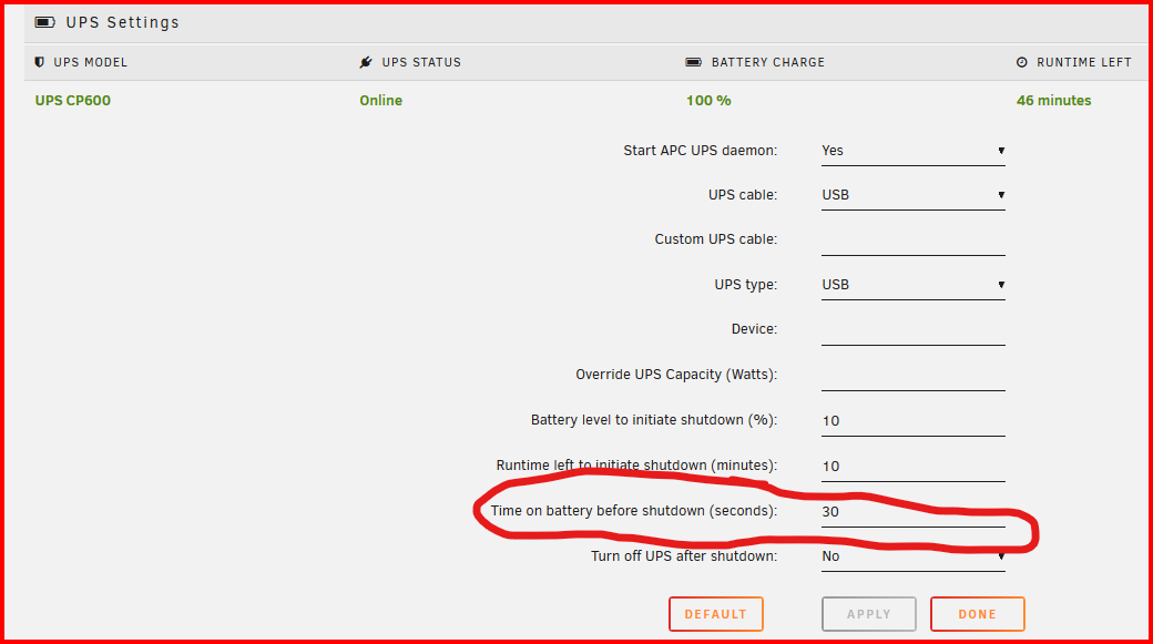

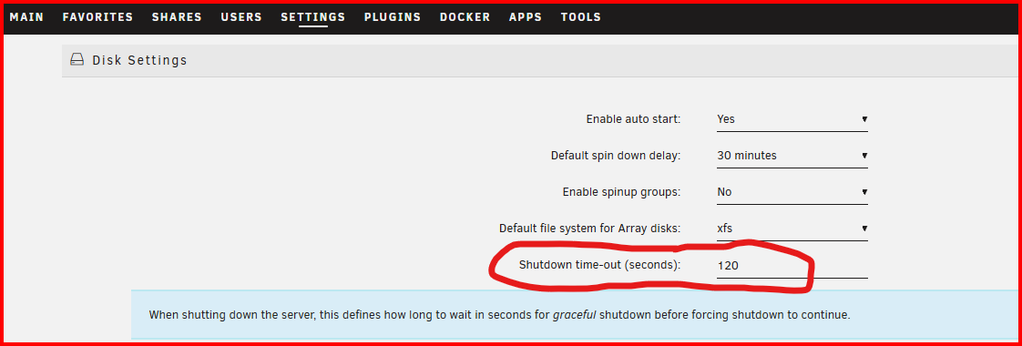

Because the UPS communicates with the Unraid UPS software! That is how it 'knows' how much battery remains as well as the nominal power being used by the load connected to the UPS. So the mains power is interrupted, it sends notification to the UPS software that the shutdown timer can start. If the timer elapses without a signal from the UPS that the power is restored, the shutdown sequence will begin!
If your UPS will not communicate properly with the default UPS software in Unraid, you can install the NUT plugin which has support for more UPS's.
You connect your UPS with a USB cable to your server. Then go to the UPS setting and turn on 'Help' by clicking on this icon image.png on the Toolbar of the GUI.
