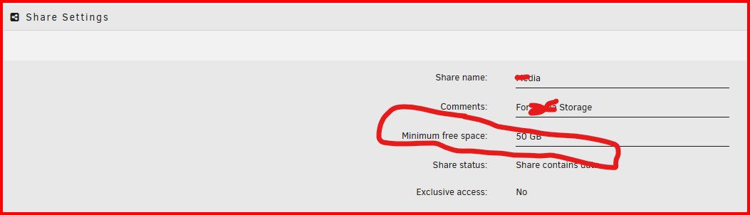

Share floor is set to 780GB, which is over the free space available on the current disks, adjust that.
Here:
Many thanks both, that solved my issue. I know you both responded around the same time so apologies I can only mark one as solution.
Out of curiosity is there an optimum value for this setting?
Regards
It should be larger than any file you expect to write to the share. How much is up to you. I have mine set to 50GB because that is the max size of a Blu-ray disk. An argument could be made for making it, say, 10%, 20% or 30% larger. Watch out for Image backup files of Windows OS disks. Depending on what is on that OS disk, they can be humongous if that disk contains all the data as well as the OS!
