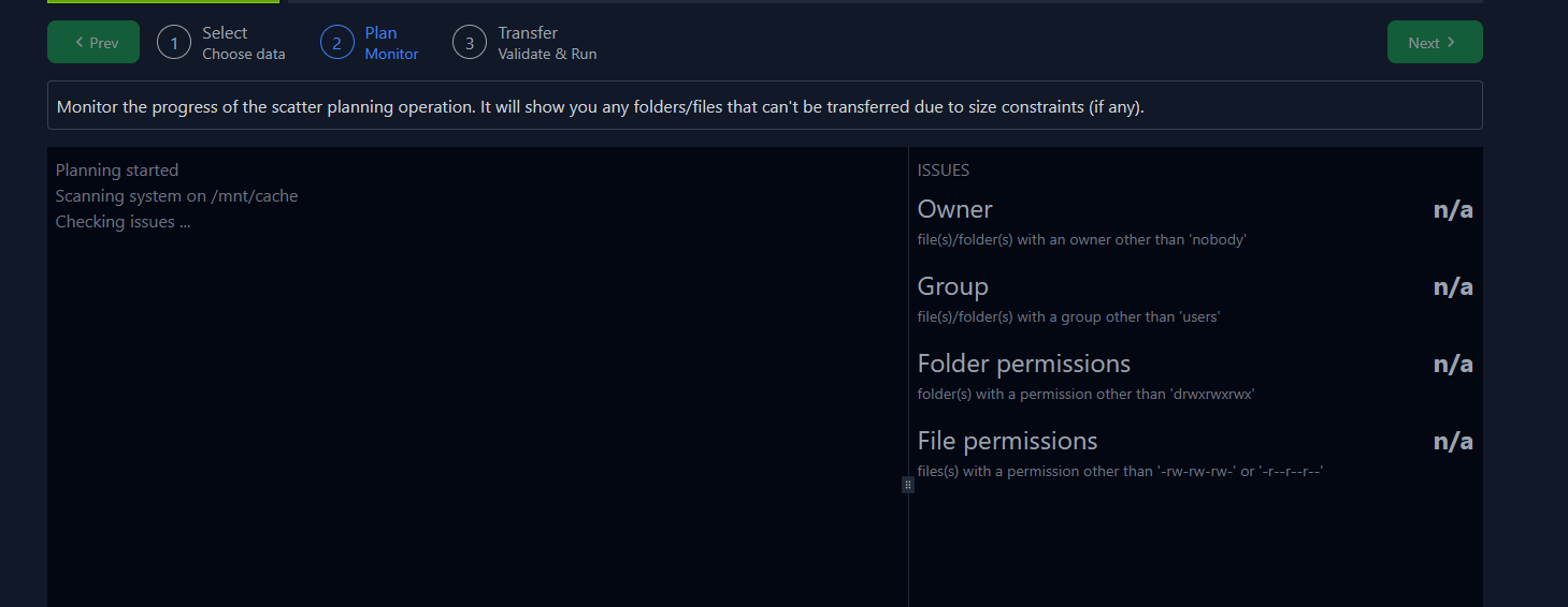

I let the mover run overnight and only 40GB moved. I have another 140GB to move. But now it seems that hours can go by and only a few hundred MB will have moved. I tried to load up "unbalanced" to move it that way. But no luck. It wont get pas this:
Eventually that screen will be blank (the large dark box with "planning started"). I was able to move other data from one place to another, But trying to move data from the Cache to the array. Wont happen. I tried restarting unbalanced.

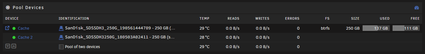

My cache pool is 2 disks (each 250GB) in raid 1. I checked the smart on the main drive. Its reported it was fine.

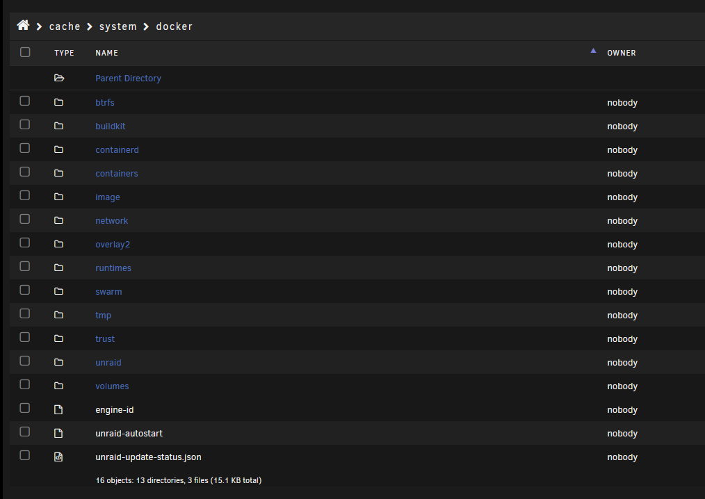

One final note. I have docker setup as a "filesystem" not the image file. This is the section that is taking forever to move. Its the only thing left on the cache. There is nothing above this folder.

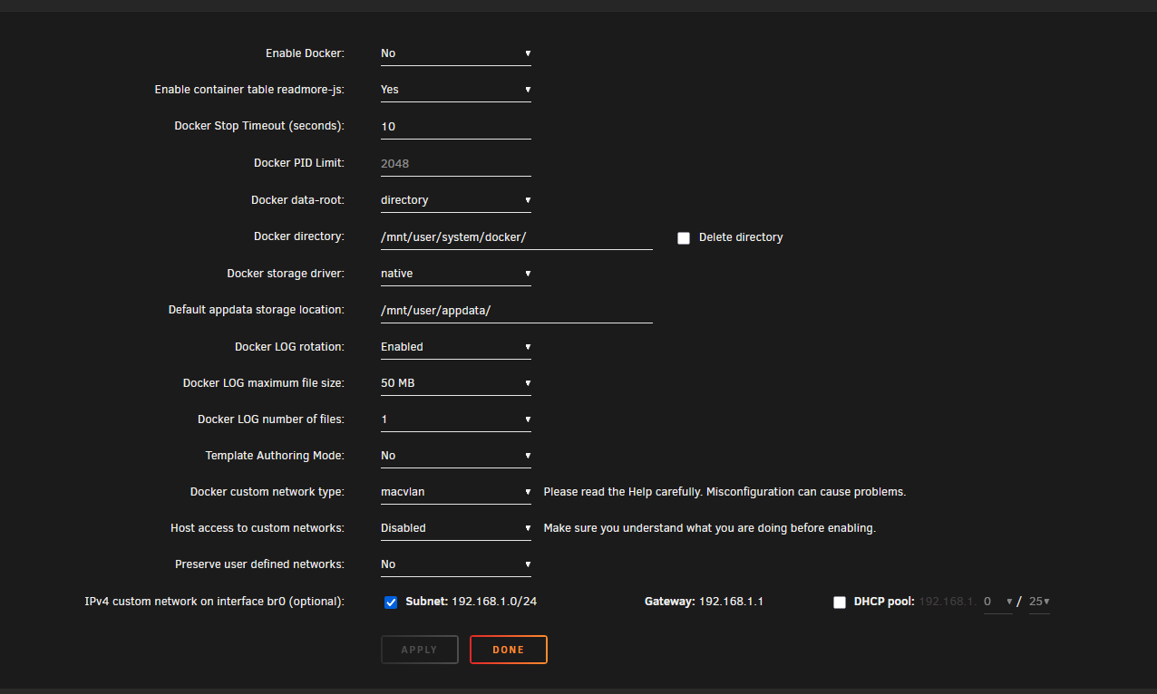

My docker settings:

Added docker information.
