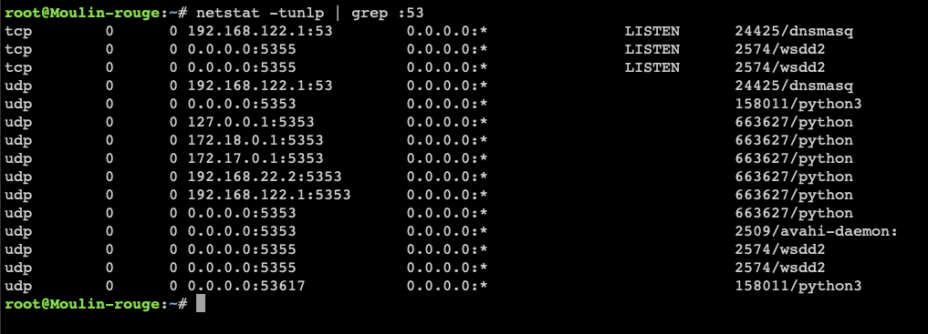

DNS port 53?
Happened to notice unraid is using port 53 for DNS instead of secure DNS like on port 853 etc.
7.1.4
Is there a way to change this?
Screenshot is from me changing to local pfsense router.

I'm so used to having a debain client to test soem of theses most linux coamnds may not be compatiable with slackware unraid without a 3rd party install...
netstat -tunlp | grep :53
  • netstat: A utility for displaying network connections, routing tables, interface statistics, masquerade connections, and multicast memberships.
  • -t: Displays TCP connections.
  • -u: Displays UDP connections.
  • -n: Displays numerical addresses and port numbers instead of trying to determine hostnames and service names (speeds up the output).
  • -l: Lists only listening sockets.
  • -p: Displays the Process ID (PID) and the name of the program that owns the socket.
  • |: Pipes the output of netstat to the next command.
  • grep :53: Filters the output to show only lines containing ":53" (the DNS port number).
Should work on unraid. see if the other 853,784 ports exisit and have listening address.

Its probably all going over the DNS forwarder anyway, but I will add that catch all rule.
Somewhat bizarre its saying its using an IP that doesn't exists the 192.168.122.1:53
should be 192.168.22.1
