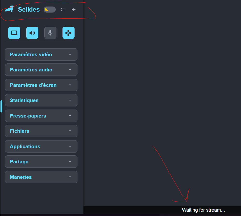

June 28, 20251 yr Hello,I was using a Firefox application, specifically the one from lscr.io/linuxserver/firefox. It was working well until a recent update changed the "renderer" (I'm not sure what it's called) from VNC or KasmVNC to Selkies. However, Selkies isn't rendering anything.All I see is a message that says, "waiting for stream...", but nothing happens, and none of the available options seem to help resolve the issue. As a temporary fix, I installed an alternative Firefox ESR version that still uses the old renderer. However, I'm concerned this issue might affect other containers with web rendering capabilities, so I'd like to find a permanent solution.Do you have any suggestions on how to fix this? Is there an option I should enable or disable, either within the container or in the Docker settings?I'm on 7.1.4 version of Unraid. Edited June 28, 20251 yr by zarkoff

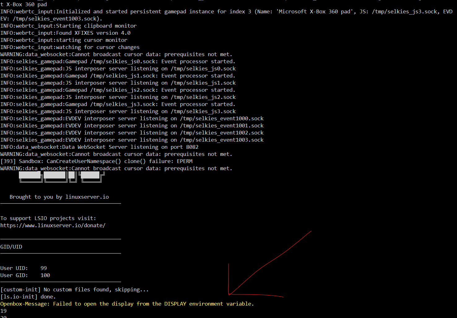

June 29, 20251 yr Author 1 hour ago, Trent said:You have to access firefox over https now. The default port is 3001.Hi, I tried but this is the same with https and 3001: waiting for stream...See the 2th line of log below is warning me about something but I don't know how to fix.Log FirefoxINFO:data_websocket:Initial client settings message processed by ws_handler.WARNING:data_websocket:Initial setup: Video pipeline for 'x264enc' was expected to be started by applyclient_settings but is not. This might indicate an issue or a no-op change.WARNING:webrtc_input:No clipboard content to sendINFO:data_websocket:Received START_VIDEO for encoder: x264encINFO:data_websocket:Starting x264enc: 3386x1256 @ 60.0fps, CRF: 25, FullFrame: TrueINFO:data_websocket:New frame backpressure task started (current encoder: 'x264enc').INFO:data_websocket:x264enc capture started successfully.INFO:data_websocket:Received START_AUDIO command from client for server-to-client audio.INFO:data_websocket:START_AUDIO: Server-to-client audio pipeline already reported as active.INFO:data_websocket:Frame-based backpressure logic task started.INFO:data_websocket:Client settings received, proceeding with backpressure loop.INFO:data_websocket:Cleaning up Data WS handler for ('127.0.0.1', 56436)...INFO:data_websocket:Client ('127.0.0.1', 56436) disconnected, but other clients remain. Frame backpressure task continues.INFO:data_websocket:Client from ('127.0.0.1', 56436) disconnected. Checking responsiveness of remaining 1 client(s)...INFO:data_websocket: Remaining client ('127.0.0.1', 46538) is responsive.INFO:data_websocket:Client from ('127.0.0.1', 56436) disconnected. Responsive clients (1) remain. Global pipelines will NOT be stopped by this handler.INFO:data_websocket:Data WS handler for ('127.0.0.1', 56436) finished all cleanup.INFO:data_websocket:Frame-based backpressure logic task started.INFO:data_websocket:Client settings received, proceeding with backpressure loop.INFO:data_websocket:Stats sender: WS connection closed.INFO:data_websocket:Cleaning up Data WS handler for ('127.0.0.1', 46538)...INFO:data_websocket:Last client (('127.0.0.1', 46538)) disconnected. Cancelling frame backpressure task.INFO:data_websocket:No other clients in set after ('127.0.0.1', 46538) disconnected. Marking pipelines for stop.INFO:data_websocket:Stopping global pipelines due to last client disconnect (('127.0.0.1', 46538)).INFO:data_websocket:Stopping X11 x264-striped capture...INFO:data_websocket:Frame-based backpressure logic task cancelled.INFO:data_websocket:Frame-based backpressure logic task finished.INFO:data_websocket:Backpressure task was stopped. Calling resetframe_ids_and_notify.INFO:data_websocket:Resetting frame IDs.INFO:data_websocket:Frame IDs reset, but no clients to notify.INFO:gst_app:Stopping WebSocket audio pipeline...INFO:gst_app:WebSocket audio pipeline stopped.INFO:data_websocket:Data WS handler for ('127.0.0.1', 46538) finished all cleanup.INFO:data_websocket:Frame-based backpressure logic task started.INFO:data_websocket:Client settings received, proceeding with backpressure loop.INFO:data_websocket:Stats sender: WS connection closed.INFO:data_websocket:Data WebSocket connected from ('127.0.0.1', 49196)INFO:data_websocket:Broadcasting stream resolution: {"type": "stream_resolution", "width": 3386, "height": 1256}INFO:data_websocket:Attempting to establish PulseAudio connection...INFO:data_websocket:PulseAudio connection established.INFO:data_websocket:Applying client settings (initial=True): {'videoBitRate': 16000000, 'videoFramerate': 60, 'videoCRF': 25, 'encoder': 'x264enc', 'h264_fullcolor': False, 'resizeRemote': True, 'isManualResolutionMode': False, 'manualWidth': 3386, 'manualHeight': 1256, 'audioBitRate': 128000, 'videoBufferSize': 0, 'initialClientWidth': 3386, 'initialClientHeight': 1256}INFO:data_websocket:Initial client settings processed and event set by applyclient_settings.INFO:data_websocket:Initial client settings message processed by ws_handler.WARNING:data_websocket:Initial setup: Video pipeline for 'x264enc' was expected to be started by applyclient_settings but is not. This might indicate an issue or a no-op change.INFO:data_websocket:Initial setup: Audio pipeline not yet active, attempting start.INFO:gst_app:Starting WebSocket audio pipeline...INFO:gst_app:Building WebSocket audio pipeline...INFO:gst_app:Audio pipeline state change to PLAYING is ASYNC.INFO:gst_app:WebSocket audio pipeline started.WARNING:webrtc_input:No clipboard content to sendINFO:data_websocket:Received START_VIDEO for encoder: x264encINFO:data_websocket:Starting x264enc: 3386x1256 @ 60.0fps, CRF: 25, FullFrame: TrueINFO:data_websocket:New frame backpressure task started (current encoder: 'x264enc').INFO:data_websocket:x264enc capture started successfully.INFO:data_websocket:Received START_AUDIO command from client for server-to-client audio.INFO:data_websocket:START_AUDIO: Server-to-client audio pipeline already reported as active.INFO:data_websocket:Frame-based backpressure logic task started.INFO:data_websocket:Client settings received, proceeding with backpressure loop.INFO:data_websocket:Cleaning up Data WS handler for ('127.0.0.1', 49196)...INFO:data_websocket:Last client (('127.0.0.1', 49196)) disconnected. Cancelling frame backpressure task.INFO:data_websocket:No other clients in set after ('127.0.0.1', 49196) disconnected. Marking pipelines for stop.INFO:data_websocket:Stopping global pipelines due to last client disconnect (('127.0.0.1', 49196)).INFO:data_websocket:Stopping X11 x264-striped capture...INFO:data_websocket:Frame-based backpressure logic task cancelled.INFO:data_websocket:Frame-based backpressure logic task finished.INFO:data_websocket:Backpressure task was stopped. Calling resetframe_ids_and_notify.INFO:data_websocket:Resetting frame IDs.INFO:data_websocket:Frame IDs reset, but no clients to notify.INFO:gst_app:Stopping WebSocket audio pipeline...INFO:gst_app:WebSocket audio pipeline stopped.INFO:data_websocket:Data WS handler for ('127.0.0.1', 49196) finished all cleanup.INFO:data_websocket:Frame-based backpressure logic task started.INFO:data_websocket:Client settings received, proceeding with backpressure loop.INFO:data_websocket:Stats sender: WS connection closed.X Shared Memory Extension available.XShm setup complete for 3386x1256.CPU cores available: 8Res: 3386x1256 Mode: H264 (CPU) CS_IN:I420 LR FF Stripes: 1 CRF:25 EncFPS: 6.00 EncStripes/s: 6.00Res: 3386x1256 Mode: H264 (CPU) CS_IN:I420 LR FF Stripes: 1 CRF:25 EncFPS: 0.00 EncStripes/s: 0.00Res: 3386x1256 Mode: H264 (CPU) CS_IN:I420 LR FF Stripes: 1 CRF:25 EncFPS: 0.00 EncStripes/s: 0.00Capture loop stopped. X resources released.X Shared Memory Extension available.XShm setup complete for 3386x1256.CPU cores available: 8Res: 3386x1256 Mode: H264 (CPU) CS_IN:I420 LR FF Stripes: 1 CRF:25 EncFPS: 5.00 EncStripes/s: 5.00Res: 3386x1256 Mode: H264 (CPU) CS_IN:I420 LR FF Stripes: 1 CRF:25 EncFPS: 0.00 EncStripes/s: 0.00Res: 3386x1256 Mode: H264 (CPU) CS_IN:I420 LR FF Stripes: 1 CRF:25 EncFPS: 0.00 EncStripes/s: 0.00Res: 3386x1256 Mode: H264 (CPU) CS_IN:I420 LR FF Stripes: 1 CRF:25 EncFPS: 0.00 EncStripes/s: 0.00Res: 3386x1256 Mode: H264 (CPU) CS_IN:I420 LR FF Stripes: 1 CRF:25 EncFPS: 0.00 EncStripes/s: 0.00Capture loop stopped. X resources released. Edited June 29, 20251 yr by zarkoff

July 1, 20251 yr Author 8 minutes ago, Faceman said:You have to force it to HTTPS now, so you need to adjust the advanced settings in the template so that the webui link goes to the https address and port.That's fine, but selkies is awful for this and has massive latency unless you force a low quality MJPEG stream, perhaps we can give it hardware acceleration access to improve it?. I know selkies is supposed to be technically excellent, but in this case i just want to access a web browser on my local server for some specific use cases, I don't need a feature rich gaming and remote work kvm system for that.Thanks, but even forcing https:// and port 3001 and JPEG, results the same (for me, at least)In log I see thisINFO:data_websocket:Data WebSocket Server listening on port 8082WARNING:data_websocket:Cannot broadcast cursor data: prerequisites not met.WARNING:data_websocket:Cannot broadcast cursor data: prerequisites not met.do you what it means? do we have to do something with port 8082 ? Edited July 1, 20251 yr by zarkoff

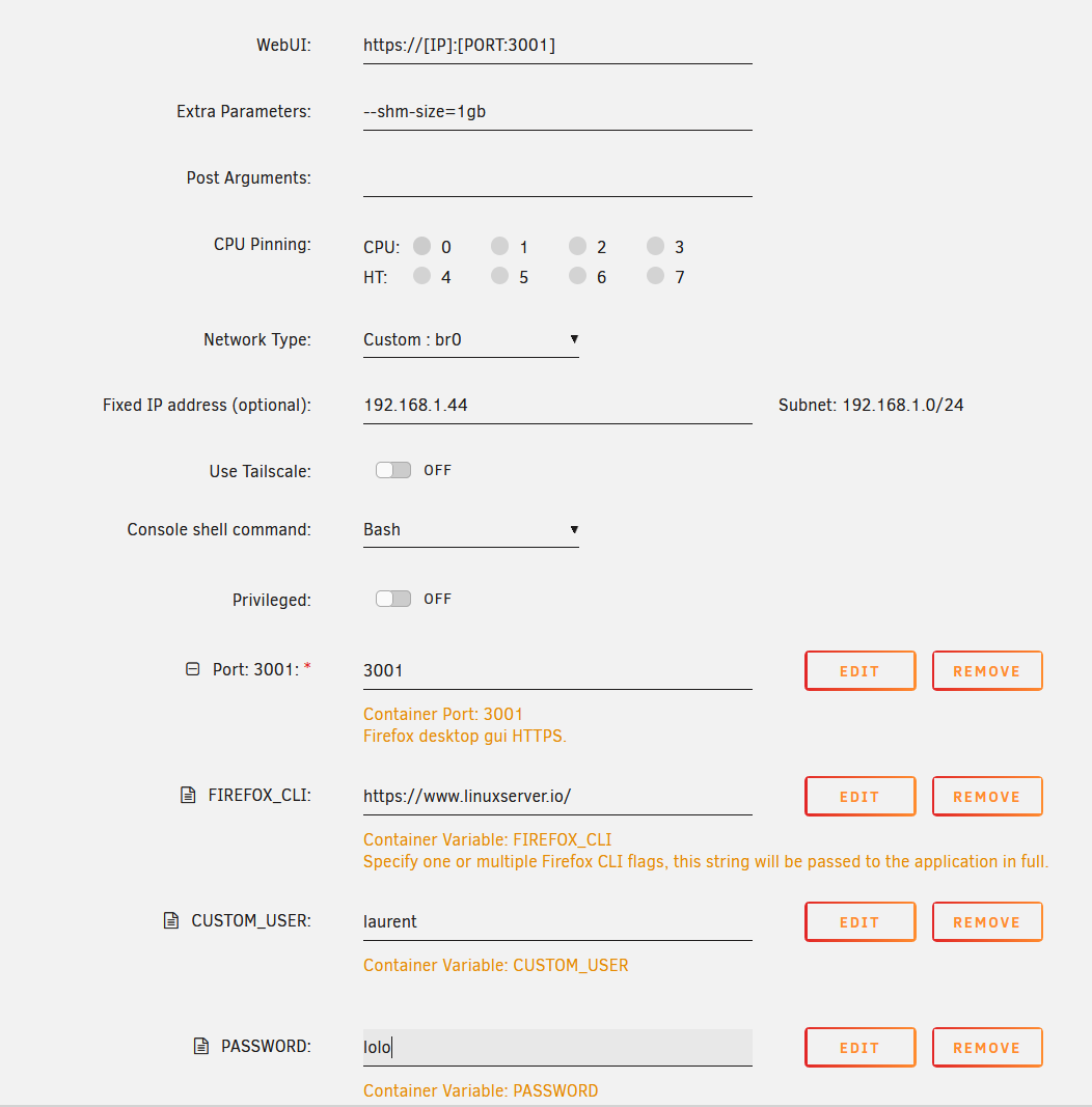

July 10, 20251 yr On 7/1/2025 at 6:06 PM, zarkoff said:Thanks, but even forcing https:// and port 3001 and JPEG, results the same (for me, at least)In log I see thisdo you what it means? do we have to do something with port 8082 ?On 7/1/2025 at 6:06 PM, zarkoff said:Thanks, but even forcing https:// and port 3001 and JPEG, results the same (for me, at least)In log I see thisdo you what it means? do we have to do something with port 8082 ?I just dealt with this, and had to edit the container like so:Edited where it says WEBGUI up above so that it says "https://[IP]:[PORT:3001]"Remove the WebGUI variable (the one that is HTTP).Add in two new variables: CUSTOM_USER and PASSWORDStep three is crucial. Without it, you can't use the docker.Hope this helps.
July 12, 20251 yr Author On 7/10/2025 at 2:30 PM, TheGreenWizard said:I just dealt with this, and had to edit the container like so:Edited where it says WEBGUI up above so that it says "https://[IP]:[PORT:3001]"Remove the WebGUI variable (the one that is HTTP).Add in two new variables: CUSTOM_USER and PASSWORDStep three is crucial. Without it, you can't use the docker.Hope this helps.Hi, well I did exactly the same, I doesn't work for me.It seems that your solution works for some people, but unfortunately not for me, and I don't understand why.Thank you very much for taking the time to help me. I am moving to another Docker container that does not use Selkies.
