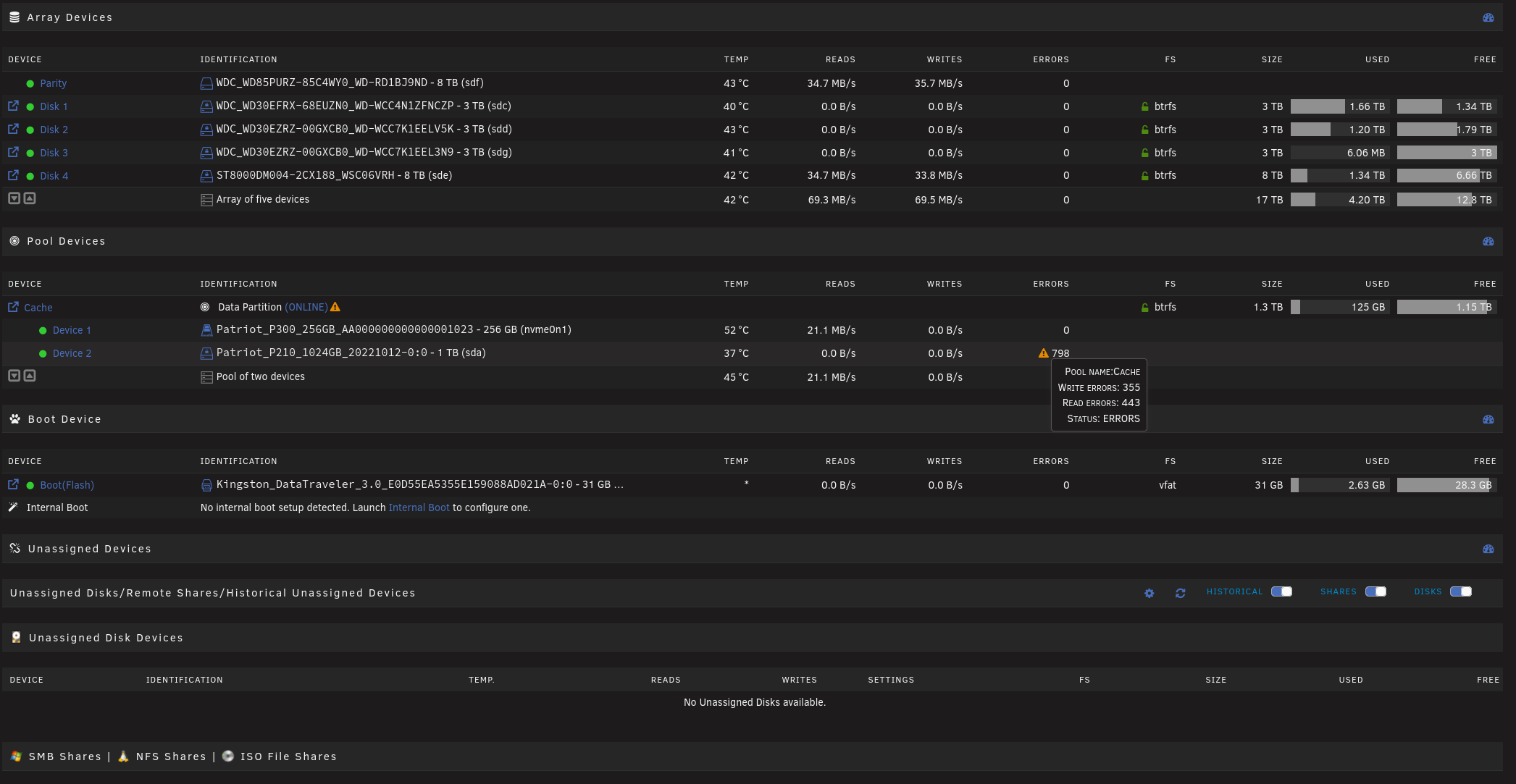

  1. Thanks, that seems doable if I knew what my parity drive was. Unless it can tell me somehow, but I doubt that's the case. Looking if I have a screenshot of my main page anywhere on my PC now by chance. Also buying an m.2 as a boot stick now, running off of USB sticks was kind of terrible anyways. Different question. Everything is gone now right? Configuration wise I gotta start from scratch? Update Edit: I somehow managed to boot into it and I have no idea why or how. I tried it multiple times with no luck today and now I was trying to give it one last shot. Tried booting without safe mode or anything and it just decided to work??? Can't explain that one. Screenshot my main tab so I have a full list now. Stopped the parity sync and invoked the mover. Gotta get the cache empty before I lose more data than I already have (probably).

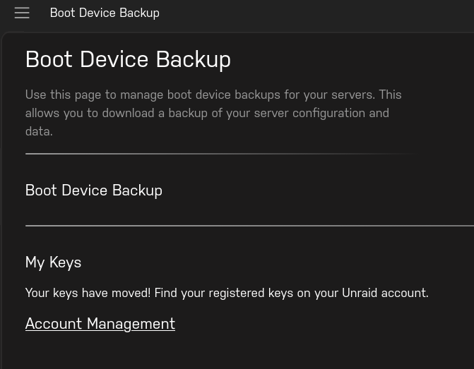

  2. Having the same problem. One of my VMs failed to boot, turns out my SSD cache pool has a drive throwing errors. So I set all the shares to array and invoked the mover (to empty the cache so I can remove the drive). I waited a day because it was god slow for some reason and now I am having this issue. Restarted into safe mode too, doesn't seem to change anything. Unraid Connect website tells me I have no boot device backups. (I enabled automatic backups and it showed me multiple times that it had done a backup.) I searched my entire PC, no backup there. I probably have some ancient backup guess where: on the server itself. So uhm, how screwed am I exactly?

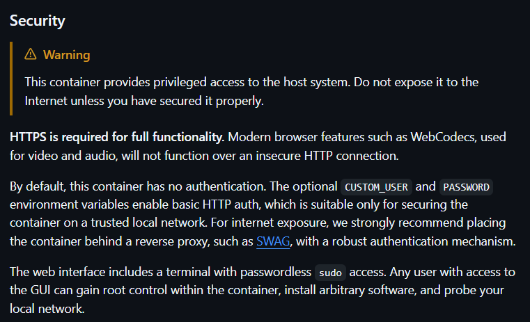

  4. Having the same problem but with Ungoogled Chromium. Guessing this belongs here too then. Even after setting the variables CUSTOM_USER and PASSWORD I still get the HTTPS required message on port 3000 and the waiting for stream one on port 3001. I thought HTTPS was not required when using CUSTOM_USER? (https://github.com/linuxserver/docker-ungoogled-chromium/pkgs/container/ungoogled-chromium) Anyone found a fix for that yet? Nothing in here seems to be working. Edit: What I noticed when I try port 3001 is this. It says not secure.

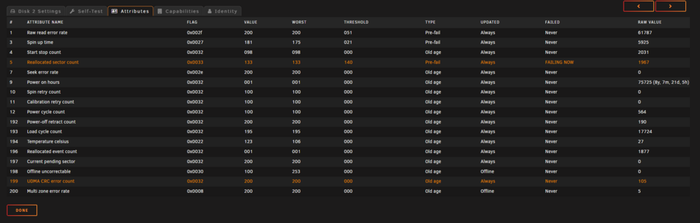

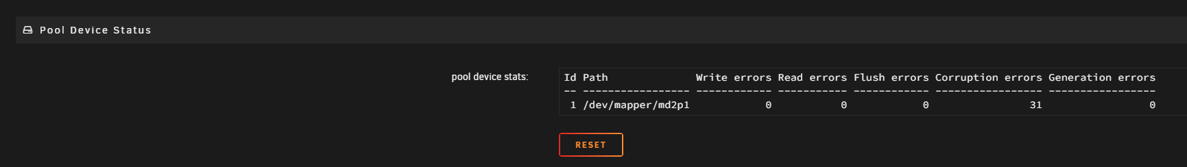

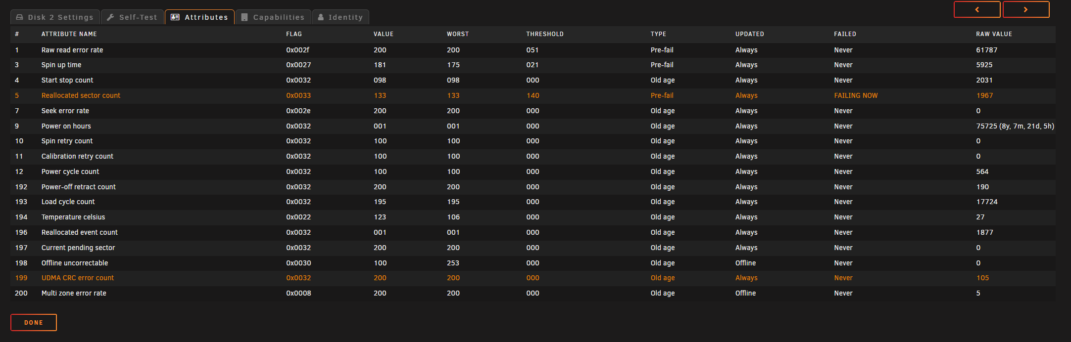

  9. Hello, I wasn't sure where to ask correctly so I try here. I noticed something weird when my scheduled parity check has been running for two days and hasn't moved past 35%. When I checked I saw that it was running at between 0.3 and 2 MB/s. When I checked the drives one of them showed a reallocated sector count error and it has been going up since. It now says failing now in capital orange letters. (Ignore UDMA CRC error count, that was because of bad SATA cables I have used previously. I have replaced those, I just don't know how to clear that statistic.) I stopped the parity check and spun down all drives as I don't want to annoy the failing drive more than necessary. I am not sure what my next move should be. I do not have a replacement drive right now and I am not sure if I should back up the failing drive as it also says something about corruption errors. Don't want to overwrite good data with corrupted ones. Should I just yank it out, make a new config and rebuild the data from parity? (I have 2 parity disks because I use recycled and usually older drives.) I wasn't really 100% sure so I wanted to ask before I do anything dumb. I also have a SMART test done yesterday and current diagnostics here if that helps in any way.littleboi-diagnostics-20250804-1744.ziplittleboi-smart-20250804-1741.zip Thanks in advance

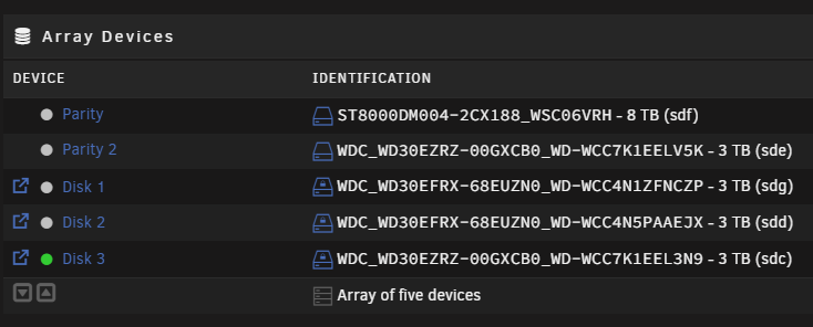

  10. Update: So the new SATA cables arrived. I threw out the old ones and put in the new (supposedly good ones). Starting up, the system still shows parity 2 as disabled. To make sure the system even recognizes that drive, I did a short SMART test. It completed without errors. littleboi-smart-20250604-1742.zip I am not really sure where to go from here. Is this something with the config of my system? Is the drive just toast? Edit: I found comment on a 3 year old Reddit thread that fixed it. Guess I was just dumb not thinking of this. Rebuilding parity now. The comment: Stop the array, unassign the disk, start the array in maintenance mode, stop it again, reassign the drive to the same slot. The idea is to start the array temporarily with the drive “missing” so it changes from “disabled” to “emulated” status, then to stop it and “replace” the drive to get it back to “active” status. Thanks for all the help. You have been amazing.
  11. Got it, thanks. Always wondered how that works. I just moved all the system and appdata files over to the cache manually. I could have probably done it with the mover in hindsight, but that would have required to set the shares up for secondary storage. It seemed to have worked that way, thanks. I also adjusted the spindown timer for all drives to 30 minutes and set up appdata backup for doing weekly backups to the array.
  12. Yup, I acknowledged it. Now all drives show the green thumb up again. I do want to keep the second parity disk, even if it might not be the fastest thing to do. I am using recycled drives so that lets me sleep at night. The disk still shows up as disabled, I tried reseating, restarting but it still shows as disabled. To make sure the system even recognizes the drive, I ran a small SMART test which completed without errors.

  14. Yes, parity 2 shows the UDMA CRC errors that are common. After clicking on attributes for that disk: I also ran a short SMART test for that drive but I can do a long one too if that helps. littleboi-smart-20250530-1548.zip
