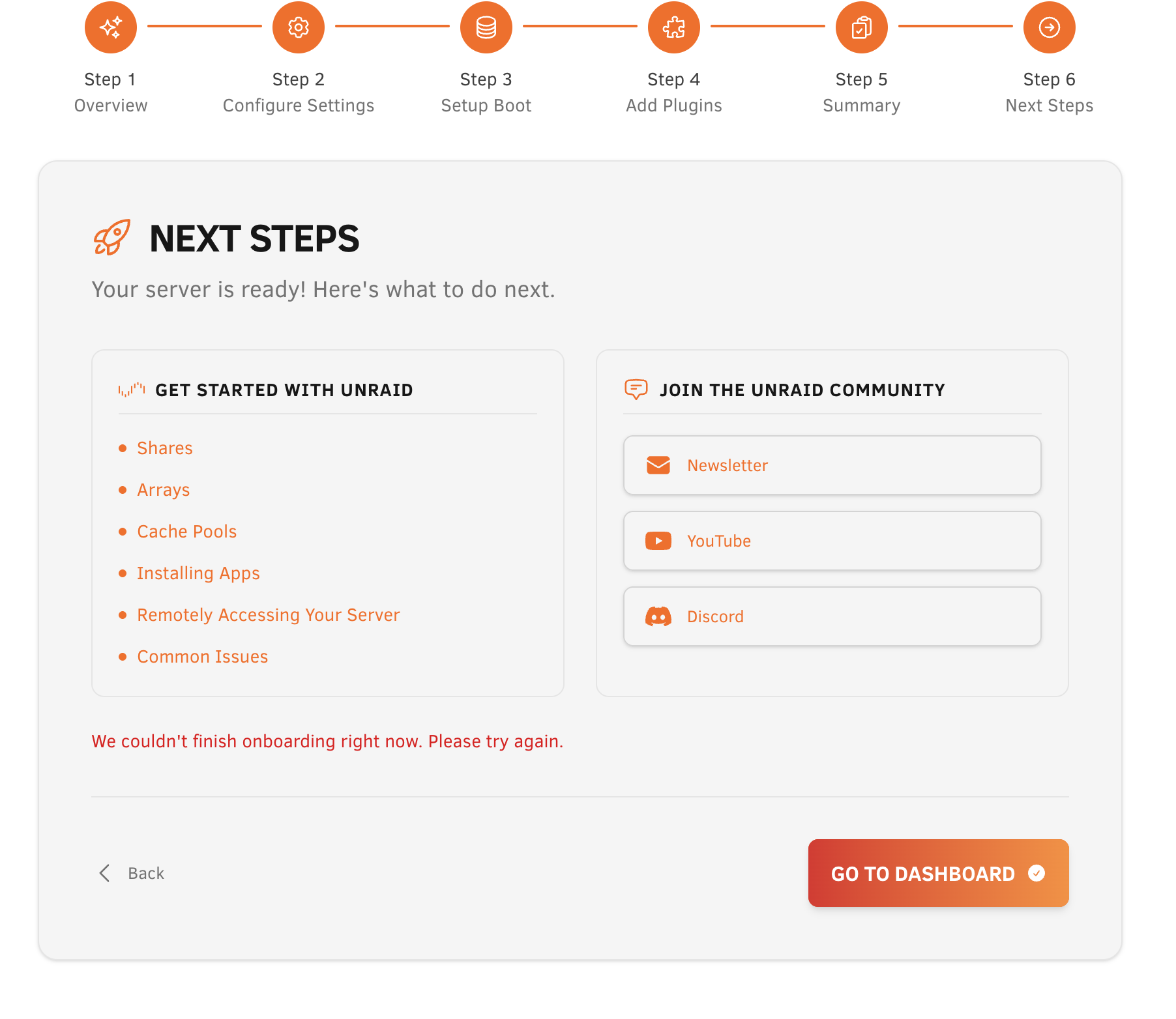

  7. i just updated to version 7.3.0 and cannot skip/end the onboarding. On the last screen I get the error "We couldn't finish onboarding right now. Please try again." after clicking on "GO TO DASHBOARD" When I try to close the onboarding, it will immediately pop up again so I cannot get to the dashboard. Thanks for any possible help

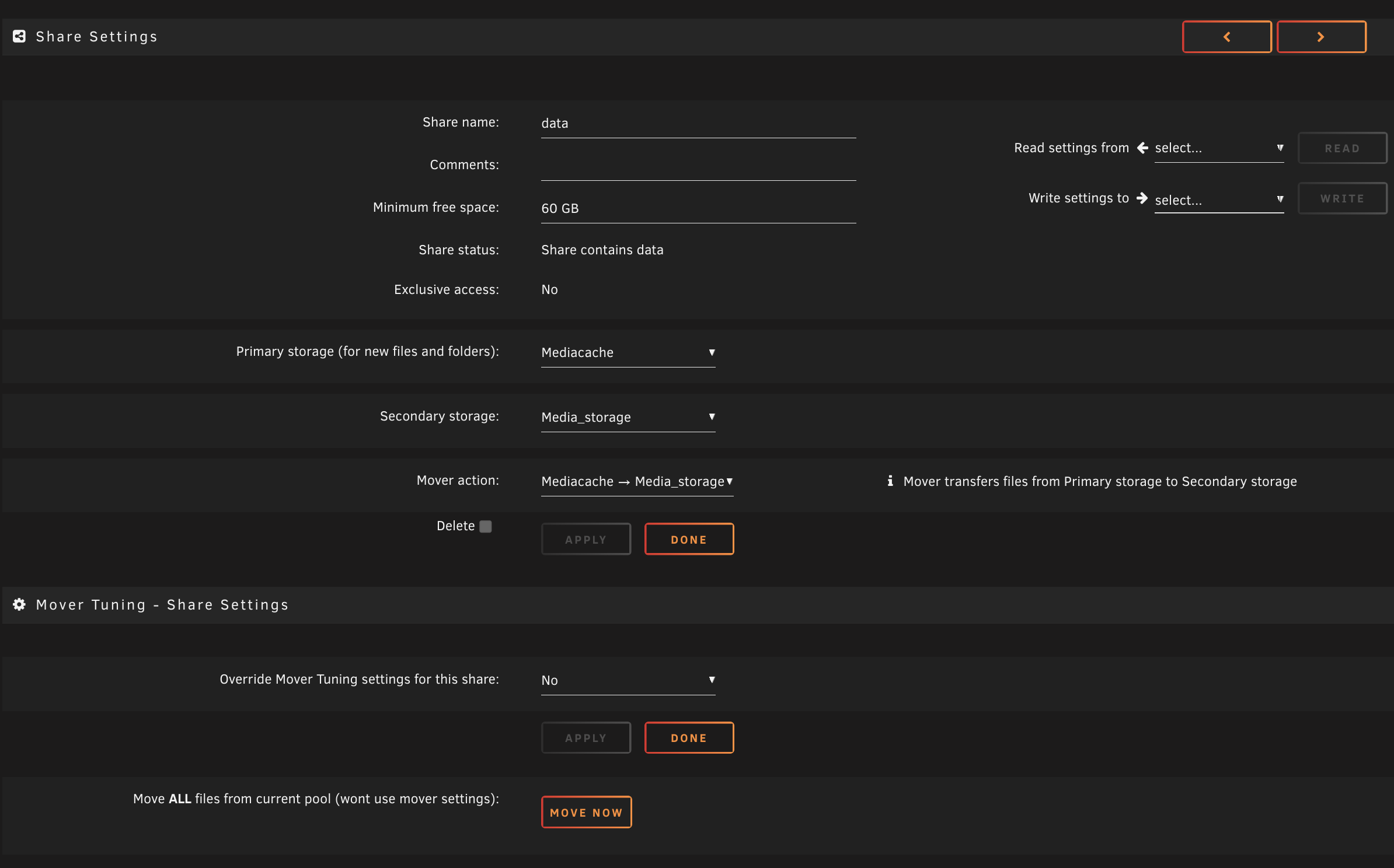

  12. @itimpi >> from what I undeerstood from your message in August, my setup should work, right?

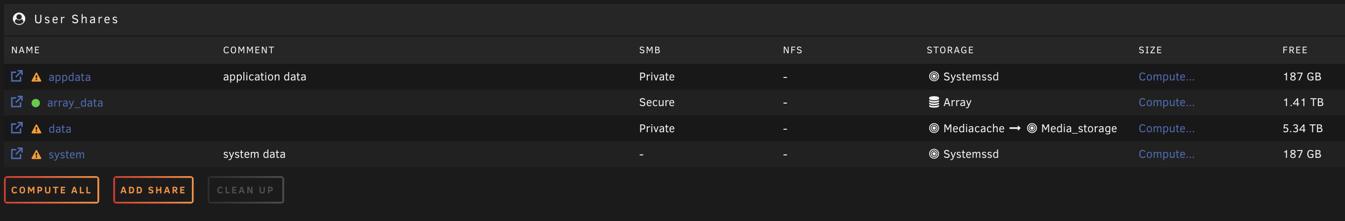

  13. Hi all, the mover is not any files, no matter if I use the plugin or just the standard mover setting. Also when I manually trigger the "move" button, nothing happens. SETUP I have a rather uncommon setup in which I have a pool device that is the cache. I have another pool device (independent from the first one) that is my media library. New files should go to the cache first and then should be moved to the media library. The Array is for other data and does not have an upstream cache. FYI: To achieve this setup, I had to use the new Unraid 7 version URAID VERSION 7.0.0 beta 4 SHARE/MOVER SETTING So the question is, what could be wrong here so that the mover is not doing its job. Is it only working with the Array? Something that I just realized: when I download new files, they are directly saved on the media_storage and don't even go to the cache anymore, which is exactly the opposite of what should happen Thanks for any advice you can give me. best regards K

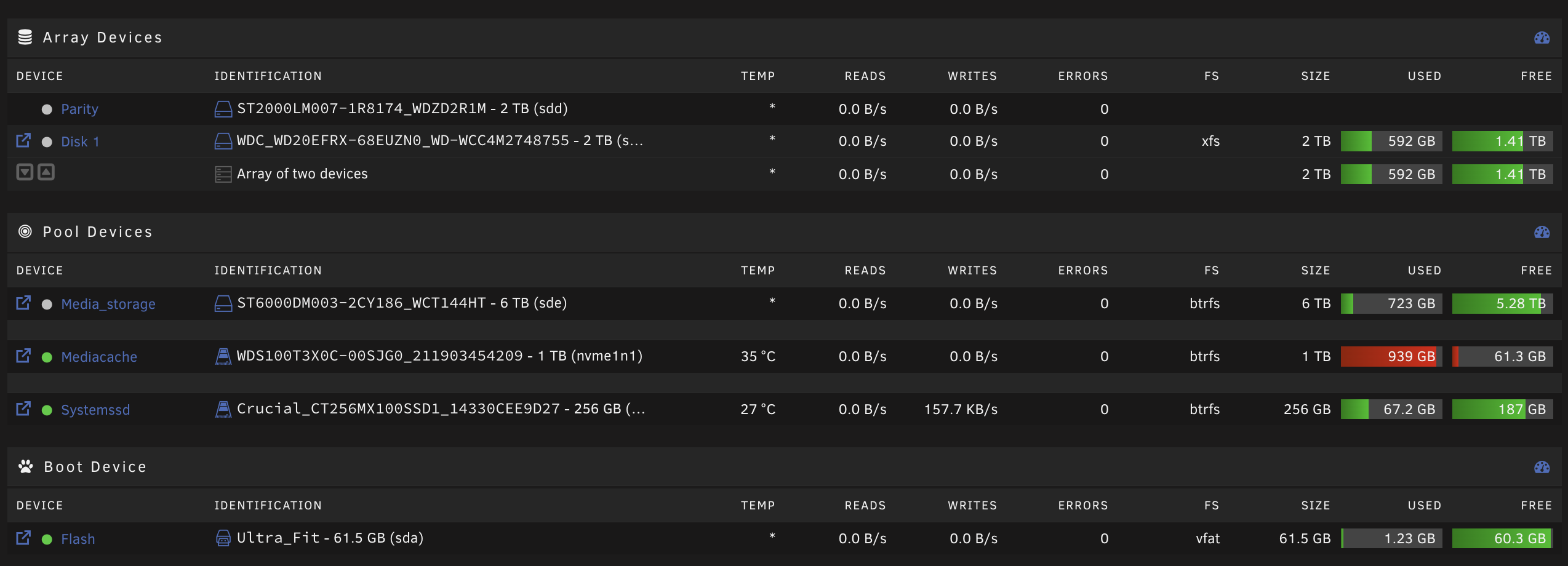

  15. Dear Community, I have a somewhat unconventional use case for Unraid and would appreciate any guidance on achieving it, whether with the current version or the upcoming version 7. Here’s my preferred setup: 1. Array: 2 HDDs with parity for important data. 2. Pool/Cache: 2 SSDs/NVMEs with parity. 3. Another Pool: 6TB HDD dedicated to media files only (without parity). For the array (1), I’m open to adding a cache, but since data transfers are infrequent, it’s not a priority. I understand that setting up a cache for an array is relatively straightforward and is a common practice. The cache (2) should primarily serve the media files. Ideally, I’d like to use it as a cache for the array as well if feasible. My goal is to keep the HDDs spun down most of the time to conserve energy. With a cache of around 1TB and relatively low data transfer, I plan to retain data in the cache as long as possible before transferring it to the media storage (3). Specifically, I’d like to keep data in the cache until it drops below 20% capacity. This way, new files are more likely to be served from the cache rather than the HDD. My main question is: Is this setup achievable with either of the mentioned Unraid versions? Or is this approach fundamentally flawed? If so, could you explain why? I appreciate any insights you can provide. Thank you in advance! Best regards
