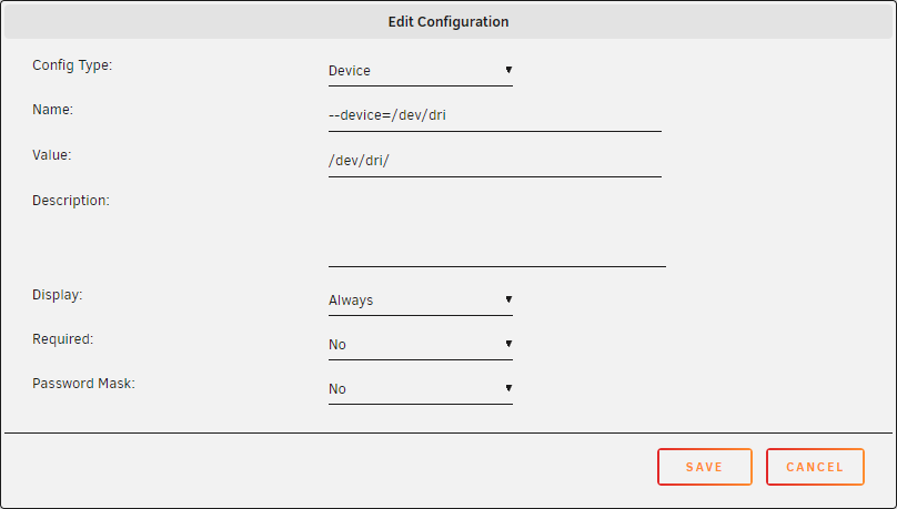

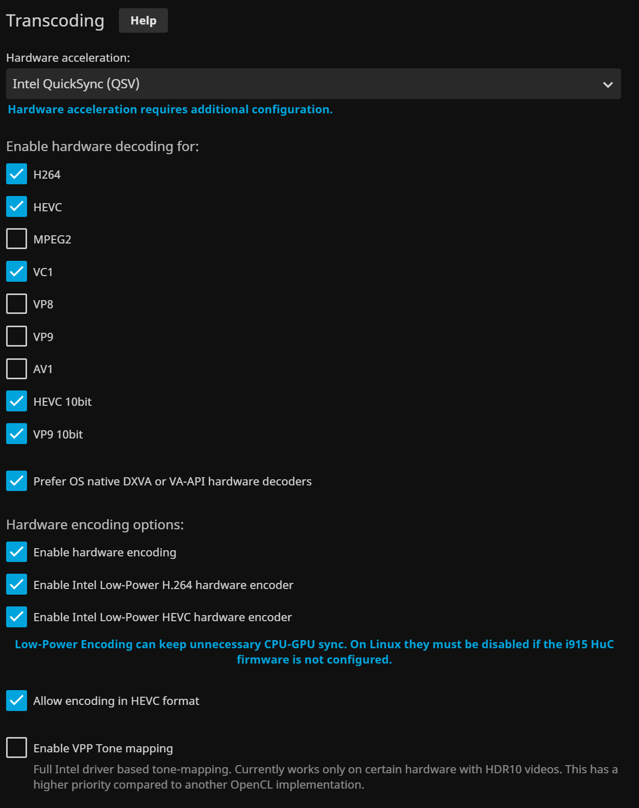

September 27, 20233 yr I was in the same boat. Pass the GPU to Jellyfin container like this. Guides: https://jellyfin.org/docs/general/administration/hardware-acceleration/intel/#low-power-encoding In this one the only thing I didn't get to work in terms of command was the Step 3. Make sure you run this and it works: sudo mkdir -p /etc/modprobe.d sudo sh -c "echo 'options i915 enable_guc=2' >> /etc/modprobe.d/i915.conf" Go to /etc/modprobe.d and see if you have the i915.conf file with the options i915... there. Reboot and for me this worked. In terms of setting in Jellyfin is important to have this: Install also Intel GPU TOP plus the GPU Statistics plugins to see if the GPU is working: By the way, I'm using Linuxserver docker image. Edited September 27, 20233 yr by procedural-forecaster4720 Add more helpfull info

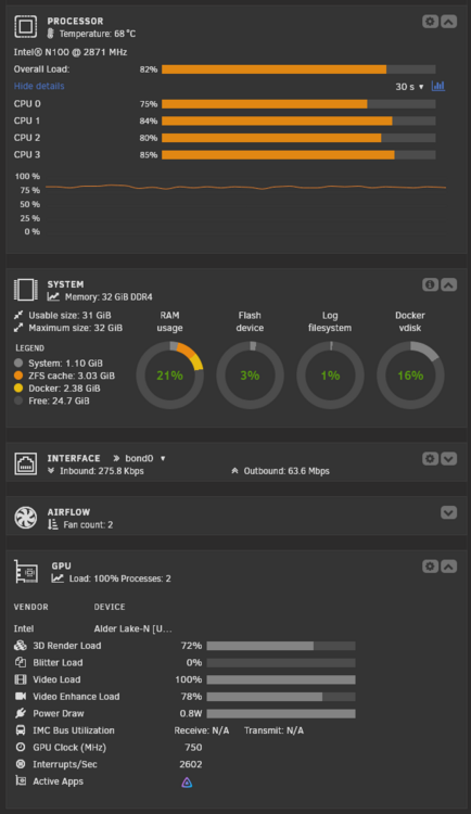

October 20, 20233 yr Hi *, had the same issue with my N6005, Unraid 6.12.4 and binhex Jellyfin. I noticed that the igpu must be working after i configured jellyfin as described above, because the CPU usage when streaming a 4K Video dropped from above 80% to under 20%. The only issue left is - i don't get any data shown in intel_gpu_top & Gpu Statistics. BR, Mung0

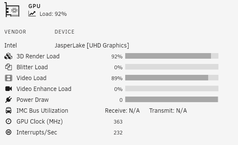

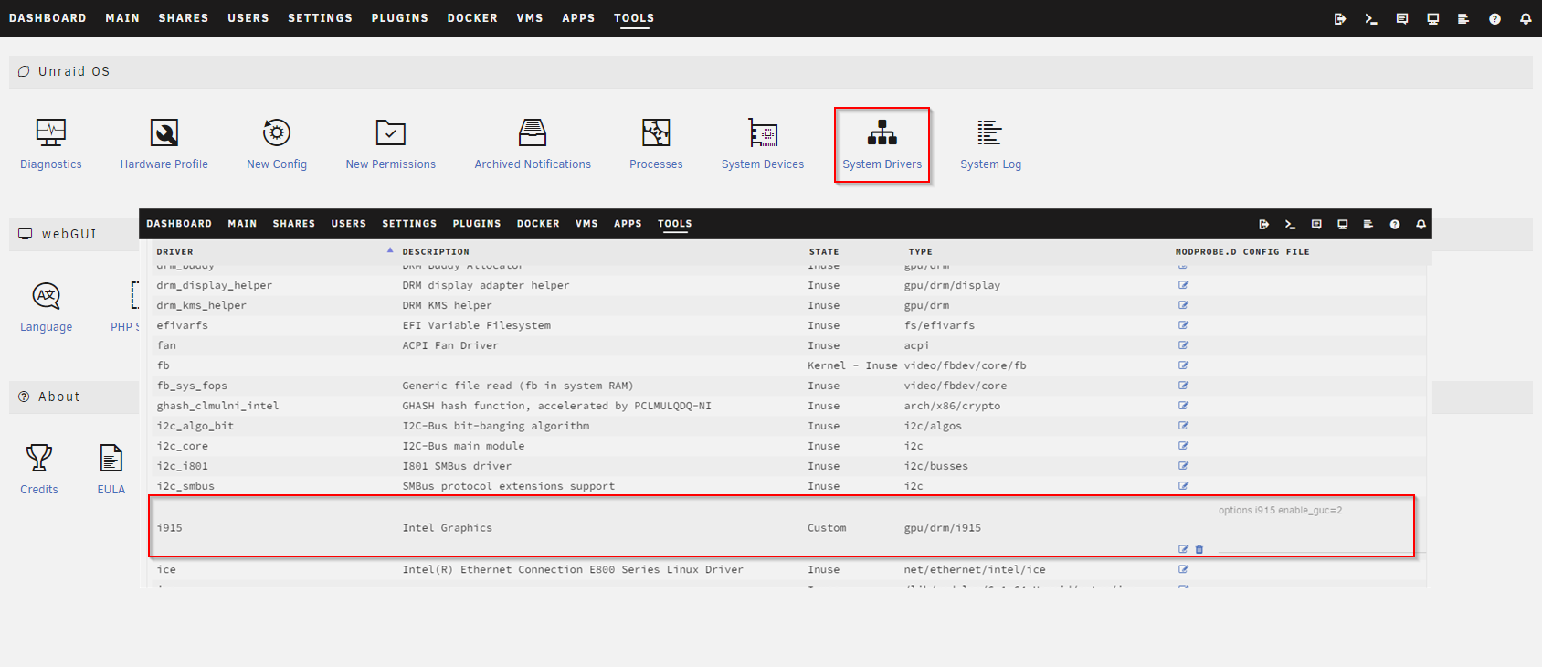

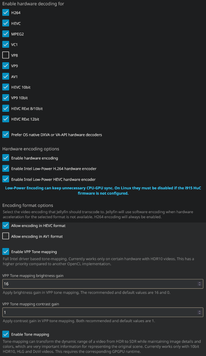

February 5, 20242 yr For someone who, like me, has spent 2 weeks trying to set up transcoding for Jellyfin and has an N5105 board. In the end it is pretty simple. My biggest problem was to use binhex version or linuxserver version . It only worked after using original Jellyfin image. jellyfin/jellyfin I have set up the following: 1. navigate to Main, then under Boot Device go to Flash - under Syslinux Configuratuin in the Unraid Os section I now see the following: 2. install GPU-statistics in the Unraid appstore - Then you can check the usage in the Unraid Dashboard (don't forget to configure the Plugin by selecting the GPU in the config. 3. docker configuration for Jellyfin: 4. jellyfin settings in the transcoding section I would be glad it someone finds this helpful. Feel free to ask me when you have issues.

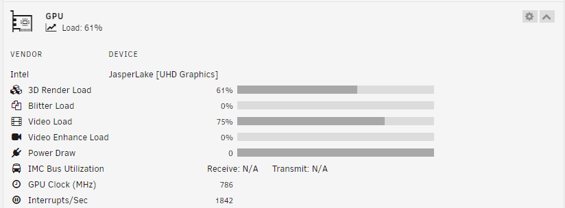

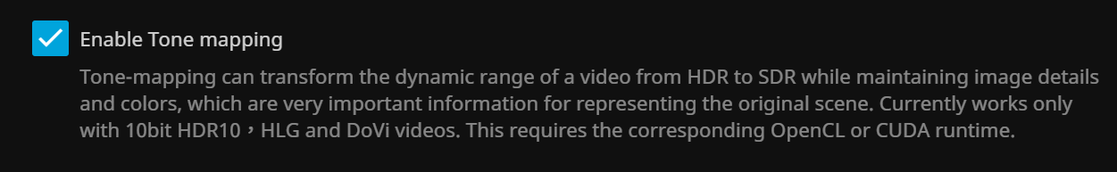

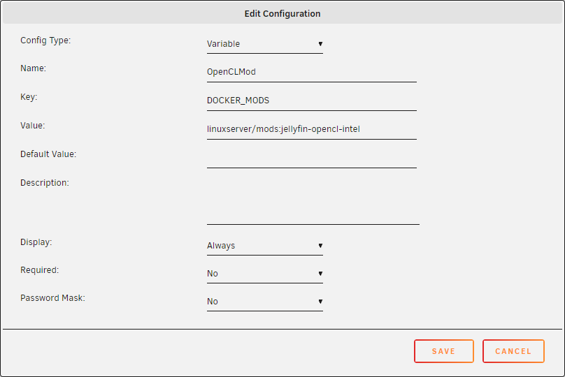

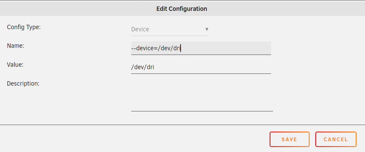

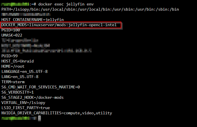

February 8, 20242 yr Hi all, I am also hijacking this thread as this was the main hit when I was trying to figure out how to get Transcoding running with the N5105 in the last week since I set up my Unraid server. It is not really obvious how to get it running, especially for someone like me that has never worked on linux based systems. The following steps worked for me using the linuxserver-jellyfin to get Trancoding running including HDR content. 1. Ensure the i915 conf is done correctly as described by Glutao above. You can also check this in your unraid system parameters, I had a typo initially but was able to figure it out and correct here directly. 2. Add the Device parameter to pass the IGPU to the Docker container (Thanks to Glutao, this was a life saver, adding the screen here for completeness sake) 3. I ran into an issue with HDR content where I got an error message in Jellyfin that the Media is not compatible, meaning transcoding is not working. This can be fixed by adding the following parameter to include the OpenCL Docker mod from linuxserver https://github.com/linuxserver/docker-mods/tree/jellyfin-opencl-intel. There is a description how to add it in the github that might be obvious to experience Docker/Linux users, but I had to fiddle around so add the following parameter to the docker container: you can check if the variable has been set correctly using: docker exec jellyfin env replace jellfin with your docker container name if it is different. If it shows up like this you are good to go. 4. Install GPU Statistics and Intel GPU TOP from the Community applications to be able to see if the GPU is used when Transcoding is active If transcoding using the GPU works it will look something like this on the dashboard: 5. Inside Jellyfin apply the settings exactly as mentioned in the Posts from Glutao and MisterMue above. I hope that this will be helpful seing this page is the first hit for jellyfin N5105 Jasperlake issues. I managed to get it running after several days of searching through reddit, unraid forums and github. The least I can do is save others from going through the valley of tears. Happy to help if anyone has questions.
November 17, 20242 yr On 2/8/2024 at 11:16 AM, FRU said: 1. Ensure the i915 conf is done correctly as described by Glutao above. You can also check this in your unraid system parameters, I had a typo initially but was able to figure it out and correct here directly. I just wanted to say thank you and state, that this step was the most important. Adding the 915 option via modprobe.d (like Glutao suggested) was always purged after reboot, but adding the line directly via this entry made everything work (Unraid 7 beta 4) Now I can finalize the setup of my Austor 5402T with Unraid and Jellyfin. BTW: You can enable MPEG2 acceleration too, if you still have some DVDs.

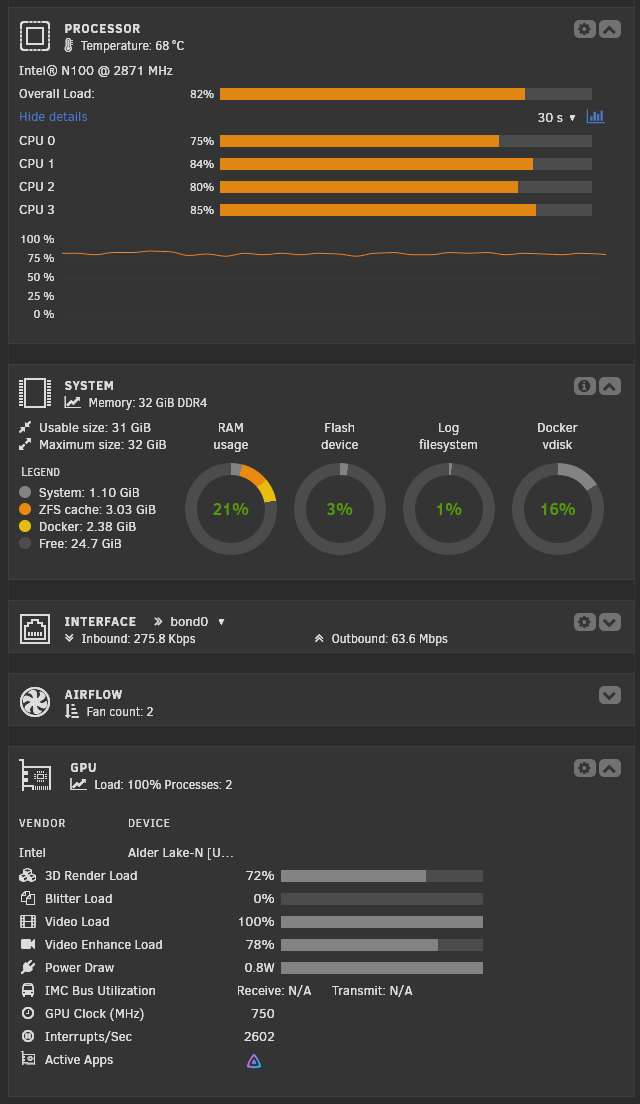

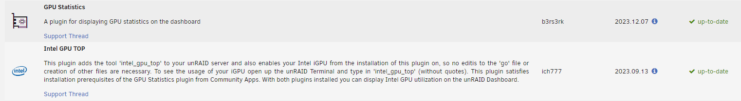

May 24, 20251 yr I'd just like to chime in for others arriving at this page via web search that I was successfully able to enable Intel QuickSync transcoding for ghcr.io/binhex/arch-jellyfin (10.10.7-1-01) on Unraid 7.x by following these directions. My hardware is different than the thread title, but the steps worked nonetheless: This is with an Intel 12th gen with UHD 730.All of the comments and screenshots above were extremely helpful to me.My steps were as follows:While not necessary for the transcoding, this first step makes it easy to tell whether Jellyfin is successfully utilizing your GPU:In the unRAID Web UI, select Apps, then search "gpu statistics," and install first ich777's Intel-GPU-TOP and then b3rs3rk's GPU Statistics.Go to Settings (or Plugins) > GPU Statistics, and the top field (Unit ID for Dashboard) should now have a pulldown menu option for the Intel GPU. Select it, scroll down, and click "Apply."As @Glutao explains further up in the thread, open up the unRAID terminal (in the default theme, there's a button for it up in the top right of the unRAID Web UI) and run the following commands:sudo mkdir -p /etc/modprobe.d sudo sh -c "echo 'options i915 enable_guc=2' >> /etc/modprobe.d/i915.conf"The first command in Step 2 creates a folder called /etc/modprobe.d in your unRAID filesystem. The second creates a file called i915.conf inside that folder and populates it with the string: options i915 enable_guc=2In my case, I skipped the first command: the i915.conf file did not exist on my unRAID system before running the command, but the modprobe.d folder did already exist.EDIT: On further reading (as per https://jellyfin.org/docs/general/post-install/transcoding/hardware-acceleration/intel/#low-power-encoding ), it looks like my 12th gen iGPU has enable_guc=3 on by default, so for my case, I'm removing this setting.In the unRAID Web UI, select Tools > System Drivers, and scroll down to find "i915." There should be an entry in the far right column (under the header "MODPROBE.D CONFIG FILE") that confirms creation of your new string. This needs to persist on reboot, so reboot your unRAID server and make sure it's still there afterward.Finally, it's time to modify the Jellyfin Docker config.Assuming you already have the container installed, click on the Jellyfin icon in the Dashboard, select "Edit," and in the config view:Scroll to the bottom, click on "Add another Path, Port, Variable, Label or Device" and in the Popup window:Config Type: DeviceName: [whatever you want; this is just a label inside the Docker config view]Value: /dev/driDescription: [whatever you want; consider writing a memo to yourself that this was the flag you added to enable hardware transcoding]Click "Add" to dismiss the popup and then "Apply."Start the Jellyfin container and open up its Web UI.You'll need to be logged in with a Jellyfin administrator account, such as the one you created when you first set up the container.Click on the hamburger menu in the top left, select Administration > DashboardOn the new left-hand pane, select Playback > TranscodingFor Hardware acceleration, select Intel QuickSync (QSV) from the pulldown menuFor QSV Device, type in:/dev/dri/renderD128Scroll down a bit, tick the box for "Enable Tone mapping"Scroll to the bottom, click "Save"Probably not necessary, but restart the Jellyfin container for good measure.After doing this, I was able to playback some media on Jellyfin Media Player, force a low kbps quality during playback, and confirm on my unRAID Dashboard that the GPU was being utilized by the Jellyfin container.I've noted @FRU's issue with HDR content and will keep an eye on it but haven't yet encountered issues myself.Hope this helps someone else in the struggle to enable hardware transcoding! Edited May 24, 20251 yr by wabun
September 24, 20251 yr On 2/5/2024 at 3:34 PM, MisterMue said:1. navigate to Main, then under Boot Device go to Flash - under Syslinux Configuratuin in the Unraid Os section I now see the following: This was the key to getting my 12th gen alder lake (it's one of those weird Erying boards with an ES CPU, equivalent to an i5 12XXX) HW acceleration working. Prior to adding "i915.enable_guc=2" to my kernel arguments I was able to see and select the CPU for the GPU statistics plugin, but get no data. Similarly intel_gpu_top would error when I attempted to run that. Once I added this, rebooted, everything started to work. One more tip for anyone on similar hardware, you need to disable "Allow AV1 encoding" in the settings to get 4k content to playback correctly.
