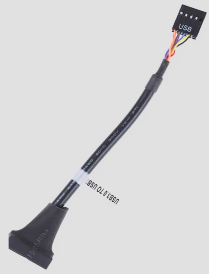

  4. ok , finally my update. Just installed the cable : It works ! be carefull which one you take: Aliexpress
  5. I am also having this board case combination and ordered a USB 2.0 > USB 3.0 adapter cable.. i will tell how it went...

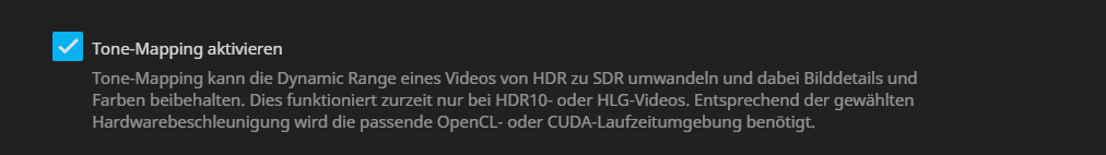

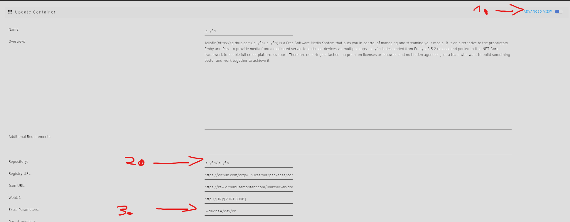

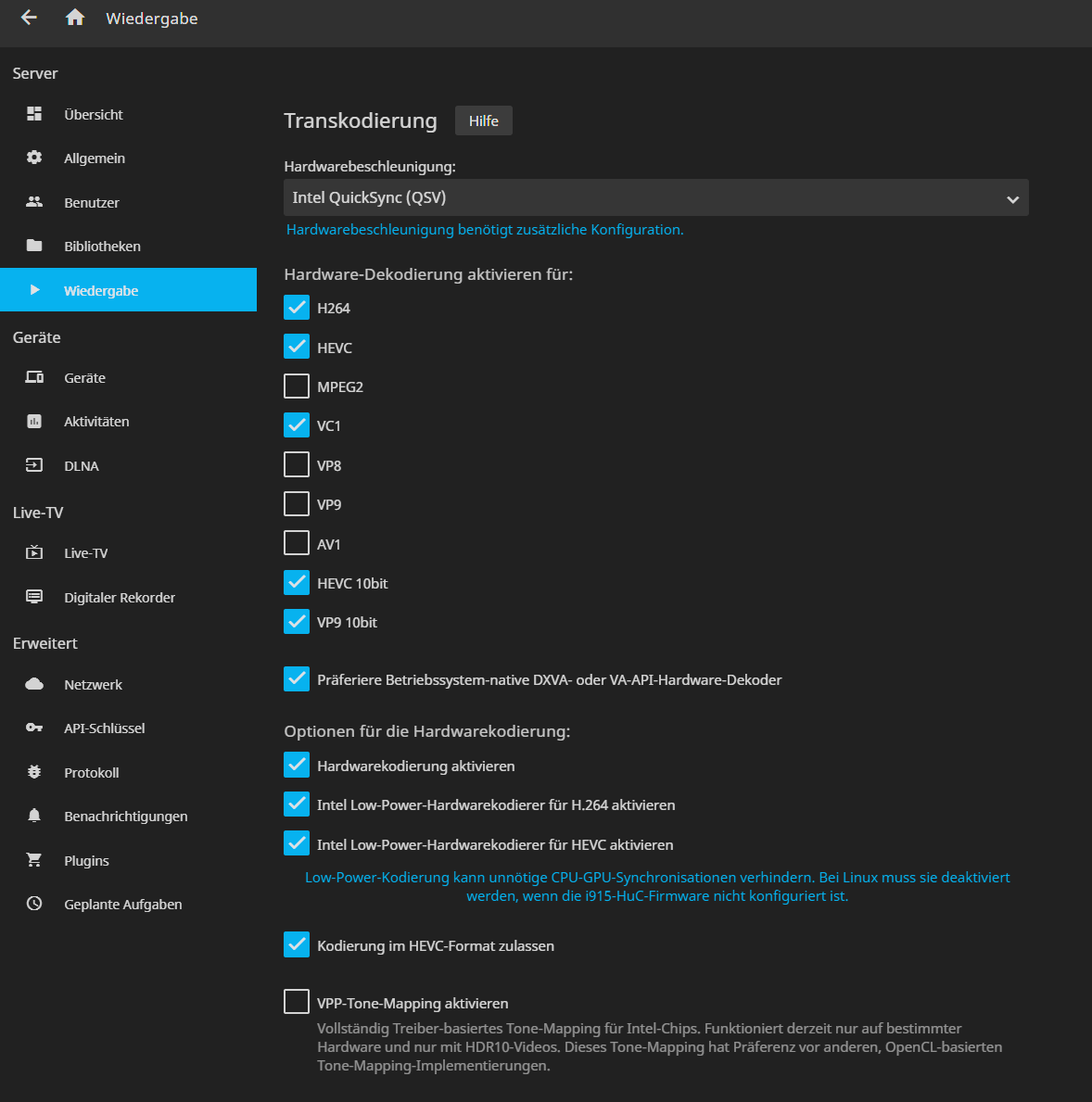

  6. For someone who, like me, has spent 2 weeks trying to set up transcoding for Jellyfin and has an N5105 board. In the end it is pretty simple. My biggest problem was to use binhex version or linuxserver version . It only worked after using original Jellyfin image. jellyfin/jellyfin I have set up the following: 1. navigate to Main, then under Boot Device go to Flash - under Syslinux Configuratuin in the Unraid Os section I now see the following: 2. install GPU-statistics in the Unraid appstore - Then you can check the usage in the Unraid Dashboard (don't forget to configure the Plugin by selecting the GPU in the config. 3. docker configuration for Jellyfin: 4. jellyfin settings in the transcoding section I would be glad it someone finds this helpful. Feel free to ask me when you have issues.
