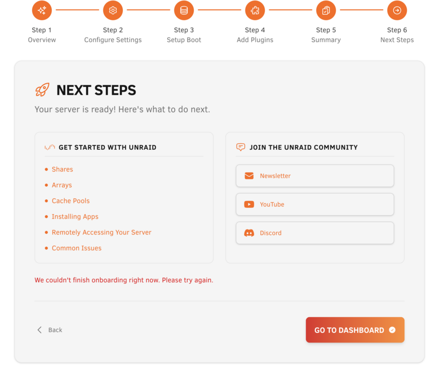

Cannot skip or finish onboarding in 7.3.0
i just updated to version 7.3.0 and cannot skip/end the onboarding. On the last screen I get the error "We couldn't finish onboarding right now. Please try again." after clicking on "GO TO DASHBOARD"
When I try to close the onboarding, it will immediately pop up again so I cannot get to the dashboard.
Thanks for any possible help

On 5/13/2026 at 1:06 PM, JorgeB said:
Try rebooting in safe mode, if it still doesn't close, get the diagnostics from the CLI.
Thank you for the support. I did that but error is remaining.
i tried to create logfiles but apparently they cannot be written to the usb stick because it is read-only. Could that be the underlying issue? But before the update everything was running smoothly.
Most likely, try recreating the flash drive, backup, recreate with the tool, restore only the config folder from the backup

@JorgeB I have the same issue after upgrading to 7.3.1
"We could't finish onboarding right now, please try again"
How can i restore access to the webui? Is recreating the flash drive the only way? How can i rebuild it without losing the configuration?
That typically means a flash drive problem; try recreating it first. first backup the current one, then recreate it using the USB tool, confirm the flash drive boots with the stock install, and if yes, restore only the /config folder from the backup overwriting any existing files.
