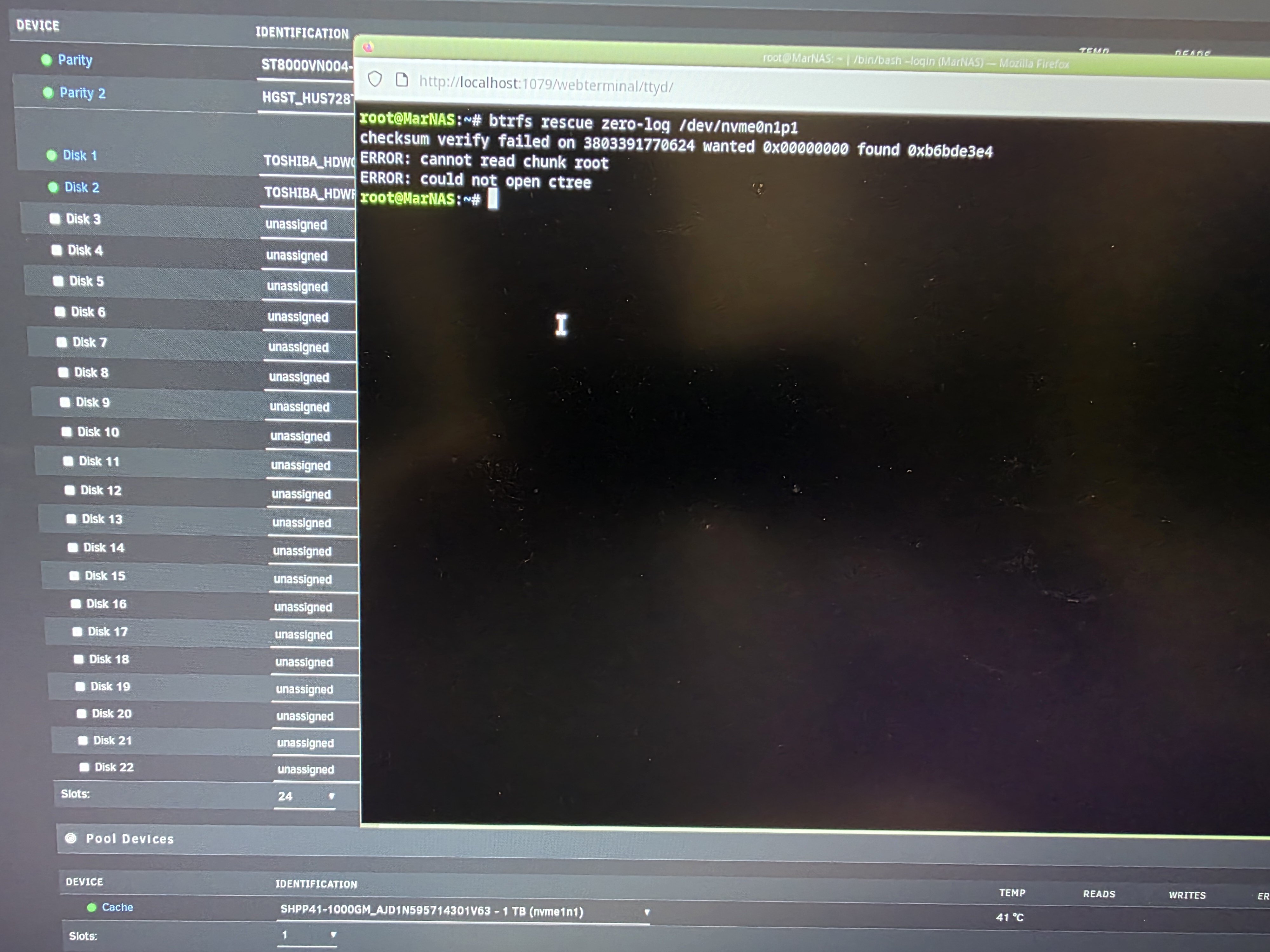

  5. Sorry for the grainy picture but this is what I get when running a btrfs rescue

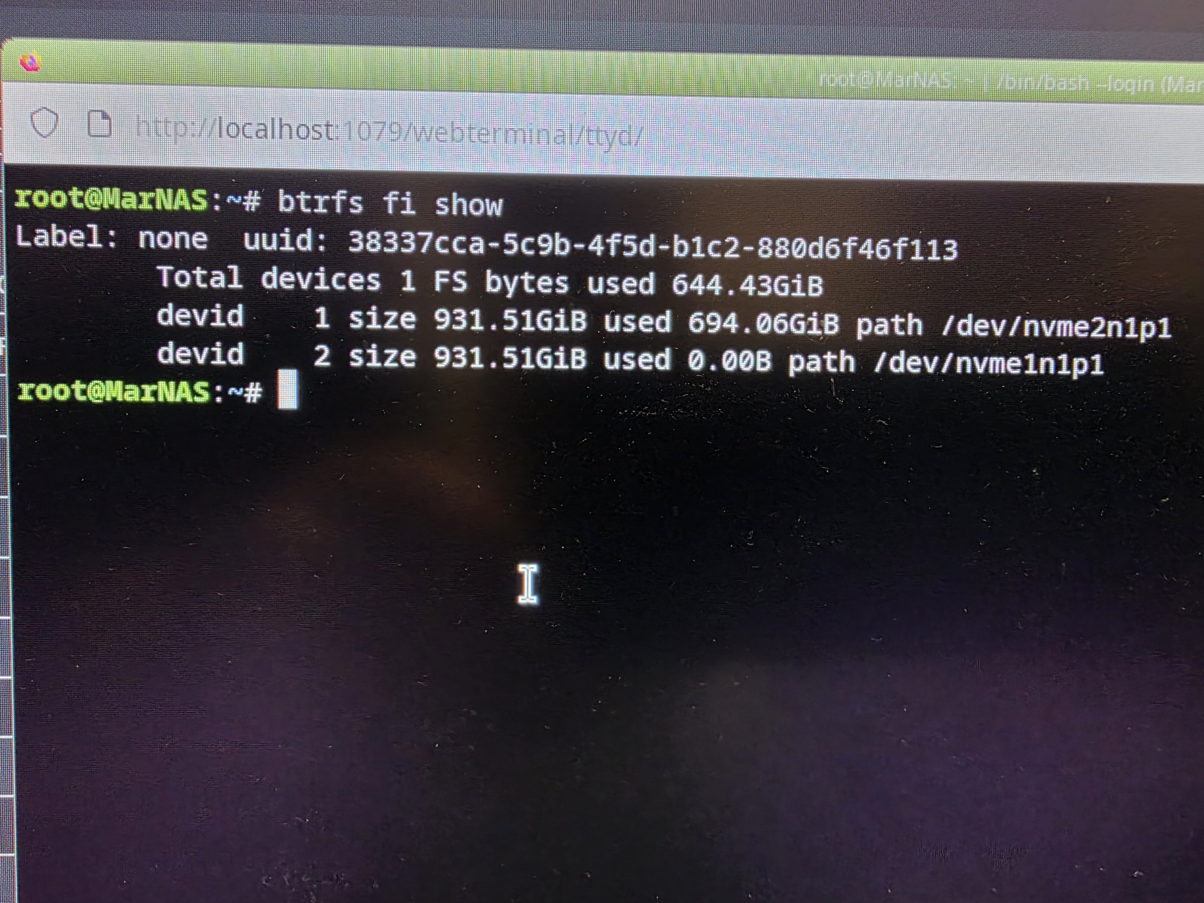

  6. After changing hardware my btrfs pool with 1 drive will not mount. I noticed the output of "btrfs fi show" shows a 2 drive pool with different drive names then what the same drive is called on the new system i woudl attach diagnostics but the server is not available on the network for some unrelated reason
