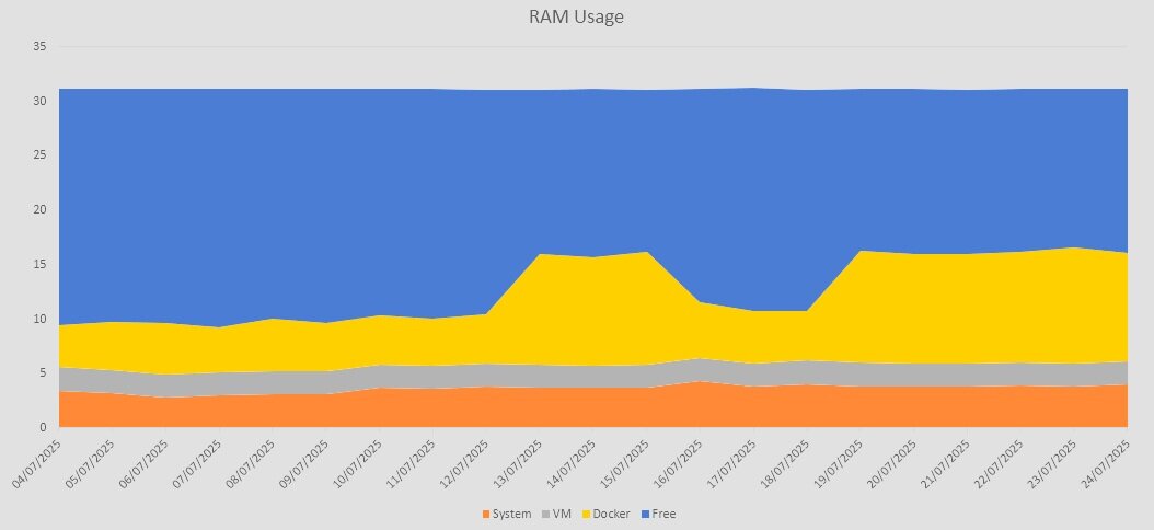

As an aside, I also started tracking RAM consumption over time in the event that the issue was some kind of memory leak. I grab the stats from the homepage at the same time every day. Nothing much to see, big jump in docker usage is a new Ark Server I deployed for my kid (which Studio Wildcard borked with an update a couple of days later and I had to manually rollback) otherwise the dockers/vms are stable with no other changes. There's slight creep in system memory usage but nothing concerning. I'll keep logging the stats just for interest's sake.
