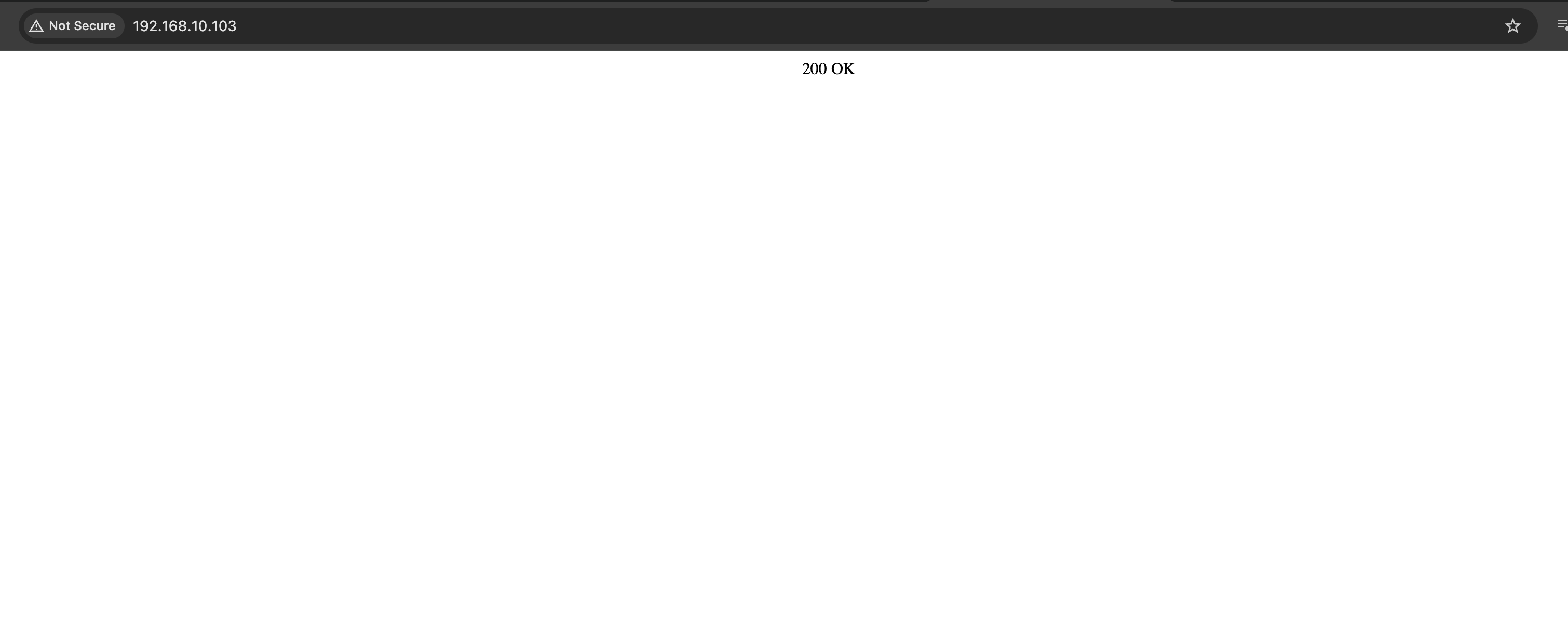

  • When I enter the server’s static IP in my browser, I only get a plain “200 OK” response, no UI (picture below) and unable to access network shares.

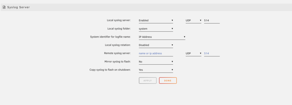

I'm sorry if I'm wrong but there is no new log generated when I could not access to Unraid via web browser
My Unraid has 2 NICs
  • One is 10.10.66.88 which i dont use very often, it just a NIC to connect Unraid directly to my Mac when i need to do 10Gbps highspeed task
  • Another is 192.168.10.103, which is connected to my router, and this is where the problem is. I could not access to my server by this IP, either web browser or SMB

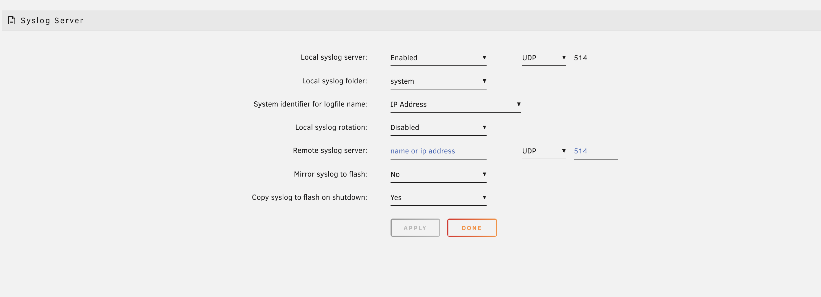

zunserver-syslog-20250705-1035.zip
Edited by zunzun951218
You need to input the local server IP on the Remote syslog server field, see the linked instructions.
Oh i got it. Thanks. I'll be back after the problem happen again
