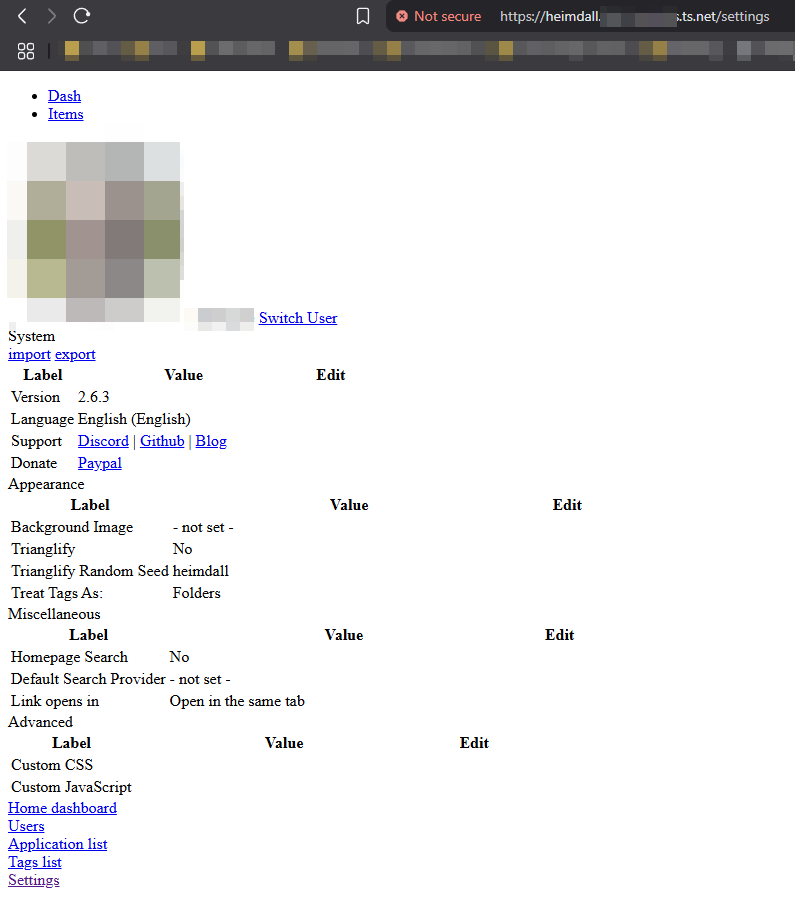

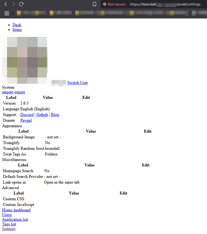

I have attempted to change the Tailscale Serve Port from 80 (the default) to the NGINX configured port of 1080.
This results in a redirect from http to https with a security warning saying the connection is not secure (but it says the certificate is valid?):
And the page itself is a malformed HTML version of the page showing just basic text and no CSS formatting.

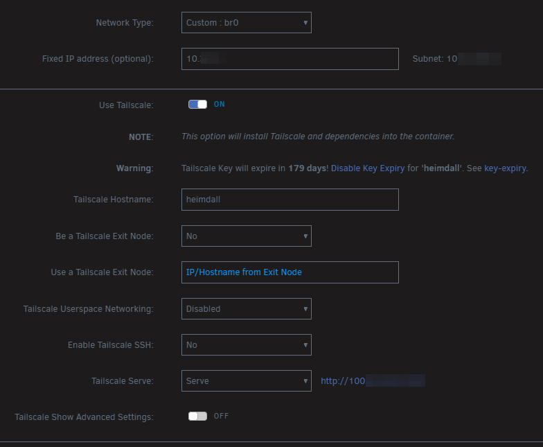

Ah more background may be needed for some context.
I am using a custom network and assigning an IP to the heimdall docker instance. As I do for Ombi which works just fine.
Heimdall is the tailscale hostname, and Serve is selected for the serve option:
It creates a separate machine with a reserved IP and does not tie it to my unraid host.
