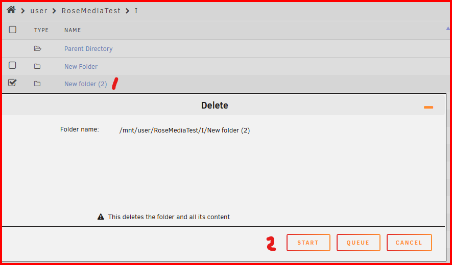

Perhaps I don't understand the problem. You already are getting a second chance to not do the wrong thing! See below:
sudu is intended to allow a login to be handle as a user without administrative privileges but to be elevated to have them when necessary. What makes you think that that simple act would stop you from doing the wrong thing when you already have two opportunities not to do it. When you are in the GUI, you already are logged in as 'root' which is the ultimate Super User on any operating system! (I do a lot of file deletion management from the GUI and I always stop and make sure I have the right files/folder BEFORE I click on 'START"!!! And it that choice is not a default as I have to move my mouse to and click on it.)
