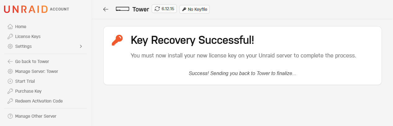

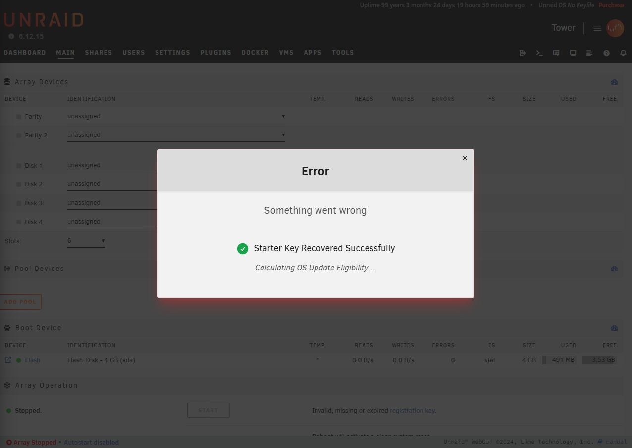

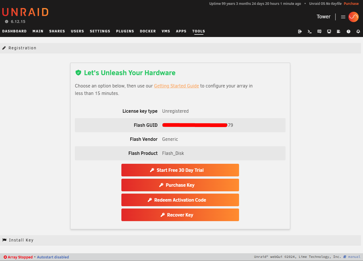

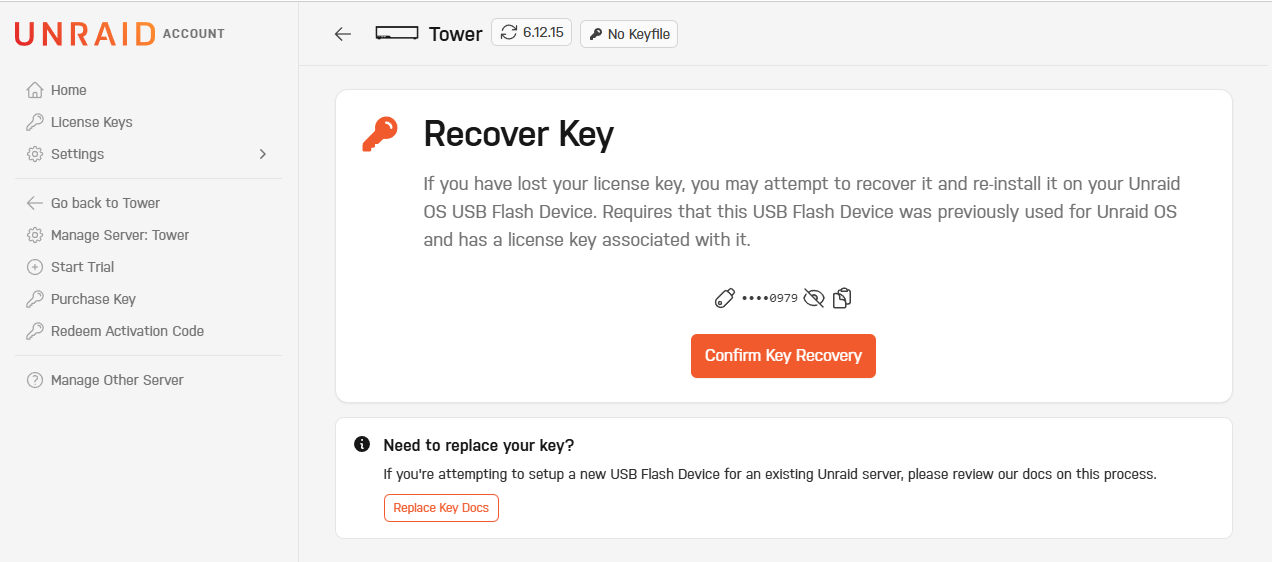

July 13, 2025Jul 13 I am currently trying to set up my LincPlus LincStation N2 NAS, which has a single 2TB Western Digital Red SN700 NVMe SSD installed. Here’s a summary of what I’ve done and the problem I’m facing:Steps TakenInitial Setup: Installed the NVMe SSD and powered on the NAS.Trial Activation Failed: Tried to activate the 30-day Unraid trial, but it failed with an error.Activated 1-Year License: Used the 1-year Unraid license that came with the NAS, but the same error appeared.Reset and Reboot: I have already reset and rebooted the NAS multiple times, but the issue persists.What Happens in the Web InterfaceI log in to the web interface at tower.local.Since I already used the Redeem Activation Code step, I now use the Recover Key option.I click the Confirm Key Recovery button.The system shows Key Recovery Successful.Then, during the "Performing Actions" window (which says not to close the window), it suddenly displays:ErrorSomething Went WrongStarter Key Recovery SuccessfullyCalculating OS Update EligibilityAfter this, nothing else happens. If I close the window, the Array Operation section still shows:"Stopped."The START button is inactive."Invalid, missing or expired registration key" is displayed.Log OutputThe log repeatedly shows these two lines: Nov 7 11:13:34 Tower emhttpd: error: get_key_info, 600: Invalid argument (22): stat: /boot/config/Trial.key Nov 7 11:13:34 Tower emhttpd: error: get_key_info, 600: Invalid argument (22): stat: /boot/config/Starter.key
July 14, 2025Jul 14 Community Expert Solution 9 hours ago, oromis said:Nov 7 11:13:34 Tower emhttpd: error: get_key_info, 600: Invalid argument (22): stat: /boot/config/Trial.key Nov 7 11:13:34 Tower emhttpd: error: get_key_info, 600: Invalid argument (22): stat: /boot/config/Starter.keyThis means the key files are invalid, likely 0 bytes. Make sure the server data and time, including the time zone, are correctly set, and try installing the key again. If it still fails, do a manual key install, copy it to the flash drive /config folder, then reboot.
July 14, 2025Jul 14 Author 26 minutes ago, JorgeB said:This means the key files are invalid, likely 0 bytes. Make sure the server data and time, including the time zone, are correctly set, and try installing the key again. If it still fails, do a manual key install, copy it to the flash drive /config folder, then reboot.Yes, I found the problem yesterday. It was the date, year 2107. Thanks!
