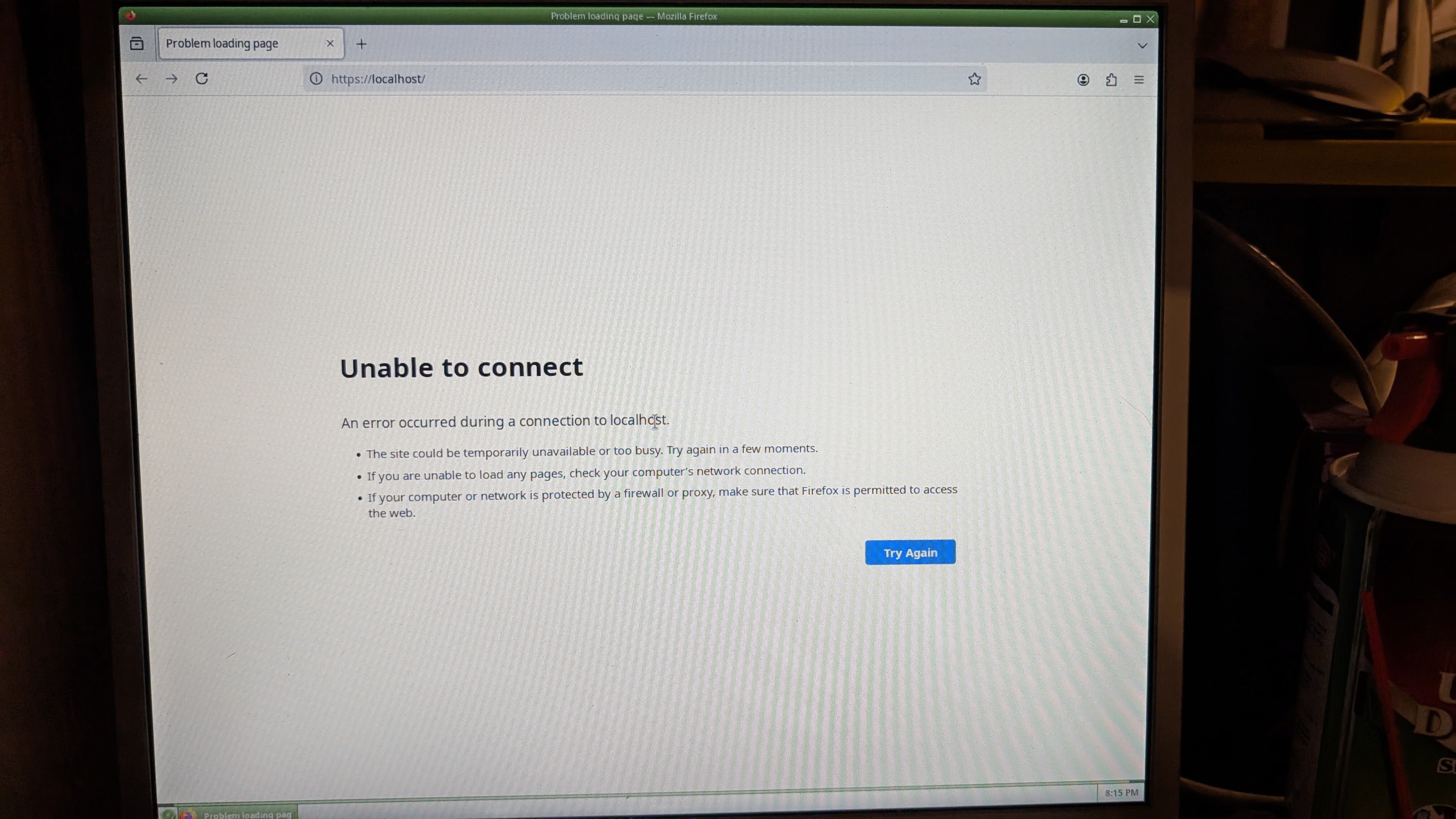

No localhost when booting unraid GUI
https://www.reddit.com/r/unRAID/comments/1m1ttue/unraid_lost_internet_connection_now_wont_boot/
This is my post on reddit. Essentially i noticed some of my containers that i have reverse proxied weren't available online. I started digging and am now at the point where i restored my flash drive from a backup from unraid connect. It will boot into gui mode (it would only boot to safe gui mode before restoring the backup) but now i get unable to connect to the localhost. My Unifi UDM Pro can see the server on the LAN, but there is zero traffic moving up or down.
I've attached my syslog from the last boot before restoring the drive.
Before restoring the drive, if i were to let it boot normally, it'd get stuck on the line update_services: queue new job 3, wait for 20s
I let it sit there for over an hour and nothing happened.
Thanks for any ideas!
syslog
So i think i've narrowed it down to an issue with my LAN card. I have local access to the server, but it won't connect to the internet. I'm not sure what I did...
Luckily I have my gaming rig that I haven't used in a year so I fired it up and everything seems to work fine. I just need to move my HDD's over and rebuild everything.
