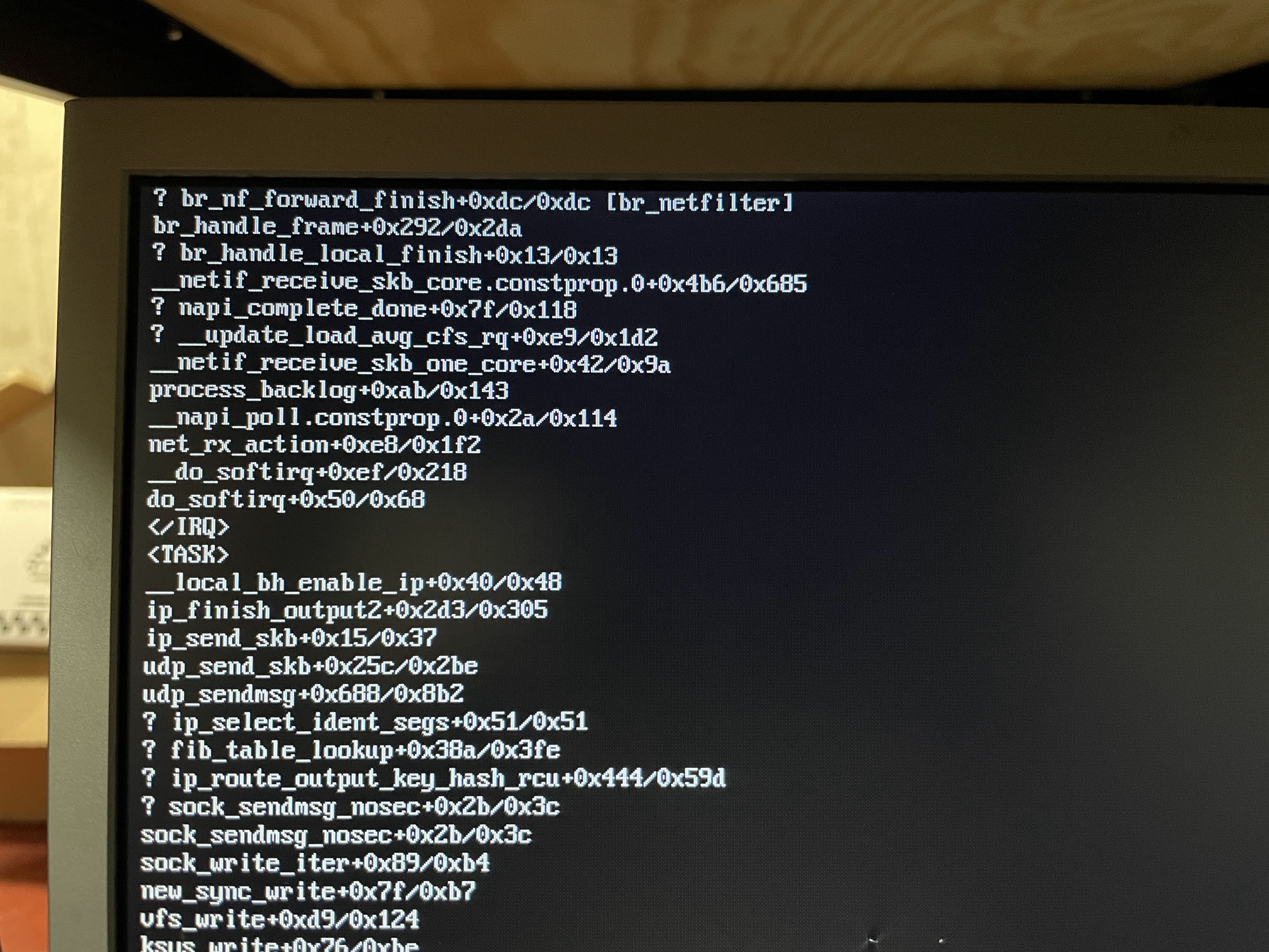

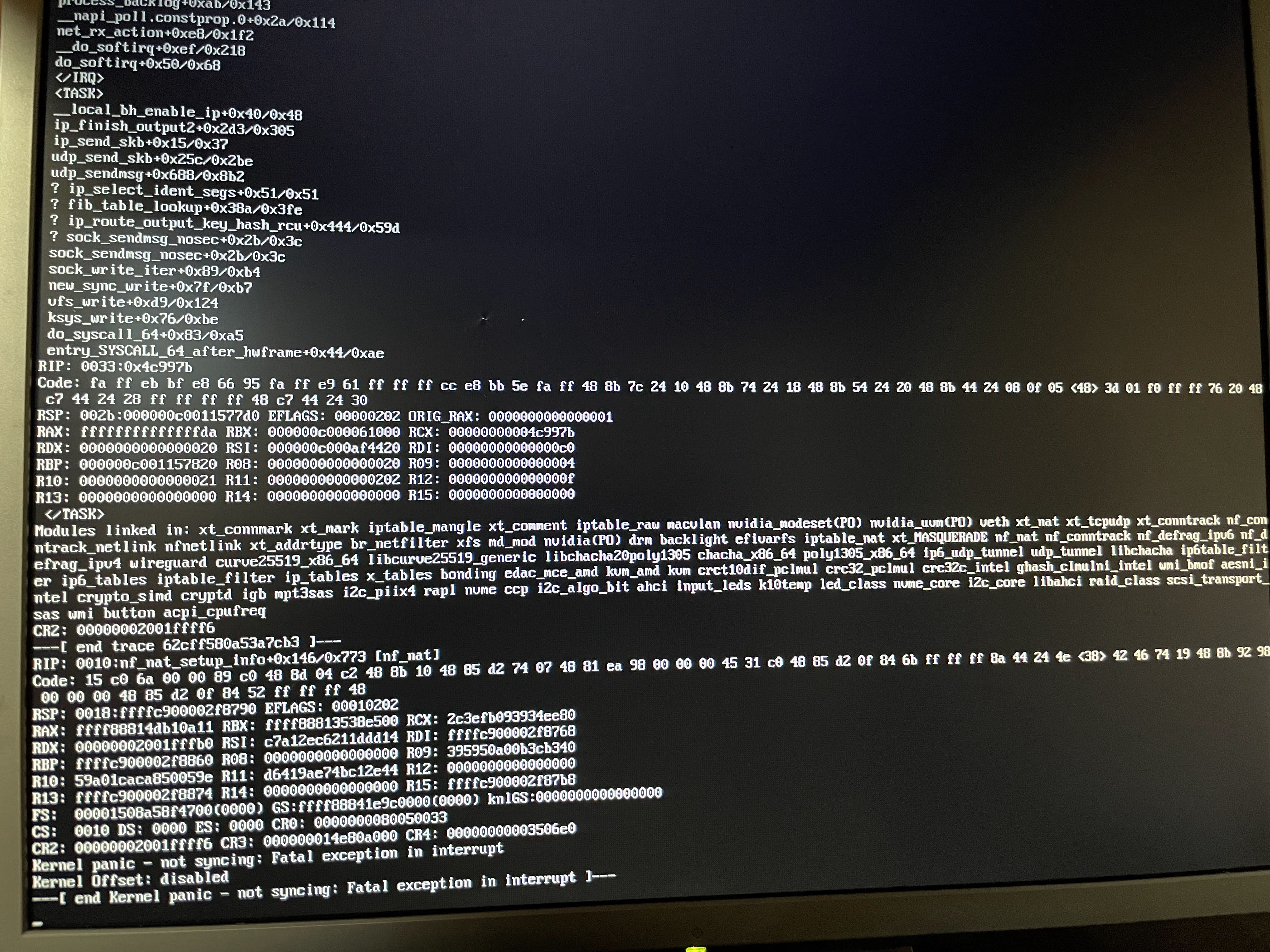

  13. I use unraid mostly for Plex and have been having issues with unraid locking up and not responding. I spend a lot of time on the road so i notice it when i go to watch something and plex isn't available. It's happening more and more frequently. The only fix i have for now is to have the wife do a hard shutdown. I had her take some photos of the monitor that i plugged in since this has been happening. I thought it was the C state on the BIOS settings but unraid is still crashing even after i disabled it. Any help would be greatly appreciated!
