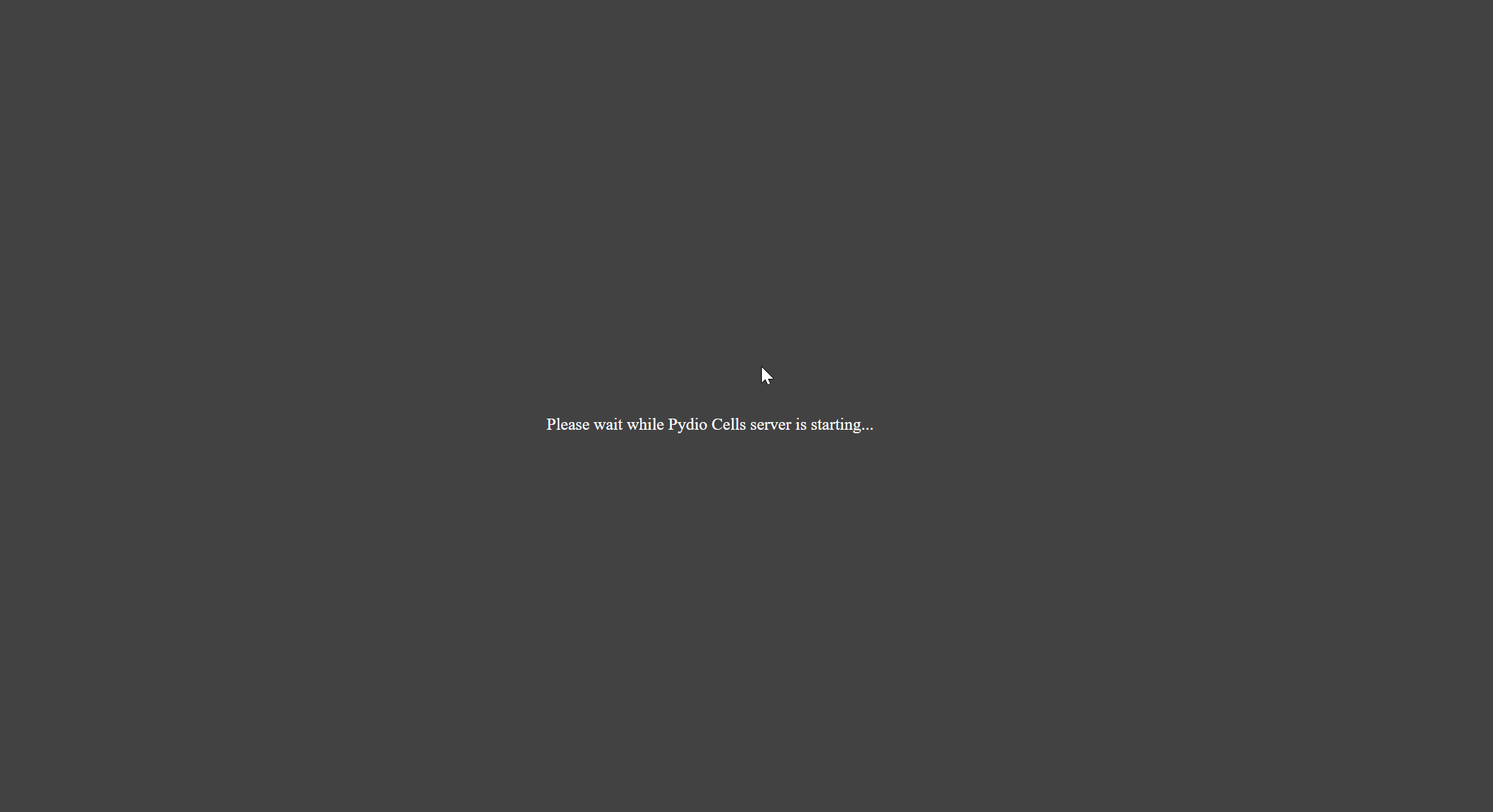

September 30, 20206 yr Did someone manage to get it working? After the setup it just hangs at "loading" and after a restart it's refusing the connection completely. The logs show some errors, maybe we can find the problem in there somewhere.

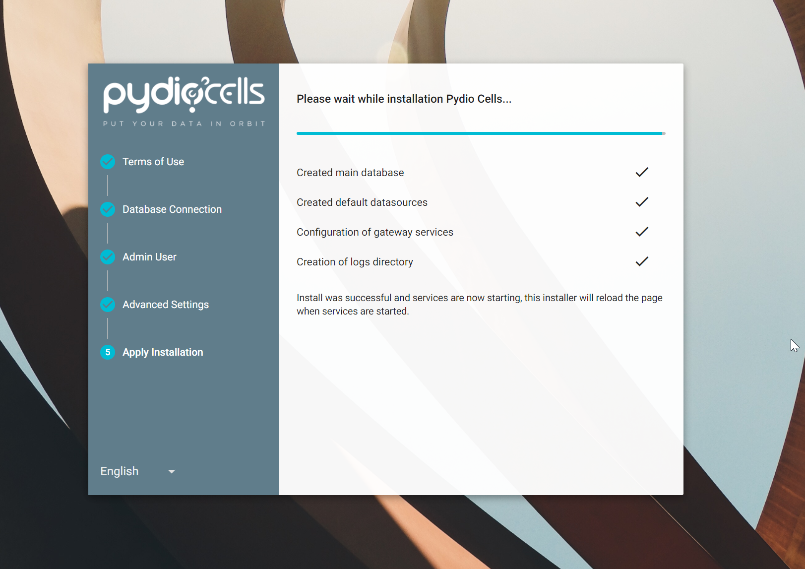

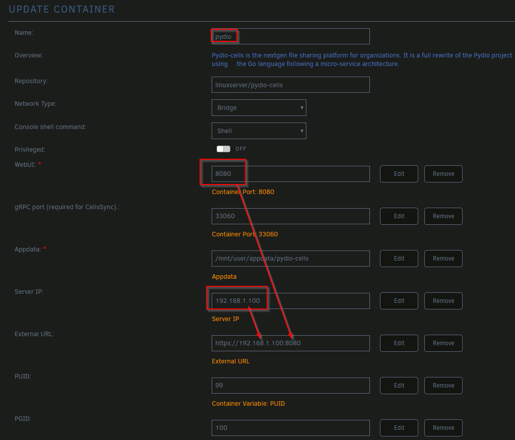

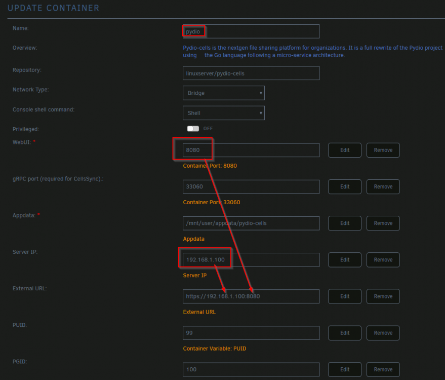

November 6, 20206 yr I managed to get it to finalize the installation process (behind a reverse proxy with NginxProxyManager) using the full protocol:fqdn:port in the "External URL:" field (eg. https://www.example.com:443) . After that there were issues with creating files and folders in its minio storage backend. I fixed those by changing the name of the container from the default pydio-cells to pydio. It seems that the pydio.gateway.rest hostname is hardcoded in the application and it fails to resolve the bundled minio nodes if you use another hostname, which leads to errors like: 2020-11-06T21:18:44.069+0300 [31mERROR[0m [32mpydio.rest.meta[0m Rest Error 404 {"error": "{\"id\":\"undefined\",\"code\":403,\"detail\":\"Unknown data source\",\"status\":\"Forbidden\"}"} 2020-11-06T21:14:04.292+0300 [31mERROR[0m [32mpydio.rest.tree[0m Cannot find DataSourceInfo for pydiods1 {"error": "Could not find DataSource pydiods1"} The lead for the hostname idea is this post: https://forum.pydio.com/t/datasources-are-not-found/3223 Hope this helps!
November 11, 20206 yr I was seeing the same issues as everyone else. I have it working now. 1. have a custom domain like "pydio.example.com" 2. use NginxProxyManager with LetsEncrypt so that requests for pydio.example.com go to my pydio port (8080, but it should work with other ports) 3. Force HTTPS 4. have a mariaDB instance ready to use with pydio-cells. That should be enough to get through the setup. It doesn't seem possible to run without without a custom domain and https. If at some point in the future you need to change the domain name or the unraid server IP adddress. Just update it in the config at "/mnt/user/appdata/pydio-cells/pydio.json"
December 9, 20205 yr I have yet to get this started. Getting stuck on this screen. Also the below page never reloads. Stays stuck at that setup I have let this run for about 20 min with no results. Anyone have a suggestion?
December 30, 20205 yr On 11/6/2020 at 1:38 PM, thenoots said: I managed to get it to finalize the installation process (behind a reverse proxy with NginxProxyManager) using the full protocol:fqdn:port in the "External URL:" field (eg. https://www.example.com:443) . After that there were issues with creating files and folders in its minio storage backend. I fixed those by changing the name of the container from the default pydio-cells to pydio. It seems that the pydio.gateway.rest hostname is hardcoded in the application and it fails to resolve the bundled minio nodes if you use another hostname, which leads to errors like: 2020-11-06T21:18:44.069+0300 [31mERROR[0m [32mpydio.rest.meta[0m Rest Error 404 {"error": "{\"id\":\"undefined\",\"code\":403,\"detail\":\"Unknown data source\",\"status\":\"Forbidden\"}"} 2020-11-06T21:14:04.292+0300 [31mERROR[0m [32mpydio.rest.tree[0m Cannot find DataSourceInfo for pydiods1 {"error": "Could not find DataSource pydiods1"} The lead for the hostname idea is this post: https://forum.pydio.com/t/datasources-are-not-found/3223 Hope this helps! Thanks! I've been struggling to create a local environment for a week, and had neglected to check the forums. This wasn't the exact fix for me, but it go me on the right track. I ended up - changing the Name to pydio, as per your recommendation - leaving the WebUI port at 8080 - manually setting Server IP to the IP of my Unraid server, while creating this container in Network Type: Bridge mode - creating the External URL with https://[Server IP]:[WebUI Port] Screenshot of what worked for me attached. Thanks again!

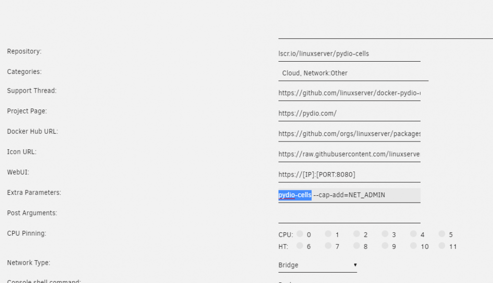

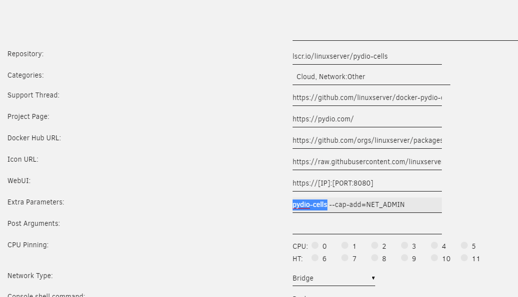

January 14, 20224 yr I am getting the same error as the person above me. @linuxserver.io removing pydio-cells from extra parameters fixes this Edited January 14, 20224 yr by BoKKeR
January 26, 20224 yr On 1/14/2022 at 12:39 PM, BoKKeR said: I am getting the same error as the person above me. @linuxserver.io removing pydio-cells from extra parameters fixes this There are no extra parameters by default? Can you expand on your fix, in detail, please?
January 26, 20224 yr 11 hours ago, boomam said: There are no extra parameters by default? Can you expand on your fix, in detail, please? Sure there is! A linuxserver.io mod has said it would be fixed "upstream" but I dont think it happened, remove the blue part . Check if you have advanced view enabled Edited January 26, 20224 yr by BoKKeR
January 27, 20224 yr Completely forgot about that advanced button. 😛 Thanks! that appears to have resolved it.
