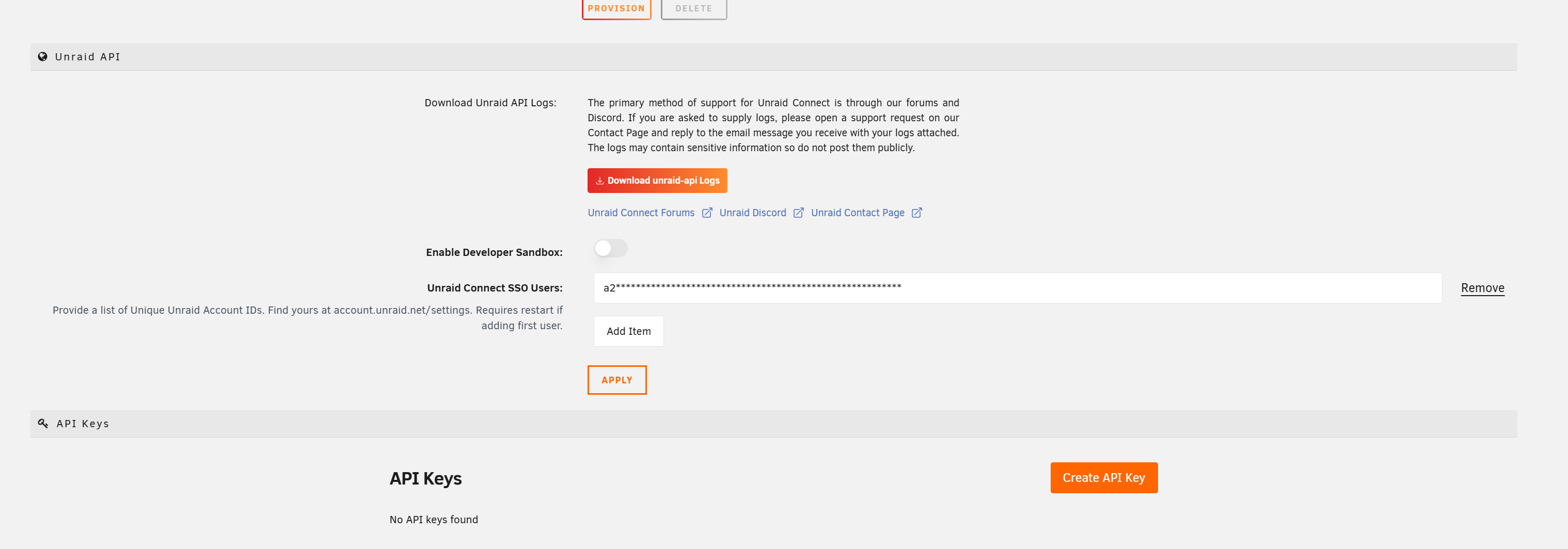

I'm at unraid 7.1.2. just installed unraid connect plugin and entered my "SSO users". it seems to be the right number.

Do I need to do the API also?
It looks possible that your Connect client isn't installed. Please reinstall the plugin if possible and let me know if you see more options in that menu (flash backup, etc.)
Running this command via terminal could help:
unraid-api plugins add unraid-api-plugin-connect -b
if it doesn't, could you provide the versions of your connect plugin and the api? unraid-api versionwill get you the latter.
I reinstalled it and that worked, not sure why the first install was bad, maybe I closed the window too early?
Thank you all :)
