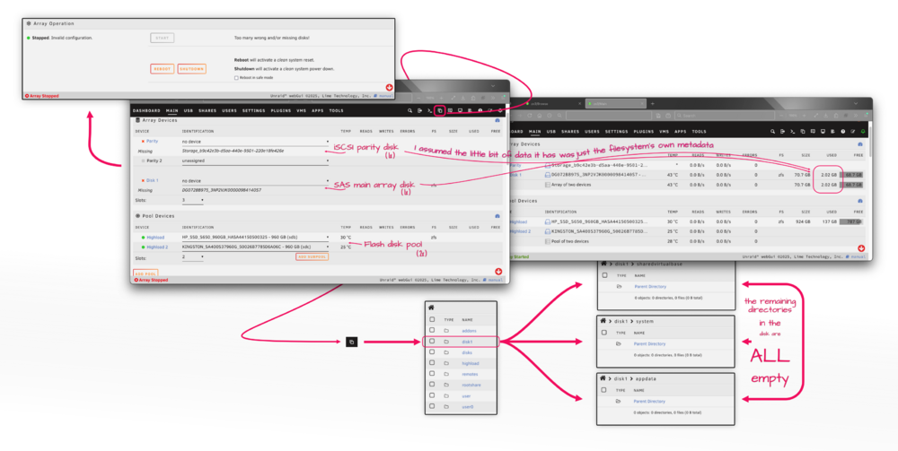

The server was initially configured with an Unraid array, which I cannot get rid of. In the GUI, unless hidden files are, well… hidden, the Unraid array appears to be empty already but when I remove it from the system it tells me too many disks are missing or something like that as if there was something in the array it needs.
I took a few screenshots to help me illustrate my point:

If you want to remove the main array then make sure the number of slots is set to 0.
If that is not your issue then post your system's diagnostics zip file so we can see your setup.

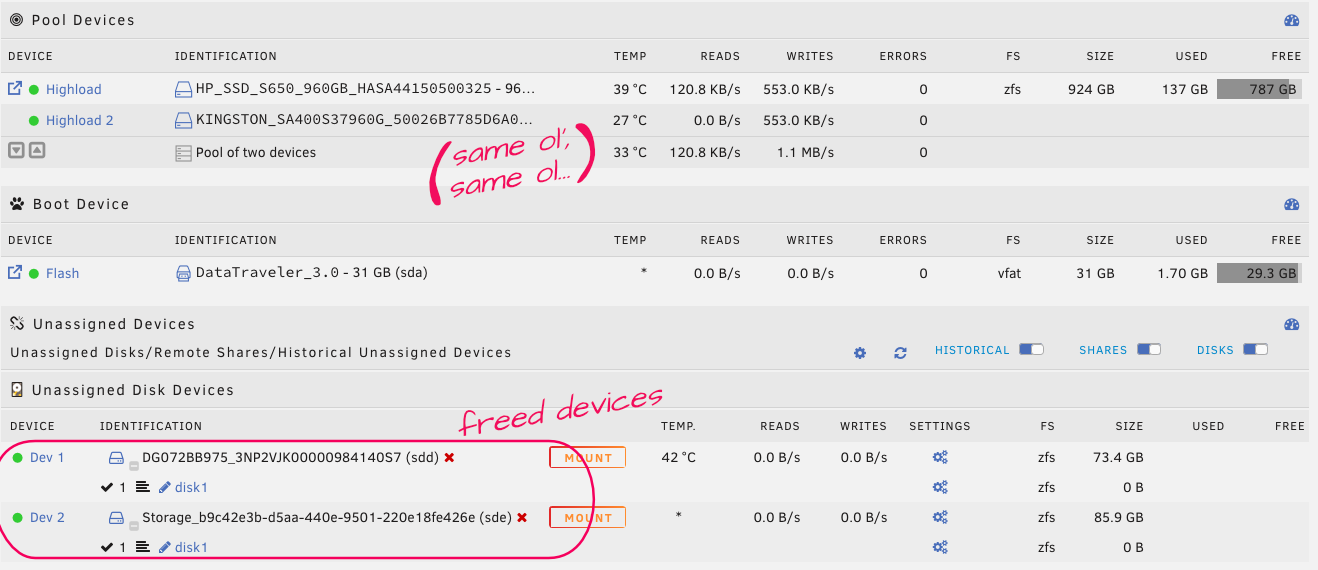

Thanks but I figured it out,
I used the New Config tool, preserving the pool assignments. It was the scariest button I've had to click in quite a while but it paid off. The array was startable (and was started) right away. VMs are coming online as I type this.
