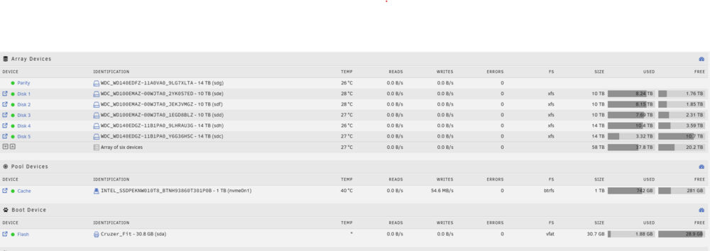

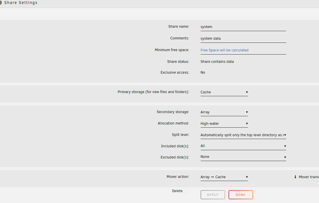

I turned off Docker and VMs and ran mover again. Here are my settings:

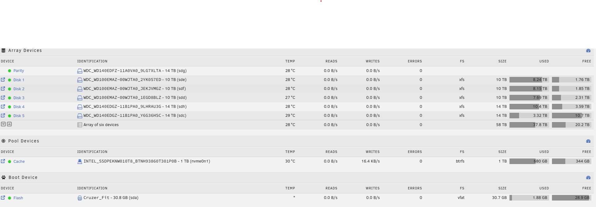

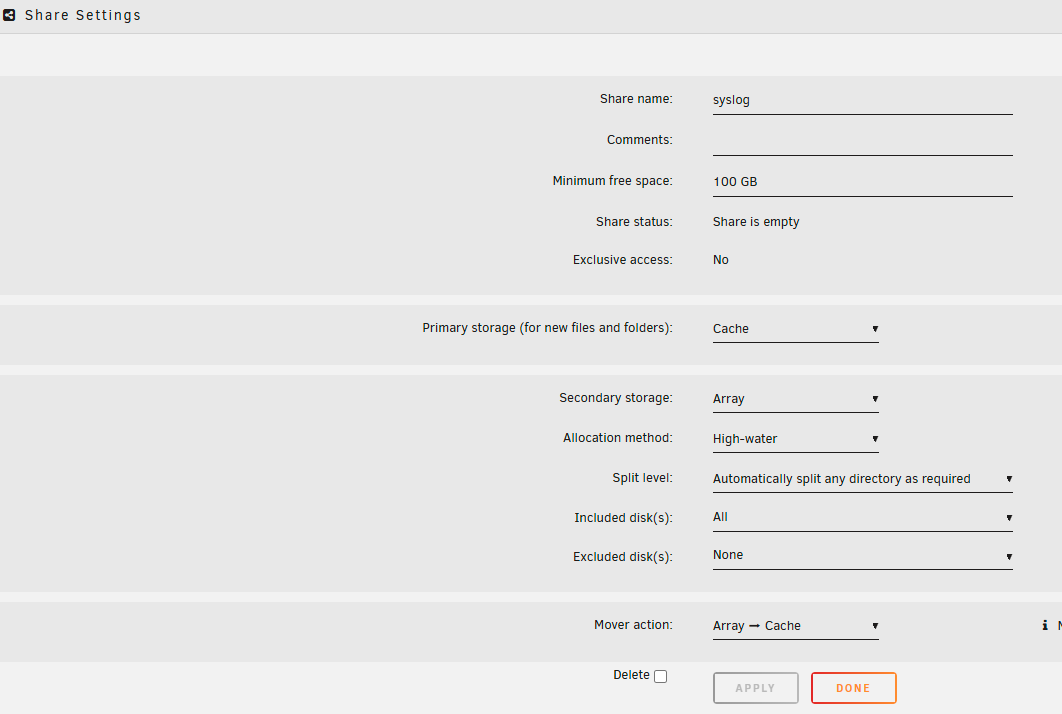

Settings changed here is current:

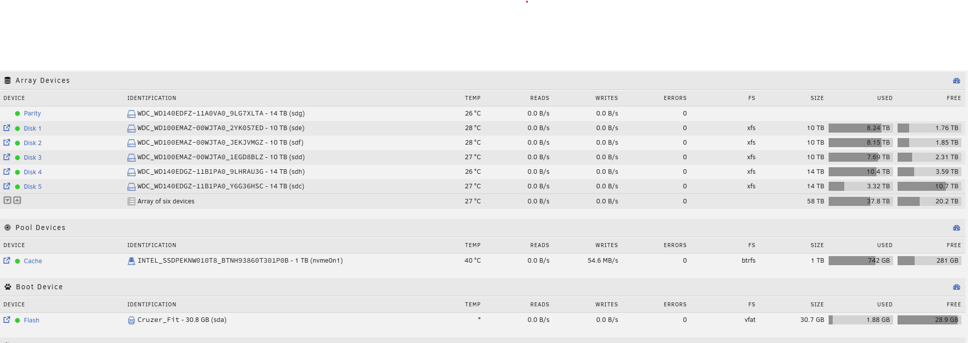

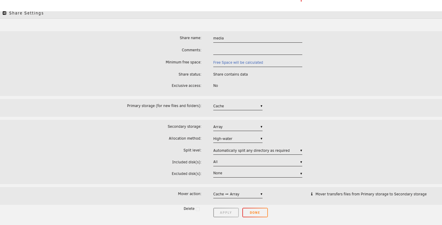

Added inline comments and screenshots. New Diag attached. Mover still not moving files. (Even tried with VMs and Docker turned off) I emptied recycle bin so the size has gone down.

It's a capitalization issue; delete /boot/config/shares/Media.cfg, then reapply the share settings for media.
Feel kinda goofy about that... I cant tell you how many times I looked at that and my brain didn't actually catch it. Thank you sir.
