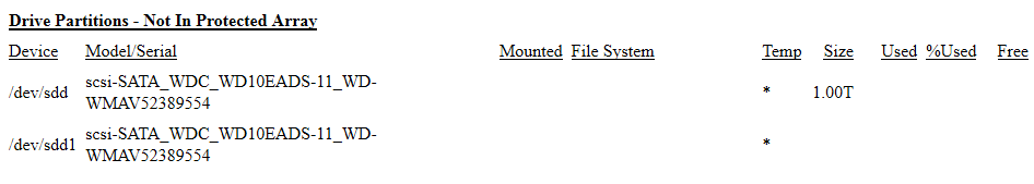

It was precleared on a different machine, if that matters. The odd.png image is something I've not noticed before.
See syslog.

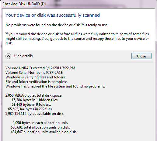

Run check disk on the flash.
reiserfsck --check /dev/sda
where sda =  flash disk?
not exactly.
Easiest for most is to move the flash disk to a windows PC and run chkdisk on it there.  The flash drive does not have a reiser file system, therefore using reiserfsck on it would not be helpful.
Joe L.
Thanks. I'll try when I get home later tonight.
Here's the result.
And no issues (thus far) adding another disk.

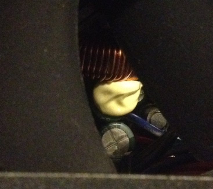

I wonder if this CX500 v2 is hosed. It has the same output stats as the CX500 in my main server, which is running fourteen disks. Without a hiccup. :'(
EDIT: I can see a light colored goo on top of one of the caps.
The cream colored "goo" looks like glue to stabilize/hold the toroidal coil that is immediately adjacent (keep it from vibrating).  It is not an indication of a failure.
On the other hand, if you are referring to the bottom of the capacitor, where there is some discoloration, and it almost looks like some bulging on the top of the capacitor, that could be an indication of a bad capacitor.
Moving back to SOLVED.
It appears as though the PSU was my problem, even going back weeks and weeks to my previous issues.
Good deal. One of the capacitors did look like it had a bulge on the top.
