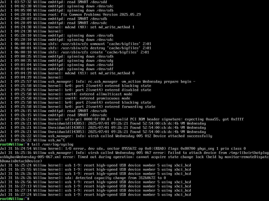

July 31, 2025Jul 31 HiI noticed today that my Nextcloud instance was no longer reachable. I tried logging into the unraid UI to see why, but it results in an "Unable to Connect" error.Strangely, my Plex and Lyrion Music Server Dockers remain working fine.I was running a Win 11 VM (named Wednesday), and had used a Powershell script to schedule its shutdown for 10 mins in the future before I noticed the problem with Nextcloud, so I was wondering if the problem could be a hanging VM. (I use that script all the time without problems)I can use my BMC to get to the Unraid terminal, so I tried the command:virsh stop WednesdayBut it returned the error:error: failed to connect to the hypervisorerror: failed to connect socket to 'var/run/libvirt/libvirt-sock' : Connection refusedSo I trieddiagnosticsand get-bash: diagnostics: command not foundsimilarly when I trypowerdownI get-bash: powerdown: command not foundso I tried:cp /var/log/syslog /boot/syslog.txtand getcp: cannot create regular file '/boot/syslog.txt' : Input/Output errortopgets-bash: top: command not foundWhat can I do?What has happened?Thanks for your help. Edited July 31, 2025Jul 31 by jademonkee
July 31, 2025Jul 31 Author tail and cat seem to still work. See attached screenshot for the output of tail.The time for when the machine froze aligns with. the timestamp seen in the log.If anyone knows how to get more of the syslog, let me know.

August 1, 2025Aug 1 Community Expert Solution Jul 31 16:24:53 Willow kernel: usb 1-9: reset high-speed USB device number 5 using xhci_hcdJul 31 16:24:54 Willow kernel: sd 0:0:0:0: [sda] tag#0 UNKNOWN(0x2003) Result: hostbyte=0x03 driverbyte=DRIVER_OK cmd_age=30sJul 31 16:24:54 Willow kernel: sd 0:0:0:0: [sda] tag#0 CDB: opcode=0x28 28 00 00 88 a7 18 00 00 08 00Jul 31 16:24:54 Willow kernel: I/O error, dev sda, sector 8955672 op 0x0:(READ) flags 0x80700 phys_seg 1 prio class 0Flash drive issues, though I cannot say if it's the flash drive or the USB controller, you can try a different USB port first; if the same, replace the flash drive.
