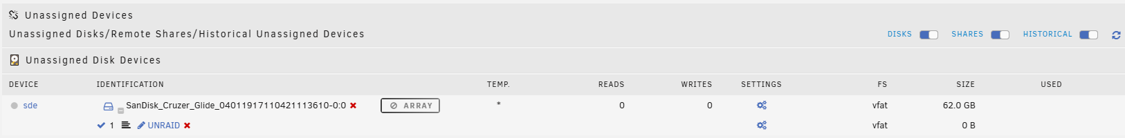

Recent change was binding IOMMU group 14 to VFIO so I could get MB Audio passthrough to my VM. My USB stick is plugged in to the internal port, could that have caused this?
I'm not going to try changing anything until I hear back.

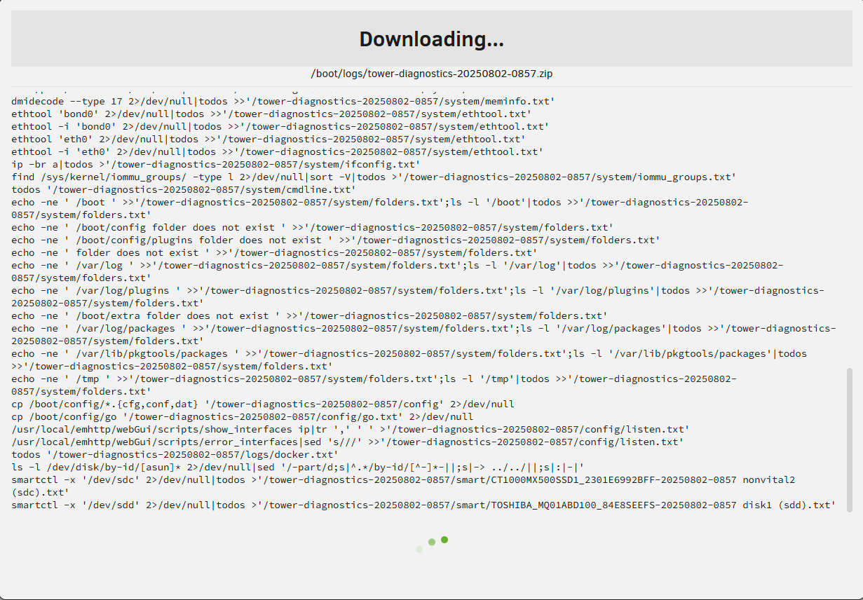

I tried to download diagnostics and got the following
image.png:
Before the download starts it switches to this page:
