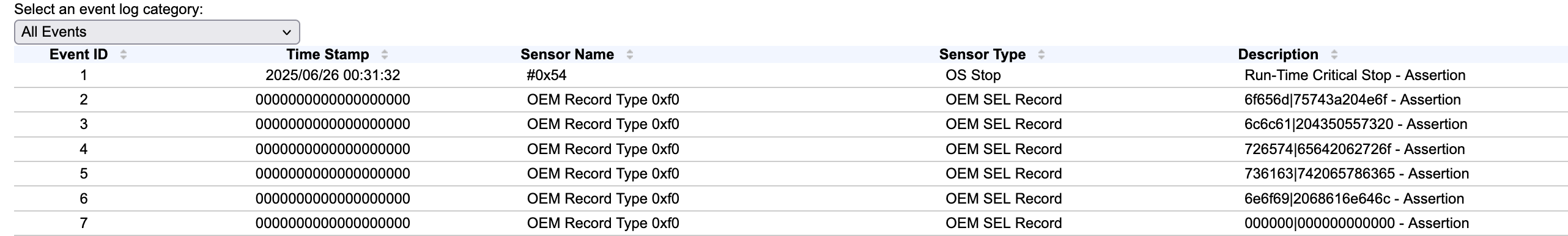

It died again at some point this morning. Interestingly, this time there does seem to be something in the IPMI health event log, but the error codes don't mean anything to me, so not sure it's very helpful. Screenshot attached.
Successfully did a memtest pass with no issues. Going to try disabling PiHole now and see if that improves things...
Me neither, but Supermicro support may be able to help.
