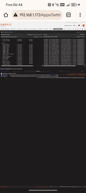

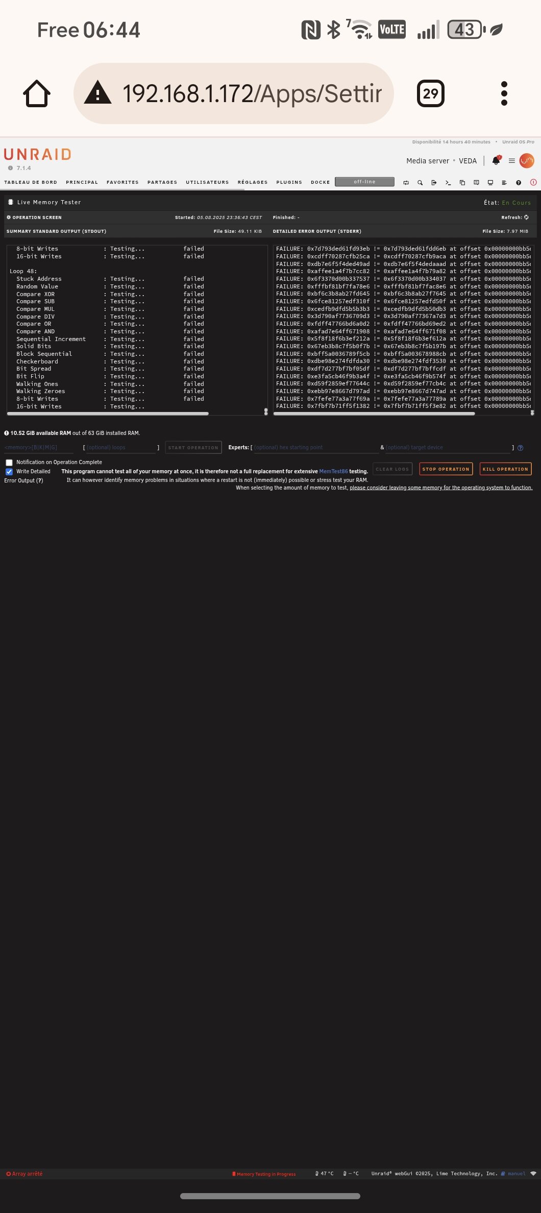

August 6, 20251 yr Author It looks like the memory is failing a lot.With this information, next step is to change the memory sticks? Or is there other tests to run?

August 6, 20251 yr Community Expert 1 hour ago, Daaadou said:next step is to change the memory sticks?Yep, you can try to test one at a time to find the bad DIMM, typically there's only one.

August 7, 20251 yr Author Hello, It is solved, I had one bad RAM stick as you thought. I needed to plug a monitor in to troubleshoot properly but I have been able to identify the culprit thanks to the built in memtest plugin, very useful. I have a question, how can I have access to all the warning etc? The corruption started when I had the first message of the cache getting full because the mover was not able top empty the corrupted files. I would like to find these messages and I will suppress all files copied on the NAS since then. How can I find that info ?
