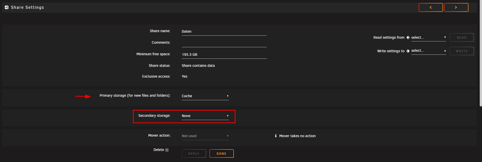

August 6, 20251 yr 28 minutes ago, Bjur said:Can I just create a customer folder in the root of the cache drive, since the cache drive is always running and I dont want my array drives to spin up all the time.sure, it will then create a Share (automatically), set this to cache primary, none secondary (cache only mode) and files will reside there only and wont trigger a disk spinup ...also you can create the Share with these settings and it ll create your folder anyway ;)30 minutes ago, Bjur said:I have a Docker where I want to store some files that should be used for offline mode.but, array must be started if thats the story behind "offline" mode ... cache wont be mounted without array start.

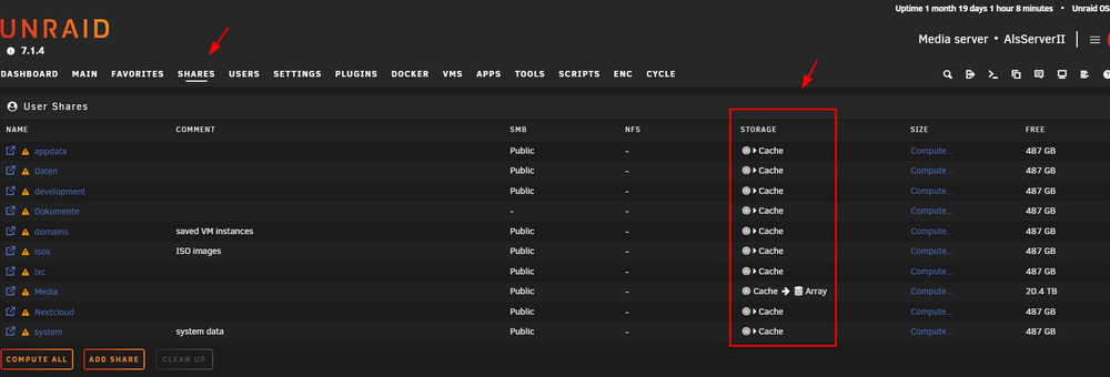

August 7, 20251 yr Solution 9 hours ago, Bjur said:Thanks and I already have the array started just didnt want to spin up array drives all the time.here you see as sample ... i almost only use cache pool Shares ...and how its setupso Shares like this only reside on cache pool and wont spinup any disks in array
