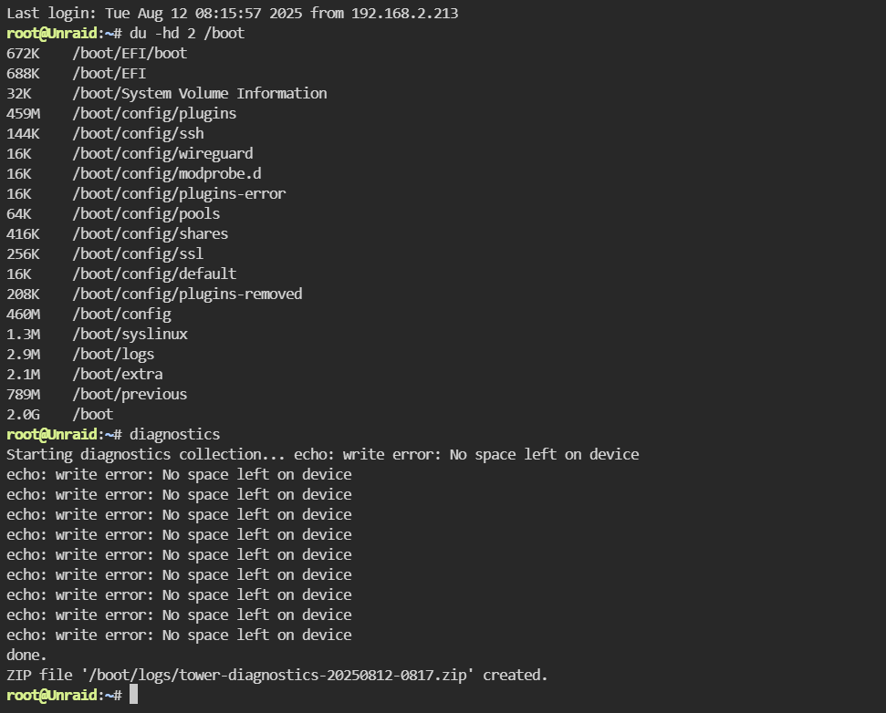

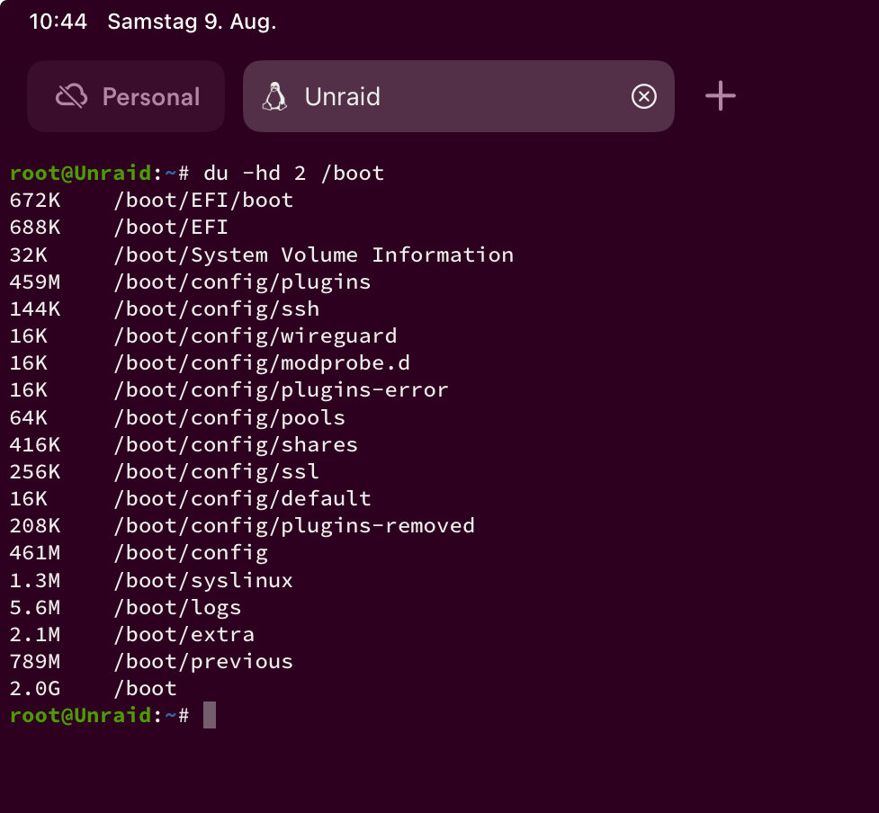

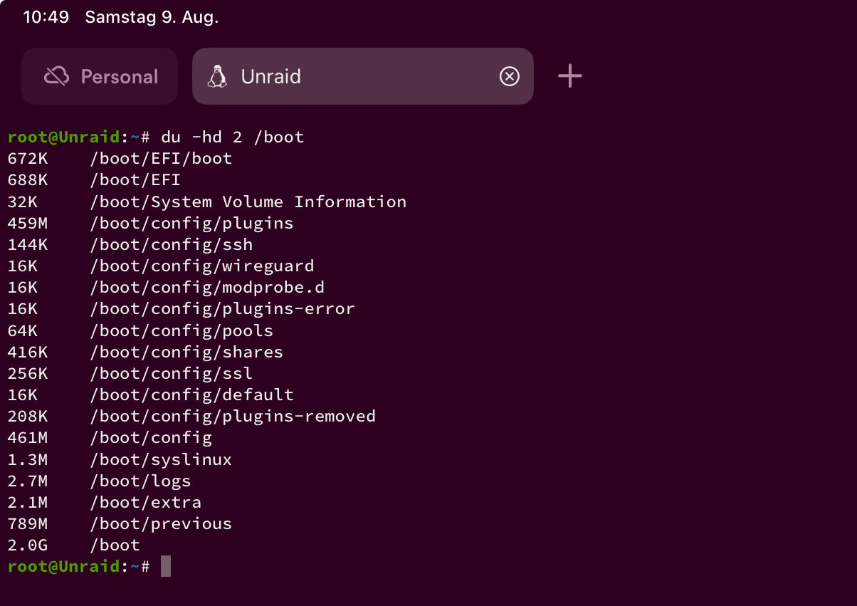

the issue just occured again. I could not login. The login page displays, but when I enter my credentials, the same login page is reloaded rather than displaying the menu/dashboard. nginx -t shows no error. I entered your command. The first screenshot is from the state where I couldn‘t login, the second one after reboot, when the login worked again.
On this screenshot, it doesn‘t seem to be a space error, however in the logs I saw something like „drive full“. Rebooting always resolves the issue.
Edited by nolimits2k
The flash drive's total usage is the same 2 GiB. Where are you seeing that the flash drive is full?
