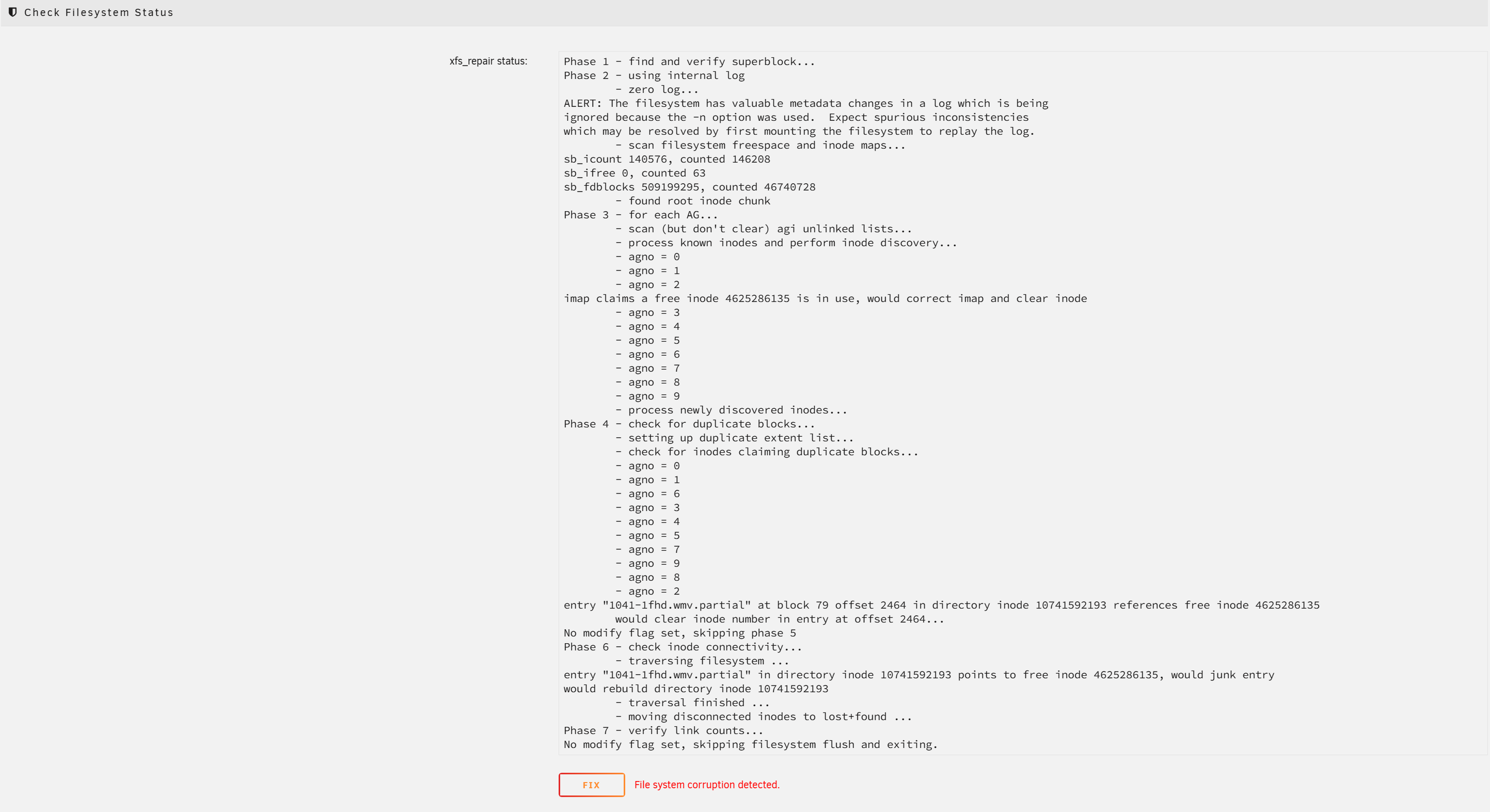

Check filesystem for disk15
Done. Shows that the File System is corrupted and gives the option to fix. Should I proceed?
yes.
Afterwards when you restart the array in normal mode the drive should mount fine.
You might want to check if there is now a lost+found folder on the drive which is where the repair process would put any file/folder it finds for which it could not find the directory entry. Not having this folder is a good sign that things went well during the repair.

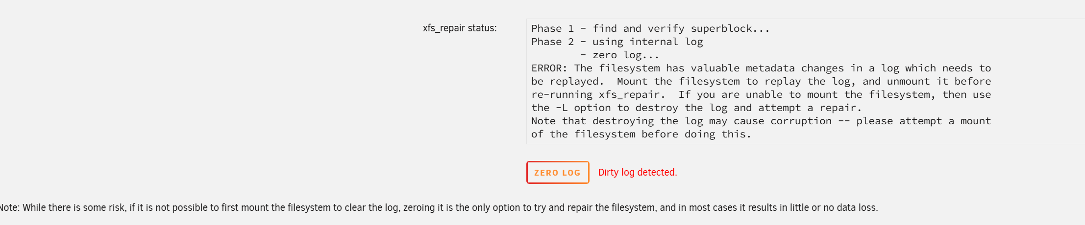

Alright, so now it mentions the log is dirty and wants to zero it, but it says I should attempt to mount the filesystem first to replay it? Some files were put into a temp folder while the filesystem was down, not many though. Could those be what this error message is referring to? Should I back out of this and try to restart the array as normal first before doing this next step?
So, I stopped the array in maintenance mode and restarted the array normally. The disk mounted but said it was at almost 100% utilization. If I go back to the disk to look at check filesystem status, the repair hasn't reset at all and still has the same option before about zeroing the log. Any tips would be appreciated.

You can run using the GUI, CLI was just to confirm if it still needed to zero the log or not, in case the GUI was showing old info.
Finally reran xfs_repair through the CLI. The GUI for check filesystem doesn't seem like it'll refresh itself after taking the array out of maintenance mode.
Anyways, I uploaded the output from the CLI. Seems like it zeroed the log and mentioned moving files to the lost + found, but I didn't see that folder on the disk after starting the array. Everything still checks out okay and that previous warning I was worried about is no longer there. Not entirely sure what caused the issue with reporting the remaining freespace, but I've got a new drive in my server, so hopefully it won't happen again.
