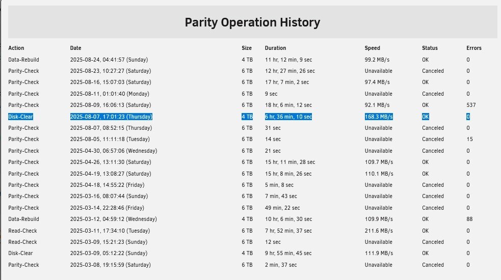

For some time now, I’ve had a problem. One of the drives, specifically the fourth drive, sometimes disconnects (get Unassigned) while the Unraid server is running. And since I’m an amateur, I didn’t shut down the server twice as you suppose to (to get missing disk state),” and then I either re-added it or replaced it with another drive. I only powered down on once, and it seems that instead of a data rebuild, it was doing a disk clear. So my question is: are those data recoverable, since a parity check has already been performed? And today I tried to recover the data from the last parity check, but unfortunately, that drive is now empty.

Possibly the word "clear" should not have been used. Unraid will only clear a disk if it is added to a new data slot in an array that has valid parity. This is so parity will remain valid. Unraid does not clear a replaced disk. And "clear" will take a long time since zeros has to be written to the entire disk, and the webUI will also say that a disk is being cleared. So clear didn't happen unless you added a disk to a new slot, and there shouldn't be any doubt whether or not it was happening.
Did you perhaps format the disk? Many people don't really understand what format means. Format means write an empty filesystem to this disk. Unraid treats format in the parity array exactly as it does any other write operation, by updating parity so it agrees with the write operation. Unlike "clear", Format doesn't take very long. After formatting a disk in the array, the only thing that can be rebuilt from parity on that data slot is an empty filesystem.
Looks like emulated disk4 was mountable when rebuild began, but probably by that point you had already made it an empty filesystem.

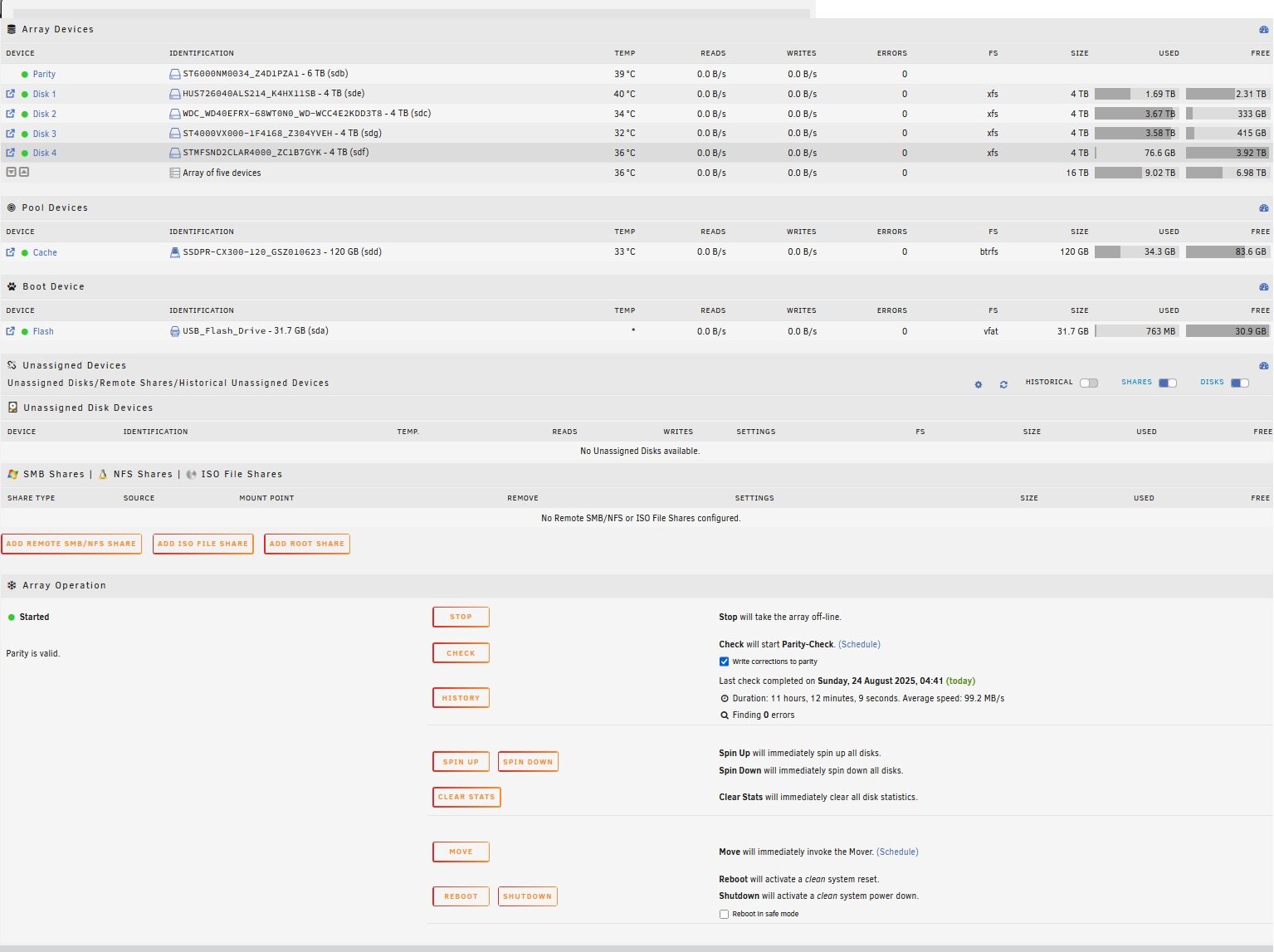

Can't really tell anything about any disk contents since the diagnostics were taken without the array started.
Start the array in normal mode and post new diagnostics.

Those confirm what you already knew, that disk4 is empty.
Did you tell it to format the disk? Format is NEVER part of rebuild.
