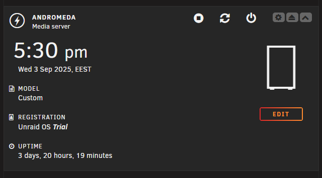

Hello again ! After a few days and some working around the house i had no crashes nor freezing so Frigate was the issue all along. Any Self-Hosted NVR Alternative Tho ?
Thank's for support !
