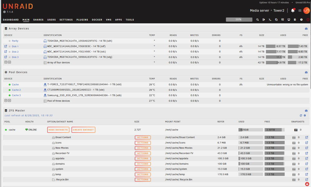

This is a screen shot of my server if it helps
The pool is already imported.
Type zpool export cache and restart the array, then post new diags.
Since the individual shares are mounted I am attempting to copy all the data to the array. Once that is done (if it succeeds) I will do the export again and post the new diags. Weird that the data is all there but the cache pool doesn't mount.
Thanks
Joe
The pool is imported presently, but it was likely manually imported, so the GUI shows unmountable. After a pool export and array restart it should be OK again.
Thank You!!!!
I stopped the array, ran "zpool export cache, started the array, and the cache zpool is back up. I was a little freaked that my dockers and VMs were missing, but I disabled and re-enabled them, pointing them to the cache drive and they came back up. So much thanks. Attached are the diags after it came back in case anyone wants to see. Very weird that I had 2 issues at the same time. A drive in main array went missing and I had to move it to come back up, and I lost my cache pool. I almost never have issues (well unless I change something on it;-).
