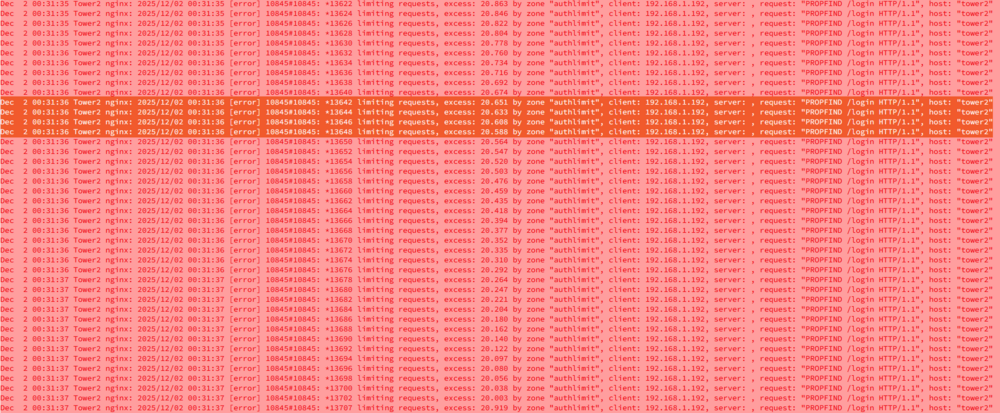

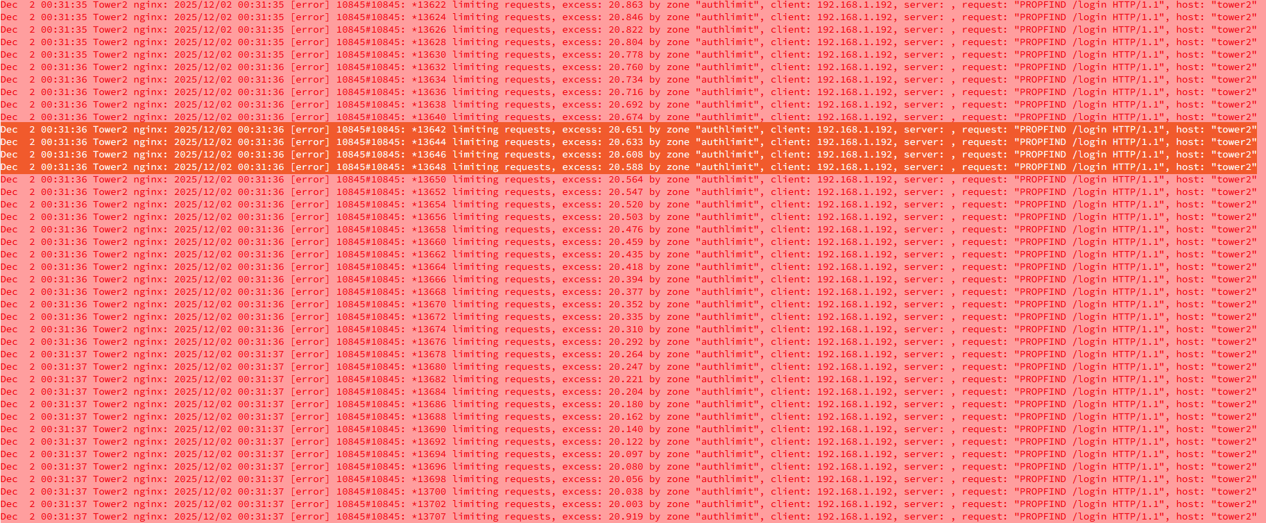

  14. Is there or will there be a fix for the log spam when using root folder "Uploading Attachment...option and possibly be able to use root share and disk shares at the same time? Thanks
  15. After a bunch of searching I am trying to move on from the rootshare under SMB from Spaceinvader as I found many errors relating to it in my logs. I am trying to use the Unassigned Device settings to make a rootshare after removing the code in my SMB settings but when I try to rename Shares-Pools to rootshare it does not work and gives me this error in my syslog but as far as I can tell I don't have that name used as I removed the script from the SMB setttings. I need to use the name rootshare as my VM that does the backups uses that drive mapping to do online backups using iDrive. I would hate to have to go through all the subdirectories and custom files to backup. Thanks unassigned.devices: Error: Device '//TOWER2/mnt/user' mount point 'Rootshare' - name is reserved, used in the array or a pool, or by an unassigned device.
