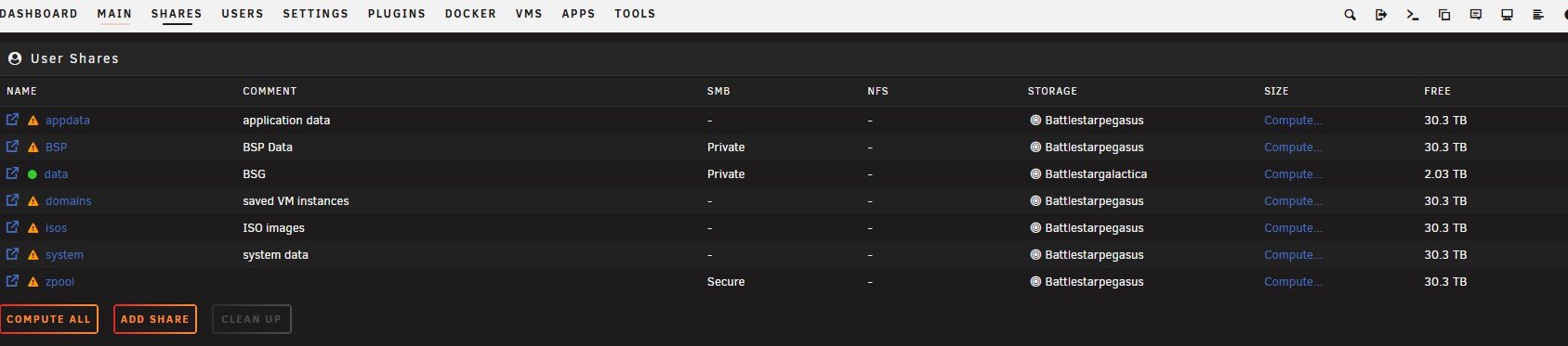

  • attempting to follow an array upgrade video, i went to the "shares Tab' and set the "storage location" of all data to BSP. (Primary storage for new files and folders) - (Move function was executed)

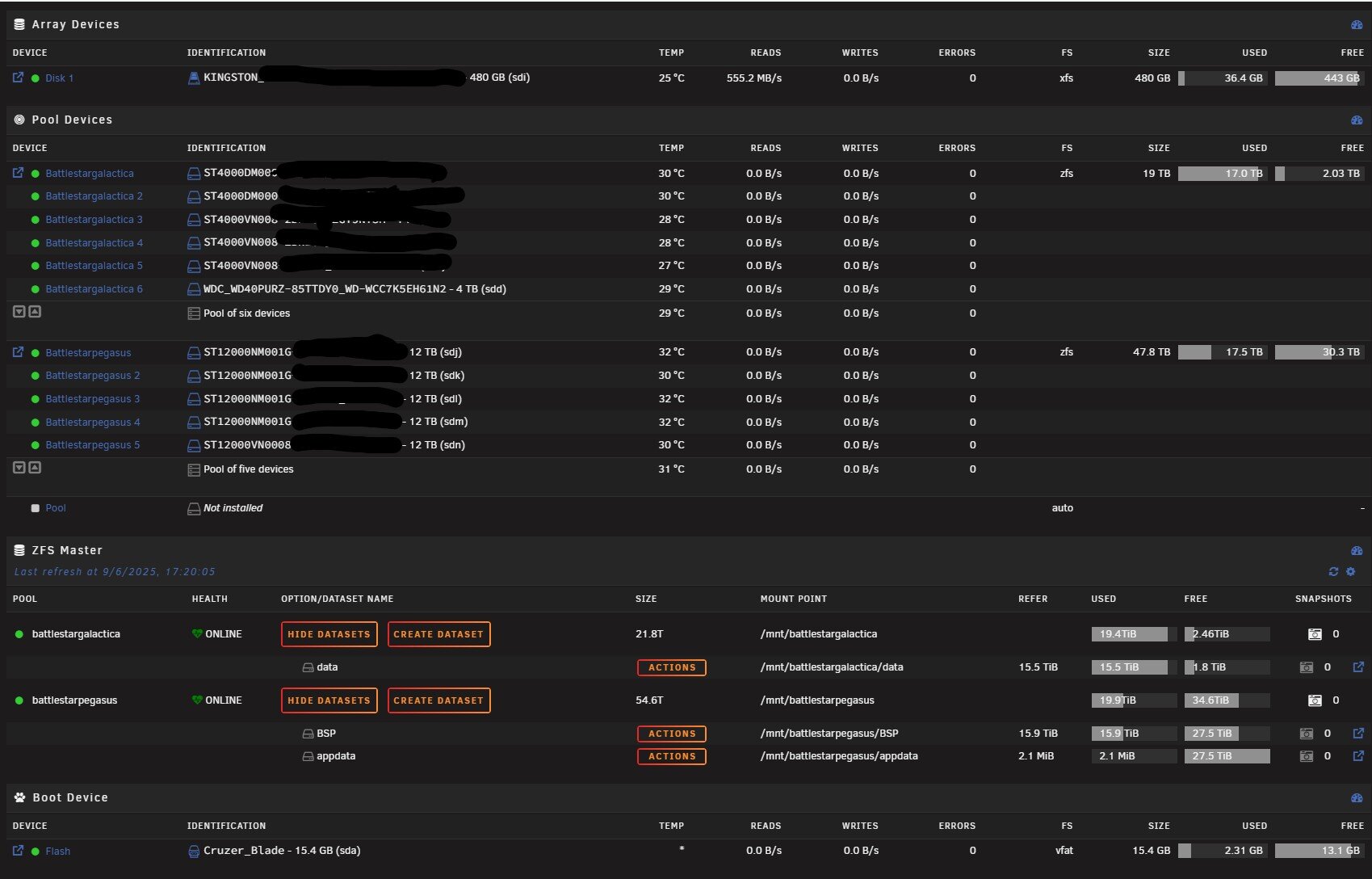

  • once this was complete, i powered down the system and removed the 6 x 4tb hdds. powered back up and now i cant get the array to start. - Error message says Wrong Pool State, BSG - too many wrong or missing devices.
  • i was always of the understanding the "array" was comprised only of the 1 x 480Gb ssd. however this doesn't appear to be the case.
  • Moving forward i want the "array" device to be the 480Gb SSD only. - [Configuration save location is my understanding of what an "array" is ment to be. ]
  • the New ZFS pool "BSP " for all data.
  • the new 1TB SSD to be for VM's
  • and of course the removal of the old 4tb drives.
Click the first pool device and the "remove pool"
Jorge,
It appears to be as easy as that!
Thanks buddy, can i now set the "storage location" back to array as the primary location under user shares?
You can, for any shares that you want to only use the array.
