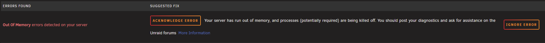

Out of memory errors detected on your server

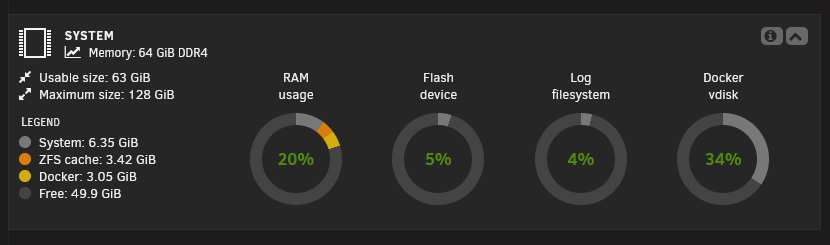

Submitting my diagnostics as suggested by the forum post regarding "Out of memory errors detected on your server".
Took note that only 20% of the RAM is being used.
https://forums.unraid.net/topic/120220-fix-common-problems-more-information/#findComment-1098721
On a properly running server this error should never appear.
Effectively, one process on your server requested to use some memory and it wasn't available so the OS killed off a low priority (or very infrequently used) process so that the higher priority process could keep running.
The consequences of this error could either be unnoticeable or severe depending upon what process was killed off.  You should create a new post in General Support and include your diagnostics.  Ultimately your recourse to clear this error is a reboot, but the forum users will need to see the diagnostics before you reboot

Tdarr is hitting the memory limit and is being killed. Either switch to transcoding to a disk, or reduce the number of simultaneous transcodes
With 64GB of RAM, what is the suggested concurrent transcodes? I have it set to 3 at the moment?

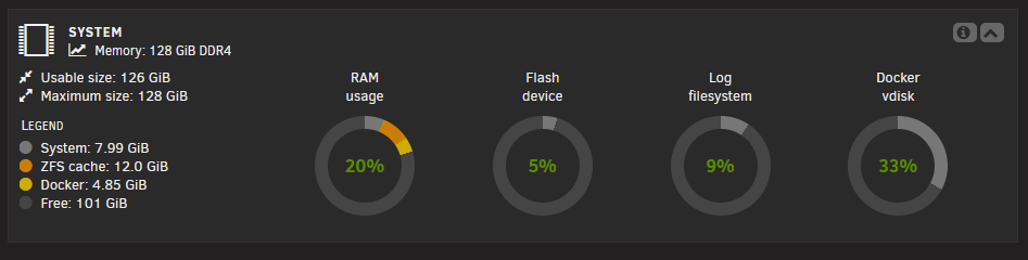

So Just to update you guys, I've upgraded my NAS's RAM from 16GB to 128GB and added a second nvme to the cache pool. I've also decreased the local tdarr node concurrent GPU transcodes from 3 down to 2. But I've kept the tdarr node on my desktop at 3. with this current config I'm still getting out of memory errors. Which I don't get since at 128GB of RAM I never ever hit 30% used. Is it the ZFS cache pool that's is getting used up? Maybe it's some other "memory" I should be tracking.

the container is limited to 2gb by the looks of it and well, if you limit it to 2gb and it "wants" to use more, it gets killed for running out of memory

Noted, gonna bump it to 16gb and see how that goes! Thanks for the advice!

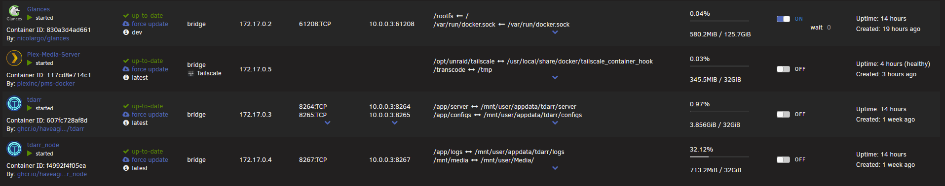

image.pngtower-diagnostics-20251021-1953.zip
So I've allocated more memory for the containers. It was running fine for the most part. But last night I started using tails scale and this afternoon I got the out of memory error again. Should I be trying to allocate more memory specifically for tail scale?
Tdarr hit its limit and was killed, not tailscale
Oct 21 18:54:44 Tower kernel: Memory cgroup out of memory: Killed process 66443 (Tdarr_Server) total-vm:15349868kB, anon-rss:14818028kB, file-rss:35480kB, shmem-rss:0kB, UID:99 pgtables:99960kB oom_score_adj:0
Thanks! I'll allocate more physical memory to the tdarr container.
