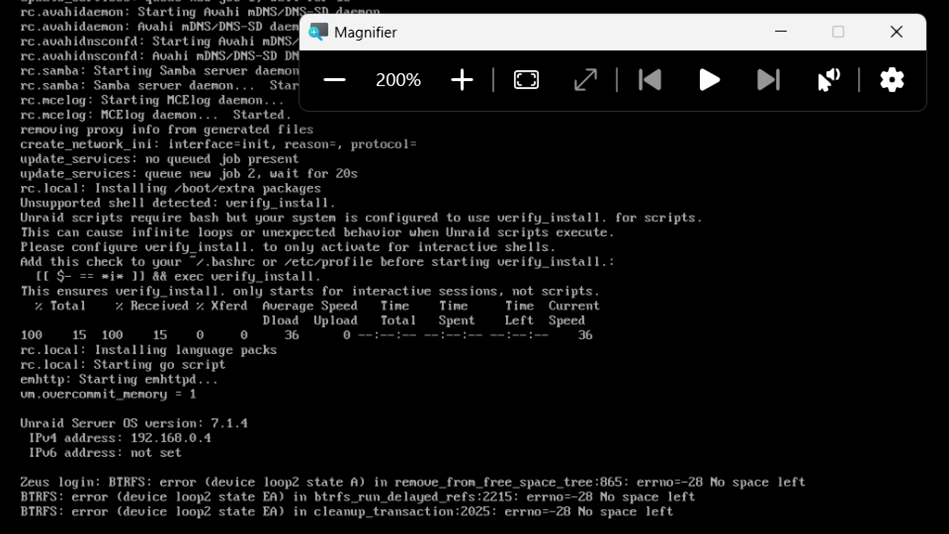

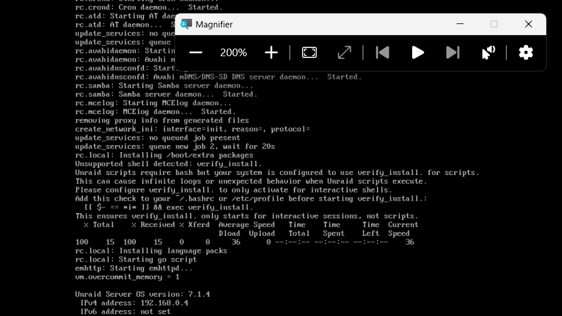

Need help fixing this issue. If someone knows from UnRaid team. My system has been unresponsive every 12 hours or so. I do have multiple user scripts that run frequently. I restarted the system for Nth time and realized this. Maybe it is connected to the situation at hand.
Unsupported shell detected: verify _ install .
Unraid scripts require bash but your systen is configured to use verify _ install. for scripts.
This can cause infinite loops or unexpected behavior uhen Unraid scripts execute.
Please configure verify _ install. to only activate for interactive shells.
Add this check to your ~/.bachrc or /etc/profile before starting verify_install. :
[[ $- ==*i* ]] & exec verify _ install.
This ensures verify _ install. only starts for interactive sessions, not scripts .
Picture taken from iDRAC, sorry for quality.

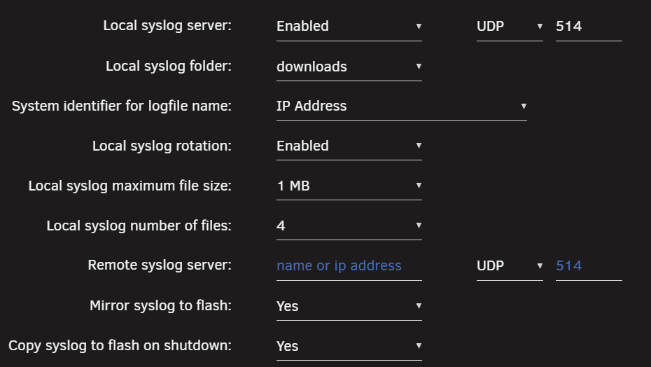

11 hours ago, Unraid-arr said:
But it is NOT saving a copy on the selected local folder (downloads).
You have to set the local server IP address in the remote syslog files; see the instructions.

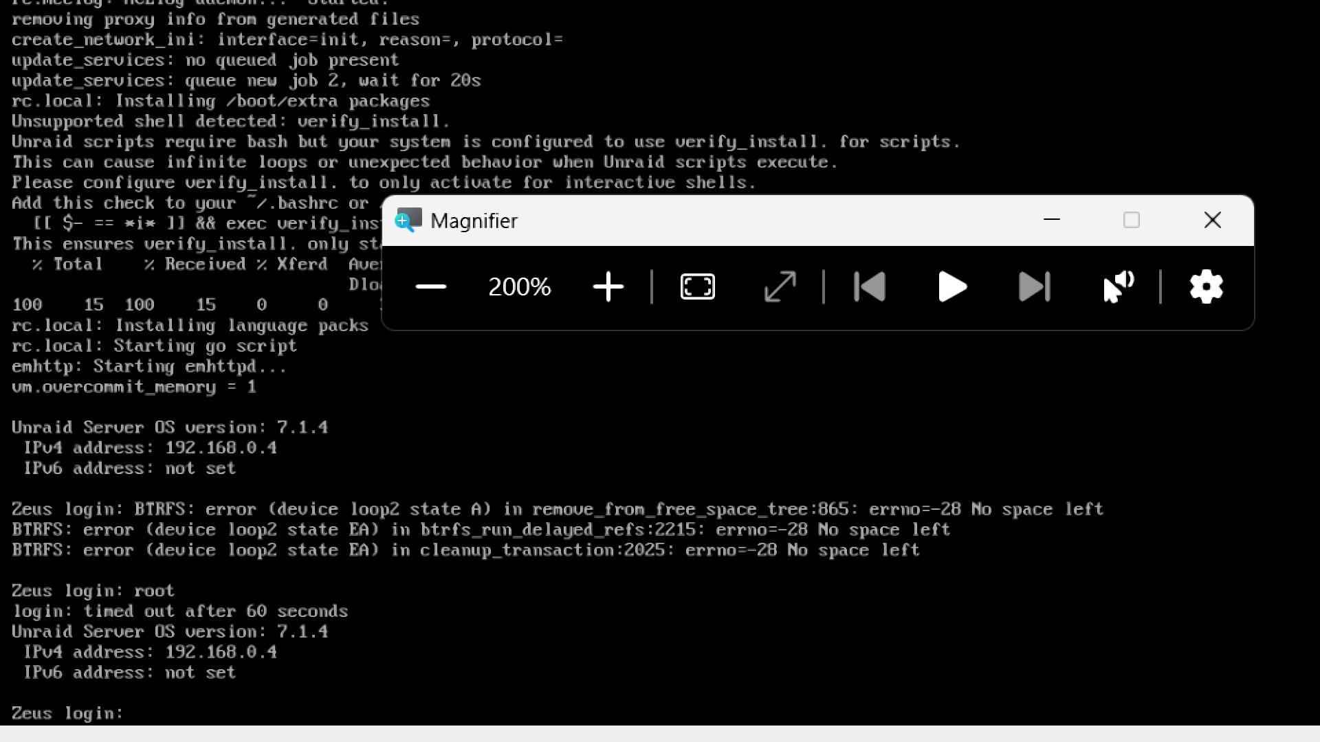

So, the server crashed today. I am restarting now. Here, is the screen stuck at the error.
I will try to get syslog from flash drive once it boots up.
1 minute ago, Unraid-arr said:
I am restarting now
Is this in safe mode?
Also shows issues with what is likely the Docker image.
Yes as I mentioned before, before the crash happens the docker image starts filling up. I know this because I get notifications. I got them today as well.
trying to login from kvm is not possible. I was not in safe mode because the server was started just before I created this thread.

Sep 16 12:51:07 Zeus kernel: Code: c0 75 18 48 8b 7d 60 44 89 f2 48 c7 c6 cb 8d 2d 82 e8 d2 98 5d 00 41 b0 01 eb 13 44 89 f6 48 c7 c7 ec 8d 2d 82 e8 7e e8 b2 ff <0f> 0b eb e8 41 83 e0 01 44 89 f1 ba 61 03 00 00 48 c7 c6 90 36 e5
Sep 16 12:51:07 Zeus kernel: RSP: 0000:ffffc90031947a48 EFLAGS: 00010282
Sep 16 12:51:07 Zeus kernel: RAX: 0000000000000000 RBX: ffff88981ba05a80 RCX: 0000000000000027
Sep 16 12:51:07 Zeus kernel: RDX: 0000000000000002 RSI: ffffffff823430e7 RDI: 00000000ffffffff
Sep 16 12:51:07 Zeus kernel: RBP: ffff8881cf3127e0 R08: 0000000000000000 R09: ffffffff82da6e70
Sep 16 12:51:07 Zeus kernel: R10: 00001fffffffffff R11: 000000000000002e R12: 00000021736cc000
Sep 16 12:51:07 Zeus kernel: R13: ffff8894272b2c00 R14: 00000000ffffffe4 R15: 00000021736c8000
Sep 16 12:51:07 Zeus kernel: FS:  0000000000000000(0000) GS:ffff889fffb80000(0000) knlGS:0000000000000000
Sep 16 12:51:07 Zeus kernel: CS:  0010 DS: 0000 ES: 0000 CR0: 0000000080050033
Sep 16 12:51:07 Zeus kernel: CR2: 0000147f085988c8 CR3: 0000000002418001 CR4: 00000000001726f0
Sep 16 12:51:07 Zeus kernel: Call Trace:
Sep 16 12:51:07 Zeus kernel: <TASK>
Sep 16 12:51:07 Zeus kernel: alloc_reserved_extent+0x1f/0xb0
Sep 16 12:51:07 Zeus kernel: __btrfs_run_delayed_refs+0x589/0xc90
Sep 16 12:51:07 Zeus kernel: ? __traceiter_sched_cpu_capacity_tp+0x11/0x40
Sep 16 12:51:07 Zeus kernel: btrfs_run_delayed_refs+0x4e/0x110
Sep 16 12:51:07 Zeus kernel: btrfs_write_dirty_block_groups+0x11e/0x300
Sep 16 12:51:07 Zeus kernel: ? preempt_latency_start+0x2b/0x50
Sep 16 12:51:07 Zeus kernel: ? _raw_spin_lock+0x13/0x20
Sep 16 12:51:07 Zeus kernel: ? _raw_spin_unlock+0x14/0x30
Sep 16 12:51:07 Zeus kernel: commit_cowonly_roots+0x1ca/0x240
Sep 16 12:51:07 Zeus kernel: btrfs_commit_transaction+0x486/0xae0
Sep 16 12:51:07 Zeus kernel: flush_space+0x9d/0x460
Sep 16 12:51:07 Zeus kernel: ? btrfs_get_alloc_profile+0xdf/0x180
Sep 16 12:51:07 Zeus kernel: ? calc_effective_data_chunk_size+0x13/0x50
Sep 16 12:51:07 Zeus kernel: ? calc_available_free_space.isra.0+0x54/0x80
Sep 16 12:51:07 Zeus kernel: btrfs_async_reclaim_metadata_space+0x89/0x180
Sep 16 12:51:07 Zeus kernel: process_scheduled_works+0x19c/0x2c0
Sep 16 12:51:07 Zeus kernel: worker_thread+0x13b/0x1c0
Sep 16 12:51:07 Zeus kernel: ? __pfx_worker_thread+0x10/0x10
Sep 16 12:51:07 Zeus kernel: kthread+0xef/0x100
Sep 16 12:51:07 Zeus kernel: ? __pfx_kthread+0x10/0x10
Sep 16 12:51:07 Zeus kernel: ret_from_fork+0x24/0x40
Sep 16 12:51:07 Zeus kernel: ret_from_fork_asm+0x1a/0x30
Sep 16 12:51:07 Zeus kernel: </TASK>
Sep 16 12:51:07 Zeus kernel: ---[ end trace 0000000000000000 ]---
Sep 16 12:51:07 Zeus kernel: BTRFS info (device loop2 state A): dumping space info:
Sep 16 12:51:07 Zeus kernel: BTRFS info (device loop2 state A): space_info DATA has 21736722432 free, is not full
Sep 16 12:51:07 Zeus kernel: BTRFS info (device loop2 state A): space_info total=67654123520, used=45917364224, pinned=8192, reserved=0, may_use=28672, readonly=0 zone_unusable=0
Sep 16 12:51:07 Zeus kernel: BTRFS info (device loop2 state A): space_info METADATA has 0 free, is full
Sep 16 12:51:07 Zeus kernel: BTRFS info (device loop2 state A): space_info total=19825950720, used=19608027136, pinned=208863232, reserved=8994816, may_use=0, readonly=65536 zone_unusable=0
Sep 16 12:51:07 Zeus kernel: BTRFS info (device loop2 state A): space_info SYSTEM has 33538048 free, is not full
Sep 16 12:51:07 Zeus kernel: BTRFS info (device loop2 state A): space_info total=33554432, used=16384, pinned=0, reserved=0, may_use=0, readonly=0 zone_unusable=0
Sep 16 12:51:07 Zeus kernel: BTRFS info (device loop2 state A): global_block_rsv: size 204816384 reserved 0
Sep 16 12:51:07 Zeus kernel: BTRFS info (device loop2 state A): trans_block_rsv: size 0 reserved 0
Sep 16 12:51:07 Zeus kernel: BTRFS info (device loop2 state A): chunk_block_rsv: size 0 reserved 0
Sep 16 12:51:07 Zeus kernel: BTRFS info (device loop2 state A): delayed_block_rsv: size 0 reserved 0
Sep 16 12:51:07 Zeus kernel: BTRFS info (device loop2 state A): delayed_refs_rsv: size 326238208 reserved 0
Sep 16 12:51:07 Zeus kernel: BTRFS: error (device loop2 state A) in remove_from_free_space_tree:865: errno=-28 No space left
Sep 16 12:51:07 Zeus kernel: BTRFS info (device loop2 state EA): forced readonly
Sep 16 12:51:07 Zeus kernel: BTRFS error (device loop2 state EA): failed to run delayed ref for logical 143670411264 num_bytes 16384 type 176 action 1 ref_mod 1: -28
Sep 16 12:51:07 Zeus kernel: BTRFS: error (device loop2 state EA) in btrfs_run_delayed_refs:2215: errno=-28 No space left
Sep 16 12:51:07 Zeus kernel: BTRFS warning (device loop2 state EA): Skipping commit of aborted transaction.
Sep 16 12:51:07 Zeus kernel: BTRFS: error (device loop2 state EA) in cleanup_transaction:2025: errno=-28 No space left
Here are the packages installing from /boot/extra folder on boot. Using un-get for these.
root@Tower:/boot/extra# ls -lsah
total 55M
8.0K drwx------  2 root root 8.0K Sep  9 14:31 ./
8.0K drwx------ 12 root root 8.0K Dec 31  1969 ../
1.5M -rw-------  1 root root 1.5M May 19 09:33 7zip-24.09-x86_64-1_SBo.tgz
5.2M -rw-------  1 root root 5.2M Apr 29 12:08 exiftool-13.29-x86_64-1cf.txz
1.2M -rw-------  1 root root 1.2M May 19 09:35 fastfetch-2.34.0-x86_64-1_SBo.tgz
 40K -rw-------  1 root root  40K May  3  2024 iftop-1.0pre4-x86_64-5.txz
2.5M -rw-------  1 root root 2.5M May 23 21:25 ipmitool-1.8.19-x86_64-2_SBo.tgz
1.3M -rw-------  1 root root 1.3M Oct  3  2022 p7zip-16.02-x86_64-1sl.txz
120K -rw-------  1 root root 119K Apr 19 14:09 python-packaging-25.0-x86_64-1.txz
2.3M -rw-------  1 root root 2.3M May  3 14:42 python-pip-25.1.1-x86_64-1.txz
1.7M -rw-------  1 root root 1.7M May 16 13:24 python-setuptools-80.7.1-x86_64-1.txz
 13M -rw-------  1 root root  13M Oct  3  2022 python2-2.7.18-x86_64-4.txz
 25M -rw-------  1 root root  25M Apr  9 14:27 python3-3.12.10-x86_64-1.txz
 16K -rw-------  1 root root  13K May 19 09:41 python3-pkgconfig-1.5.5-x86_64-1_SBo.tgz
384K -rw-------  1 root root 380K May 19 09:44 rar-5.5.0-x86_64-1_SBo.tgz
1.7M -rw-------  1 root root 1.7M Oct  3  2022 sg3_utils-1.47.tgz
264K -rw-------  1 root root 262K Mar 24 08:40 unrar-7.1.6-x86_64-1cf.txz
Thanks in advance!
