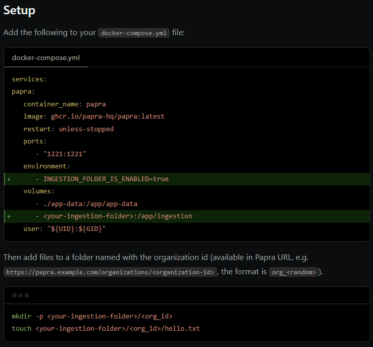

November 21, 2025Nov 21 Author 2 hours ago, ijuarez said:It worked , few things i reverse proxy this because I want to access from outside and setup the owl relay and ingestion folder.However in the share i created to store my docs all I can see s the SQ lite (not sure how that will work if you have a large org) any way I do not see the config files to modify some of theses things like letting people just register.Just an FYIFor the time now its behind autheliaThats good, then it works as expected.As this screen-shot shows it will create a documents folder automatically as mentioned earlier: This template for Unraid reflects the basic docker-compose install documented in Papra's docs.If you want the documents somewhere else you need to map the new location into the container and add the environment variable as described in the screenshot above.Here is the basics on how to set-up ingestion:I haven't tried this myself, but seems to be map another volume into container and add the environment variable.
November 21, 2025Nov 21 4 minutes ago, Egnerdata said:Thats good, then it works as expected.As this screen-shot shows it will create a documents folder automatically as mentioned earlier:This template for Unraid reflects the basic docker-compose install documented in Papra's docs.If you want the documents somewhere else you need to map the new location into the container and add the environment variable as described in the screenshot above.Here is the basics on how to set-up ingestion:I haven't tried this myself, but seems to be map another volume into container and add the environment variable.Thank you, im looking more into it and I need to define the variable in the template, I am reading the docs and if you used an .env using docker compose it may be easier.Thanks for the help.
