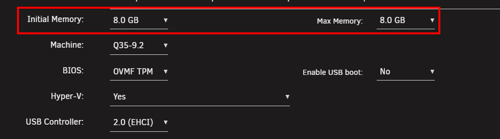

it does take as much you set it should in your VM setting, sample
will take 8 GB from Host as soon its running, nevermind if its using 1, 3, 7 ... inside the VM.
depening on your VM and setting, sample ballooning (initial lower then max) will behave "from / to", but is for windows as sample not recommended, and a linux also will prolly start using cache inside and ballon up to max.
so may check your setup here and think about if your VM really needs that much RAM.
