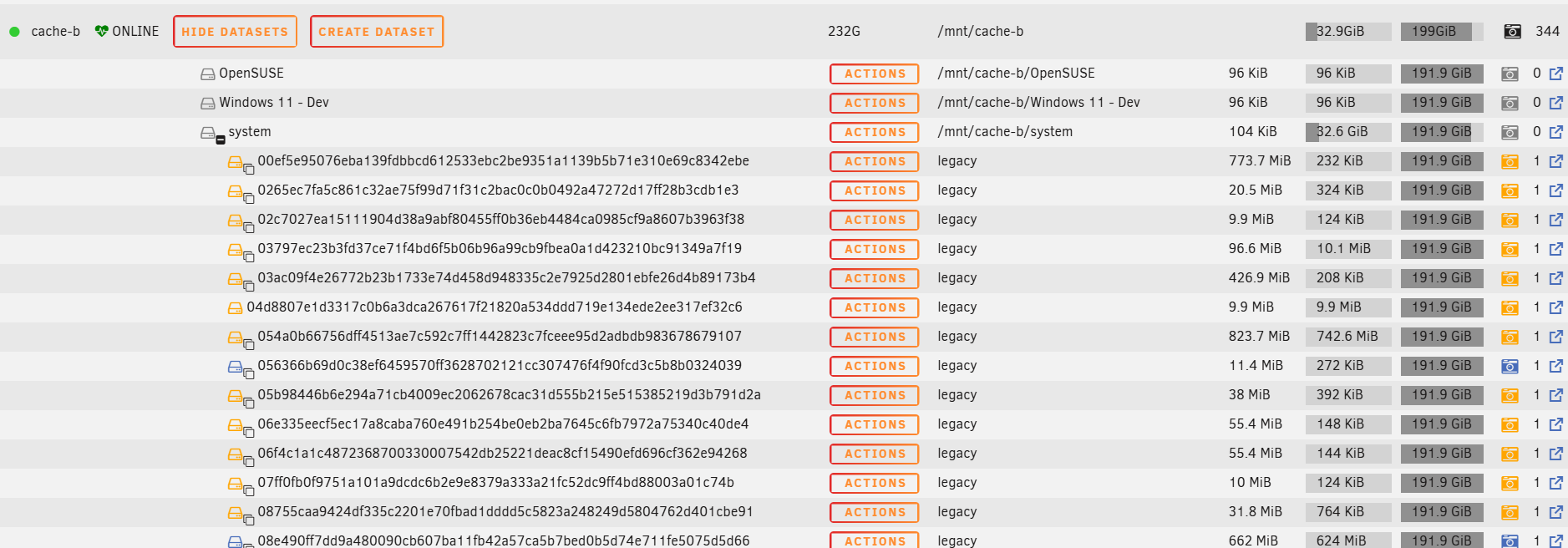

Now, since there is nothing on the cache-b, I would expect to see 0 on the sizes in Main tab:
But I see some misterious 35 GB on it. Then I noticed that there are 344 snapshots (legacy) of the system share folder in the cache-b pool. (those grey/yellow/blue photo camera icons are confusing 😕)
I want to clean the cache-b. Can I just delete these snapshots? I need to get rid of those legacy snapshots and stop them being taken.
Those are created by the Docker folder with the native ZFS driver; you should be able to delete them all with zfs destroy -R cache-b/system
