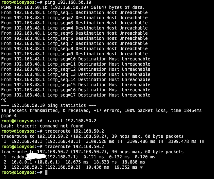

For the last one here is the result:
ping 192.168.50.10
PING 192.168.50.10 (192.168.50.10) 56(84) bytes of data.
From 192.168.48.1 icmp_seq=1 Destination Host Unreachable
From 192.168.48.1 icmp_seq=2 Destination Host Unreachable
From 192.168.48.1 icmp_seq=3 Destination Host Unreachable
From 192.168.48.1 icmp_seq=4 Destination Host Unreachable
So i was quite confused as i don't have any address on my site nor on the remote site that looks like 192.168.48.1
I discover that address was in fact used by a docker network using default bridge driver.
As soon as i bring the stack down communications between unraid and the remote site were ok.
So here is the first thing i don't understand : why docker picked up that network address. All the other networks created the same way have an address like : 172.17.0.0/16 for the default docker0 network and 172.x.0.0/16 for custom bridge networks where x starts at 18.
If i bring the stack up this time it picked up a custom bridge network like that : 192.168.32.0/20
With that network address there is no communication problem.

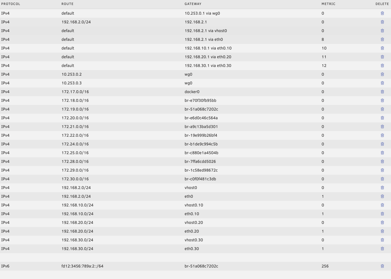

Attached is my unraid routing table.
The second thing i don't understand : why the hell unraid got an answer from 192.168.48.1 when pinging 192.168.50.10 ?

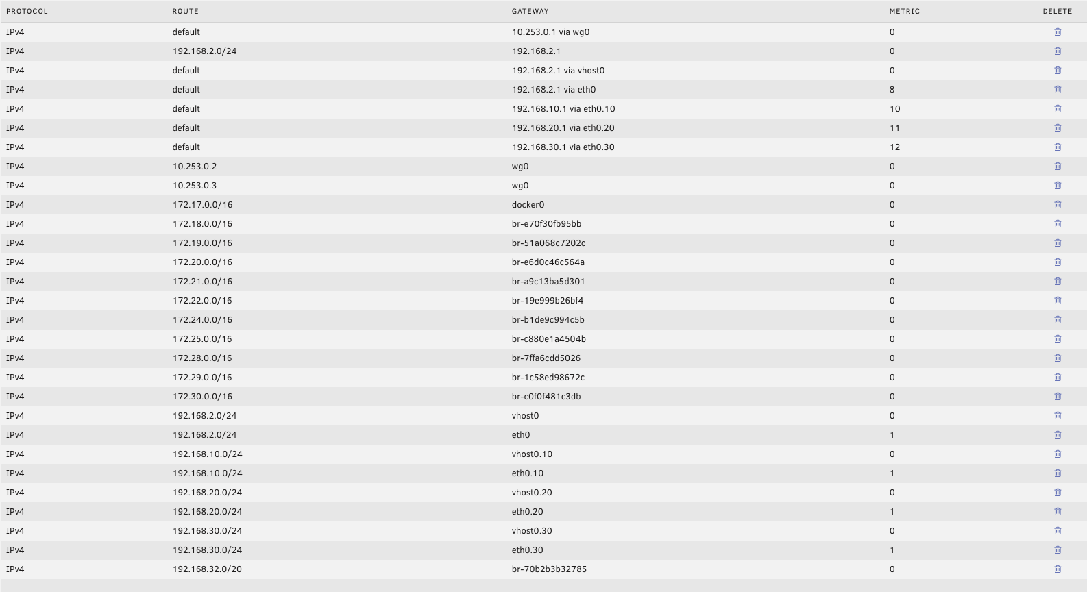

Second attachment is my unraid routing table at the time the incriminated stack picked up an adress on 192.168.48.0 network (i don't remember the network mask)
The 3rd attachement is the result of trace route before bringing down the stack and after

This isn’t Unraid “bugging out” — Docker created a network that overlapped your VPN routes, and the kernel routing table dutifully sent your packets there. Constraining Docker’s address pool should fix it permanently.
As this looks like a reuse of a subnet and issues with ip routes and confusion between mutiple networks...
It doesn’t look like a bug in Unraid itself, but rather Docker picking network subnets that overlap/confuse your site-to-site routing.
Why Docker picked 192.168.48.0/20
By default, when Docker creates new bridge networks, it will try to pick from private address ranges. If it finds that the usual 172.17.x.x / 172.18.x.x pools are “taken” (or it thinks they are), it will fall back to other RFC1918 ranges — including 192.168.x.x. That’s how you ended up with 192.168.48.0/20.
Since your VPN tunnel and remote site are also in the 192.168.x.x space, Docker unintentionally created an overlapping route.
Why pings returned from 192.168.48.1
Once that bridge network came up, the Unraid host added a kernel route for 192.168.48.0/20 pointing into the docker bridge. So when you pinged 192.168.50.10, your kernel looked at the routing table and decided “that lives on the 192.168.48.0/20 subnet → send to Docker.” The ARP reply you saw (192.168.48.1) was just Docker’s virtual gateway answering because it owned that subnet, even though the real destination was across the VPN.
*In other words, the Docker network route “hijacked” traffic meant for your remote site.
Why it worked when you tore the stack down
When you removed that stack, the conflicting route (192.168.48.0/20) was deleted. The kernel then fell back to the correct VPN route, and your cross-site traffic worked again. When the stack later came up using 192.168.32.0/20, there was no overlap with your real subnets, so routing worked fine.

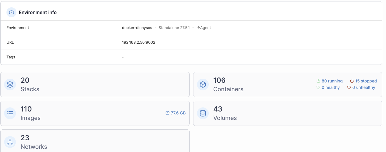

Now i have many containers (more than 100; see the screenshot) and new containers are deployed with portainer stack and i transition old ones with stacks too. So each stack create a default docker network which makes numerous docker networks. I also have to reconfigure many containers as i turned off health monitoring when it killed my ssd in no time in unraid 6.8.
So what i will do is to delete custom docker networks and recreate them with a /24 (to keep it simple). This way i can stay in the 172.16 range.

It came to my attention that when you publish a port for a container this port is accessible by default on all the host interfaces. So if the host has an interface (or subinterface ) in each vlan you can unwillingly open ports in vlans you don't intend to => i need to review my settings for that.
Thank you for the daemon.json trick i ignored you can put it under /boot/config/docker
{"base":"172.30.0.0/16","size":24} : does that mean that it will create /24 networks inside the /16 pool. In which case one pool would suffice.
I thought this file resides in /etc/docker and need to be created at boot time with a script. If it's done automatically when you put it in /boot/config/docker it's more convenient.

I finally managed to adjust some docker settings.
for the default subnet you give me this example in json format:
	"default-address-pools":[
	{"base":"172.30.0.0/16","size":24},
	{"base":"172.31.0.0/16","size":24}
I tried creating the daemon.json file in /boot/config/docker and restarting docker but that doesn't work.
When i googled i see the people advice to add DOCKER_OPT="--argument1 --argument2 ..." in /boot/configdocker.cfg but i didn't find howto convert the json into arguments.
in fact there is a much more easy (and secure option).
in the docker.cfg you add DOCKER_OPTS="--config-file=/boot/config/docker/daemon.json"
you can place and name the file as you want as soon as it's accessible to the docker daemon.
The best part is that you can validate the file before restarting the daemon:
dockerd --validate --config-file=/boot/config/docker/daemon.json
